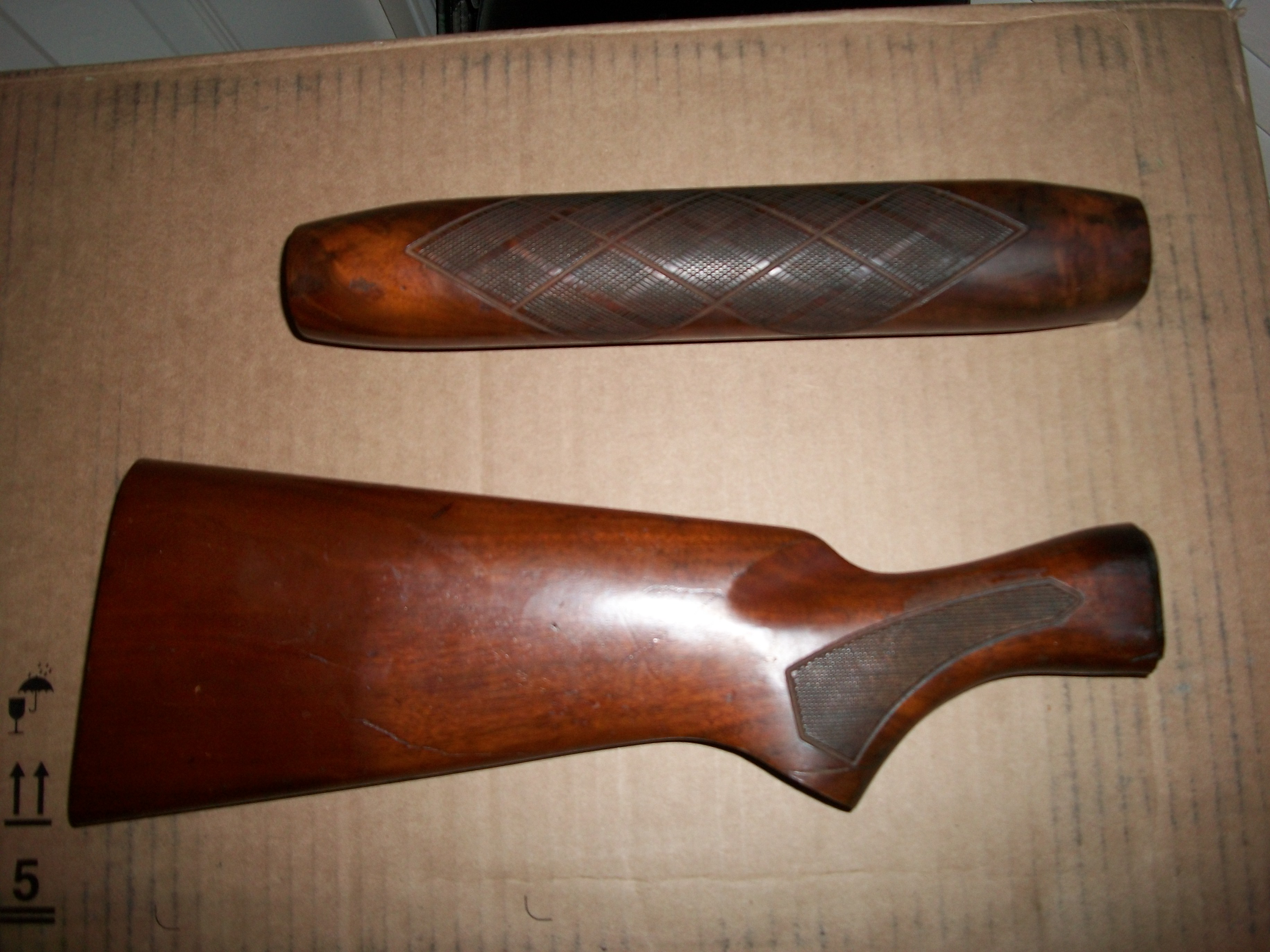

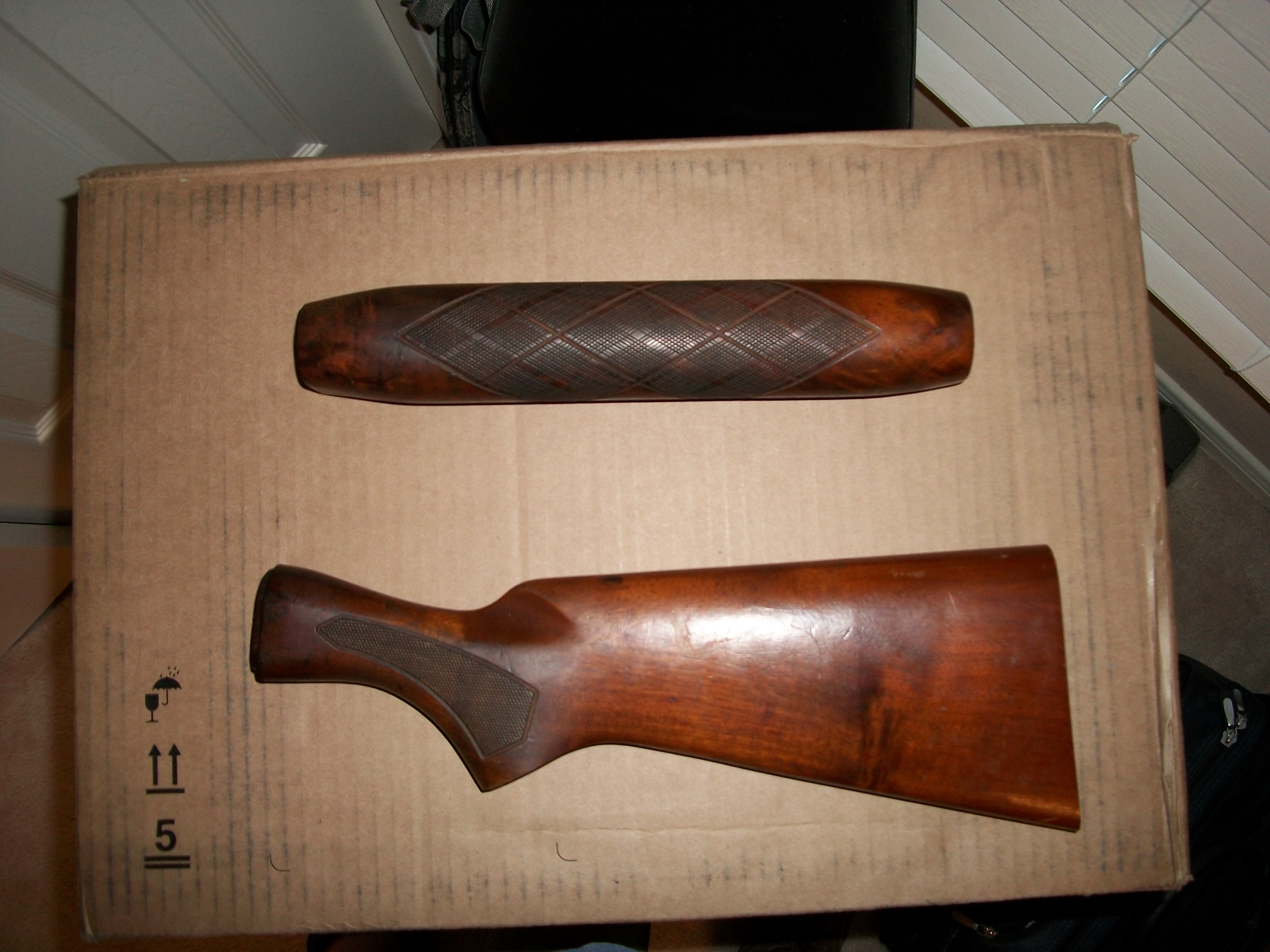

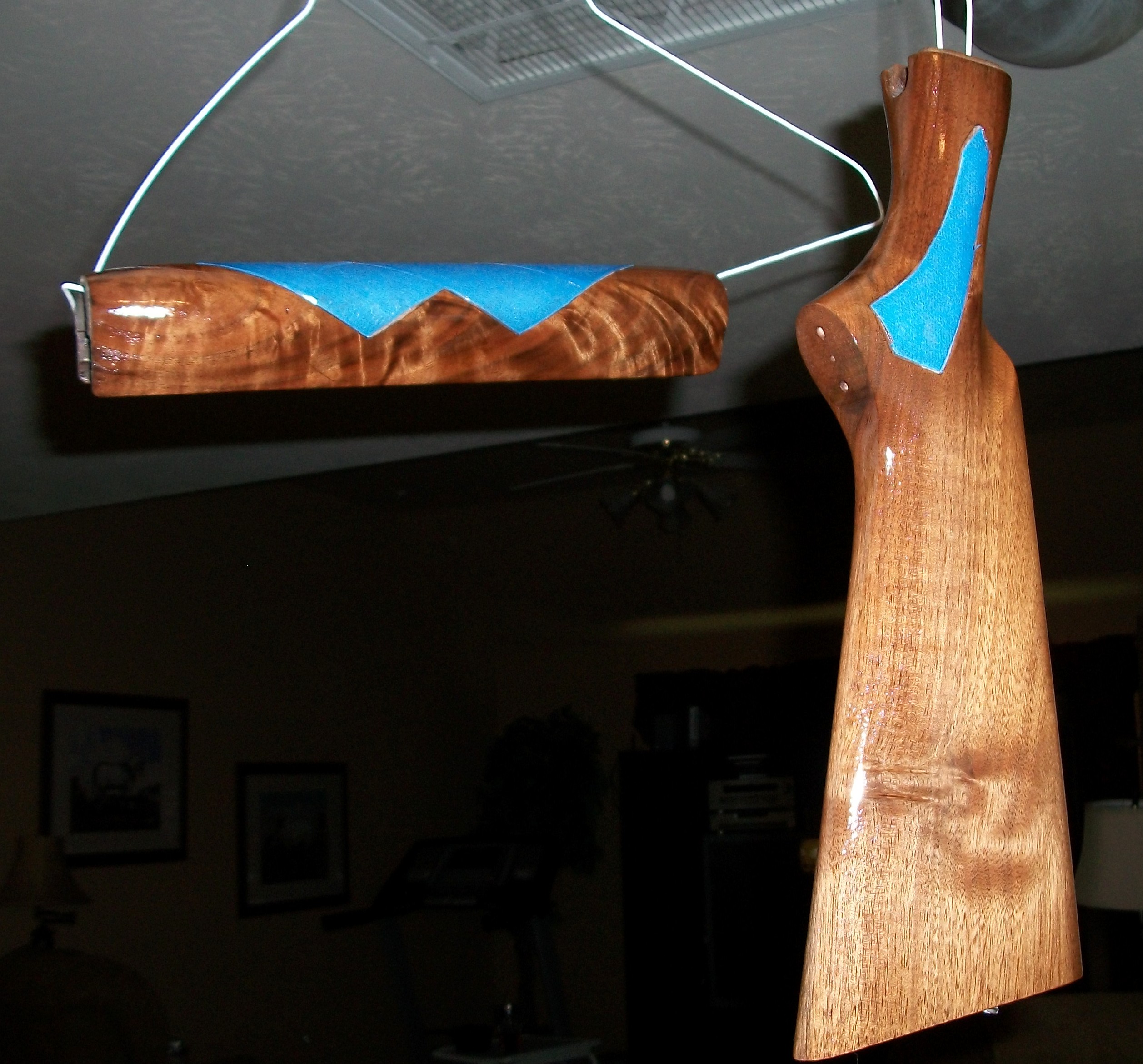

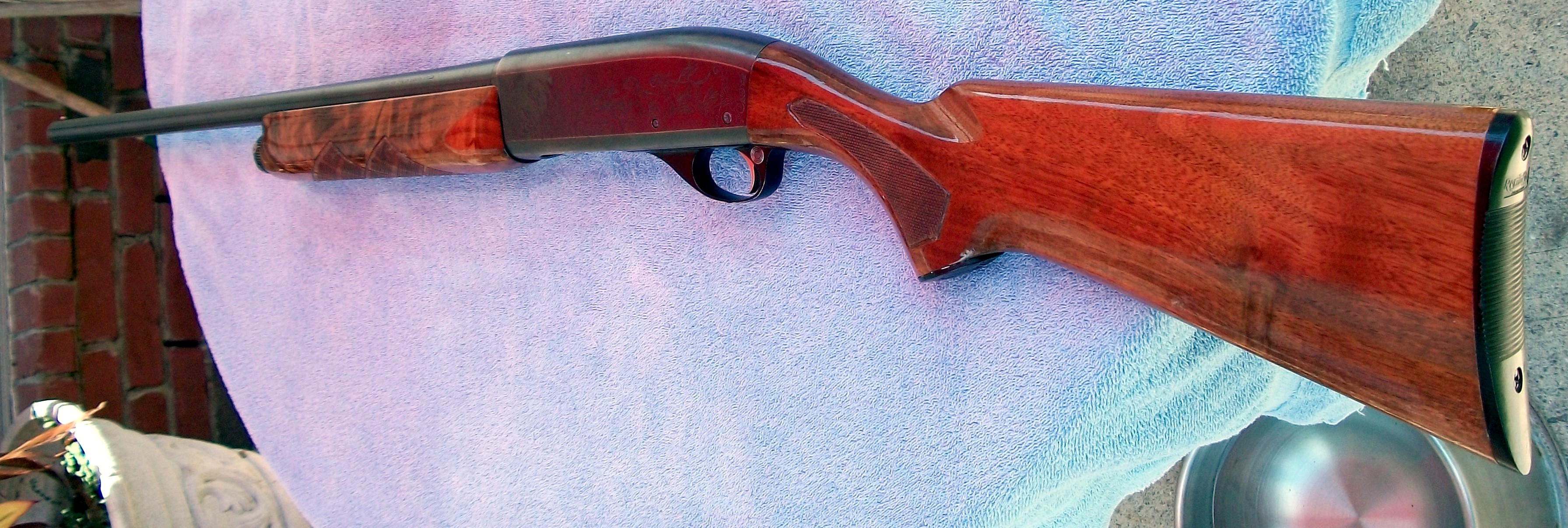

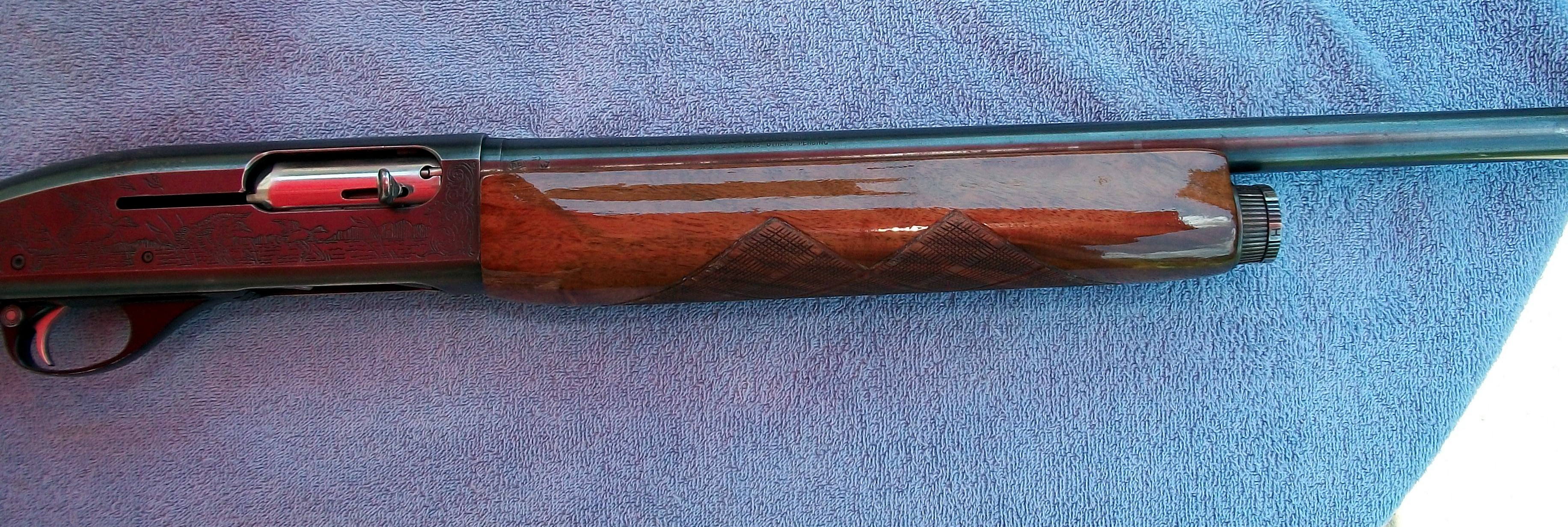

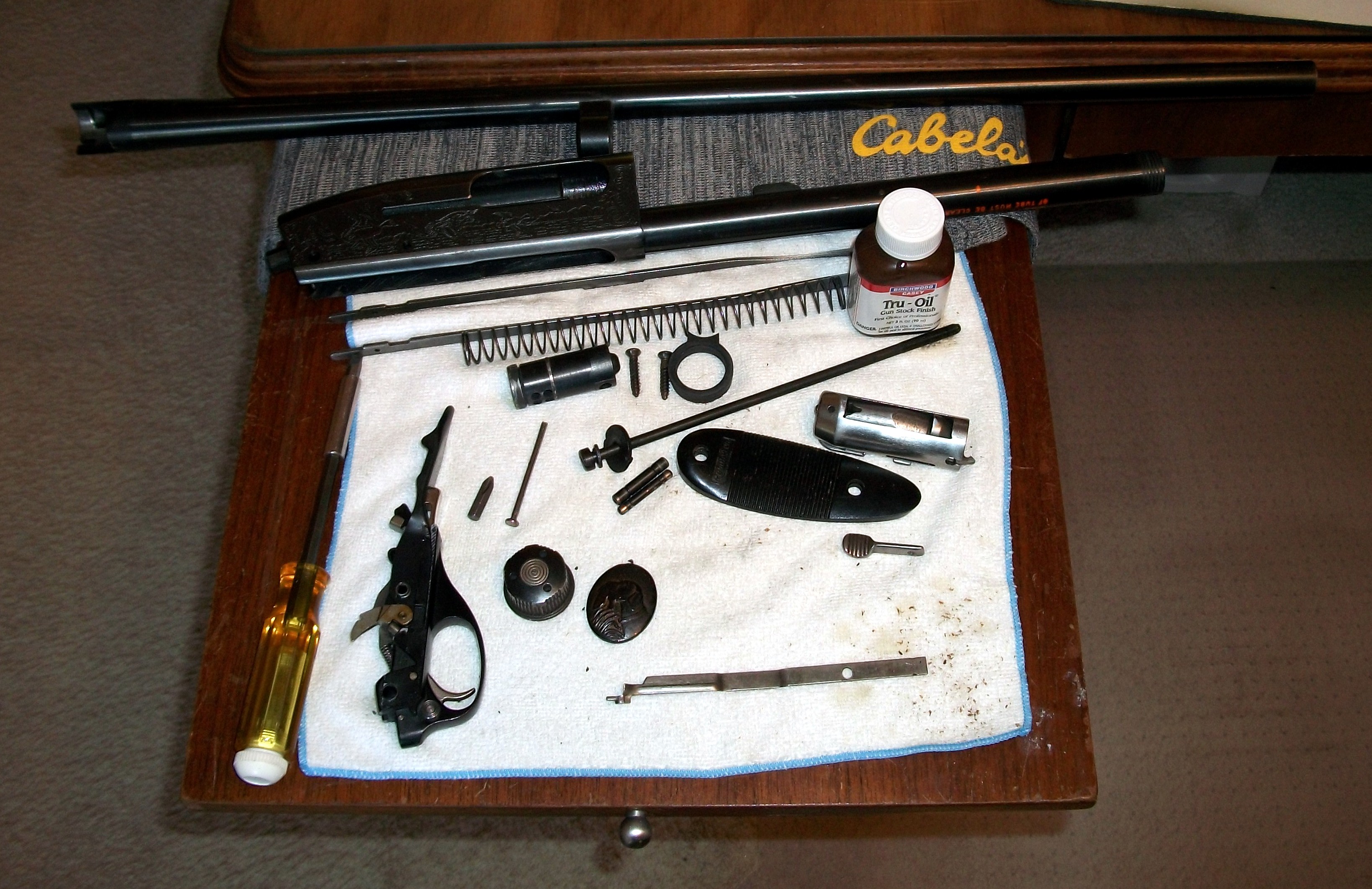

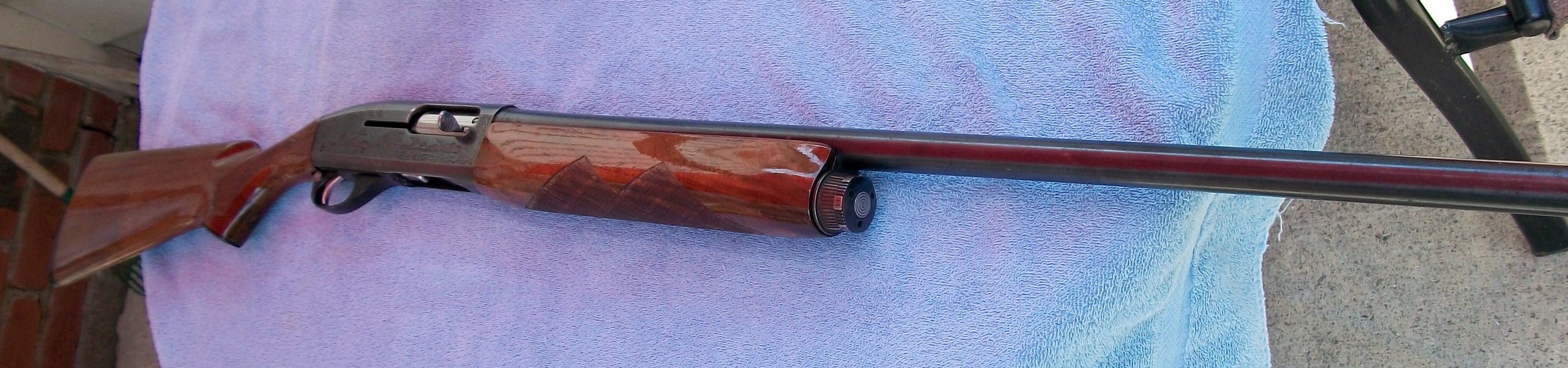

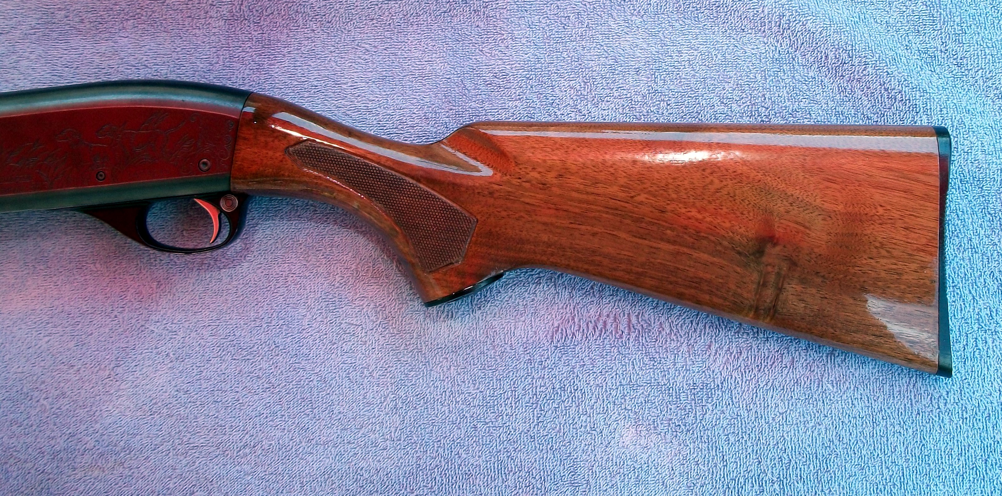

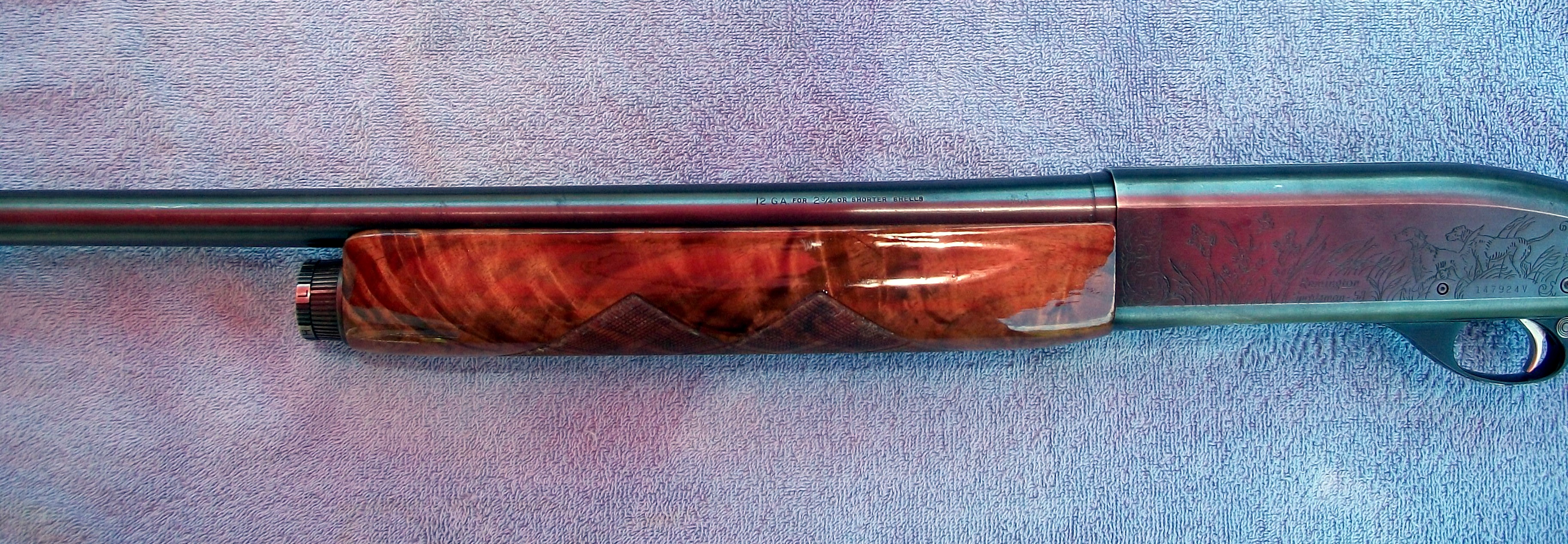

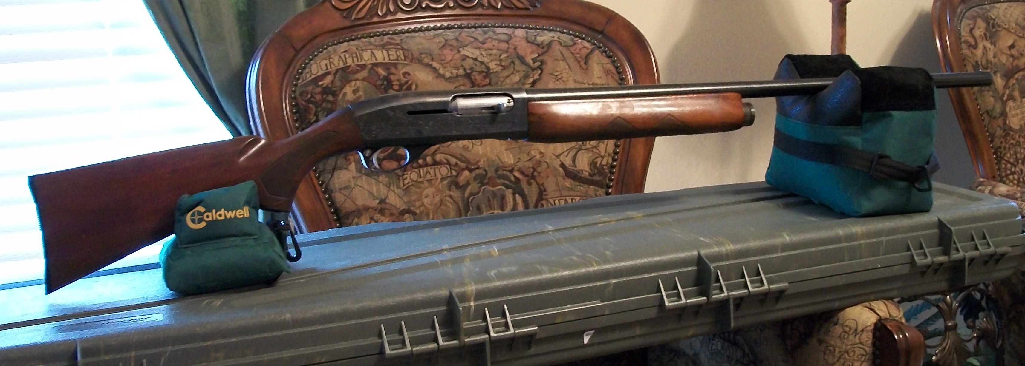

The wood on my Remington Model 58 Sportsman was in pretty bad shape - the varnish / shellac was all bubbled and peeling / flaking off. Lots of dents, dings, and scratches. I inherited it from my Uncle...according to the barrel code, the gun was manufactured in January 1958. I decided to re-do the wood last week - and took some before, during, and after pics. I stripped it with Citrustrip and then sanded and used an iron to steam out some of the dents. I then used Tru-oil thinned with mineral spirits for the finish. Used brass wool in between coats. It didn't turn out perfect, but looks better. When it dries for a few more days I will polish it then wax it.
The Model 58 is the grand-daddy of the Remington 1100. I am supposed to go shoot Sporting Clays with some of my old buddies next week....this one will be going along.

Boy that's some pretty grain on the left side of the forend! It all looks great. Treefarmer

Nice job UNK!

There was some good wood hiding under all that wear. Good job bringing it back to life. I can't tell if that's cut checkering or pressed checkering. The 1100 I had back in the '70s was pressed.

Thanks guys. It was nice to let that walnut show through again.
Jerry, I'm no expert, but I think it has cut checkering, as best I can tell. I am not sure when Remington started with the impressed checkering (maybe early 1960s?)

I should have looked closer at those bottom pictures showing the finished project. They make it quite obvious it's cut checkering.
That's a great gun and a great job of refinishing the wood.

I did have to do a little work on this one. The last time I took it dove hunting (back in the early 90s) it had jammed a lot, and the bolt wouldn't stay open after the last shot....so I stuck it in the safe and haven't messed with it since. I got it out a few months ago and decided to get it up and running again. I dismantled it and cleaned it really good (it was filthy - had probably not been cleaned since the 1960s
. I also did some internet research and figured out a tab on the carrier assy was broken off (the tab keeps the bolt open after the last shot). I ordered a new carrier assy from Numrich, and replaced it - then took it to the gun range last month and she ran like a sewing machine.
The springs in mine seem to be in good shape - you can see the action spring along with the gas piston in one of my pics - the one with the parts spread out on the white cloth. Since it's such an old gun - probably not a bad idea for me to pick up a few spare parts, though.

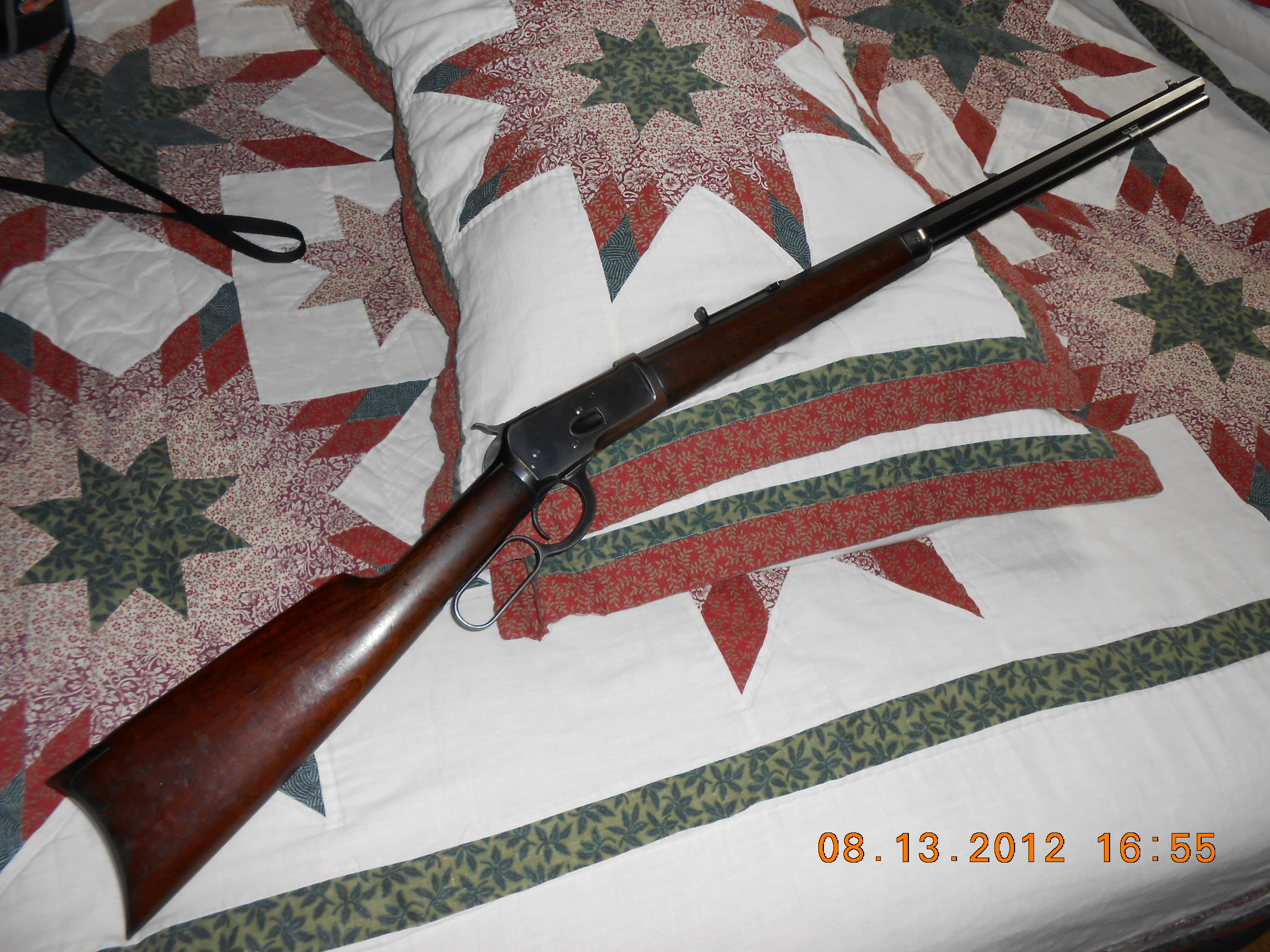

Drug this ol' gal out of storage to show some folks. Thought some of you folks would enjoy seeing her. She was born in 1911 and was sent back to the Winchester factory in the 1950's to be redone. She's Winchester 1892, 32-20, 24" octagon bbl. Treefarmer

I love lever actions.
...That is a beauty of a Winchester.

Unk, that style of checkering was used on some of the last years (1948-1949) Remington model 31 pump action shotguns (trap and skeet models) and also on early production years (1950, 51, & ect.) Remington model 870's. Your Remington 58 barrel will fit and work on a Remington model 870 pump action shotgun with no fitting or gunsmithing required. I've also seen the model 870 pump action shotgun barrels used on the model 58 after they had a gas hole drilled in the barrel. The oldest relative of the Remington model 1100 is the Remington model 11, even though it was a recoil operated shotgun. The Remington model 11 is nothing more than a Browning (FN) Auto-5 semi-automatic shotgun copy. Some parts will inter-change between the Remington model 11 and the Browning Auto-5 but a lot of them wont. Thats a good looking job you did with the wood on your Remington model 58.
They are nice shotguns and good shooters to boot. Congrats on having a nice shotgun.

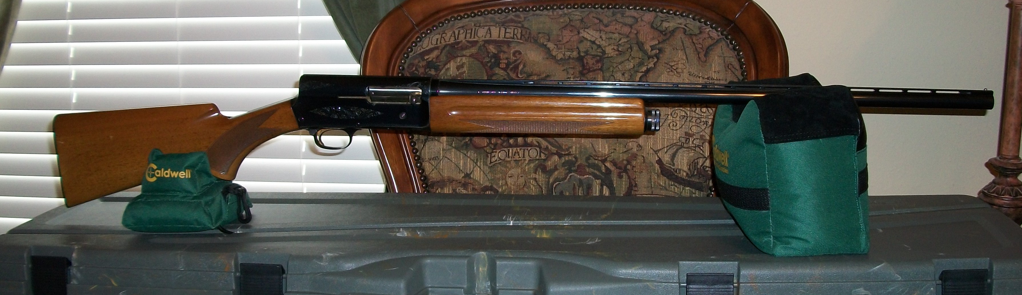

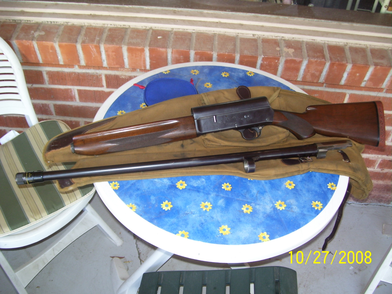

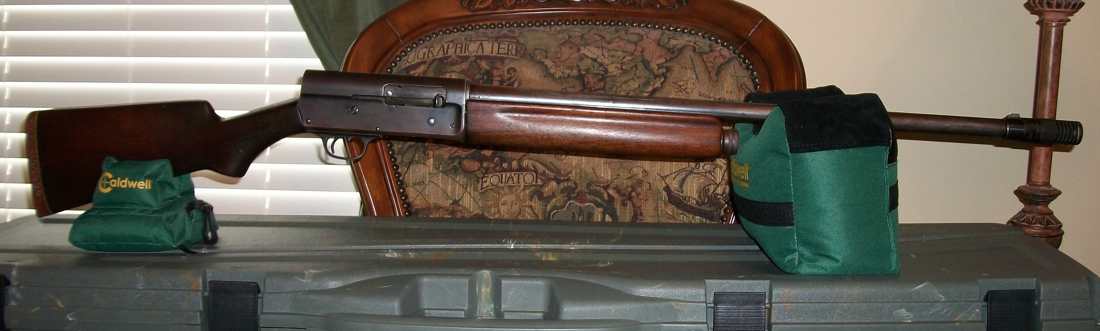

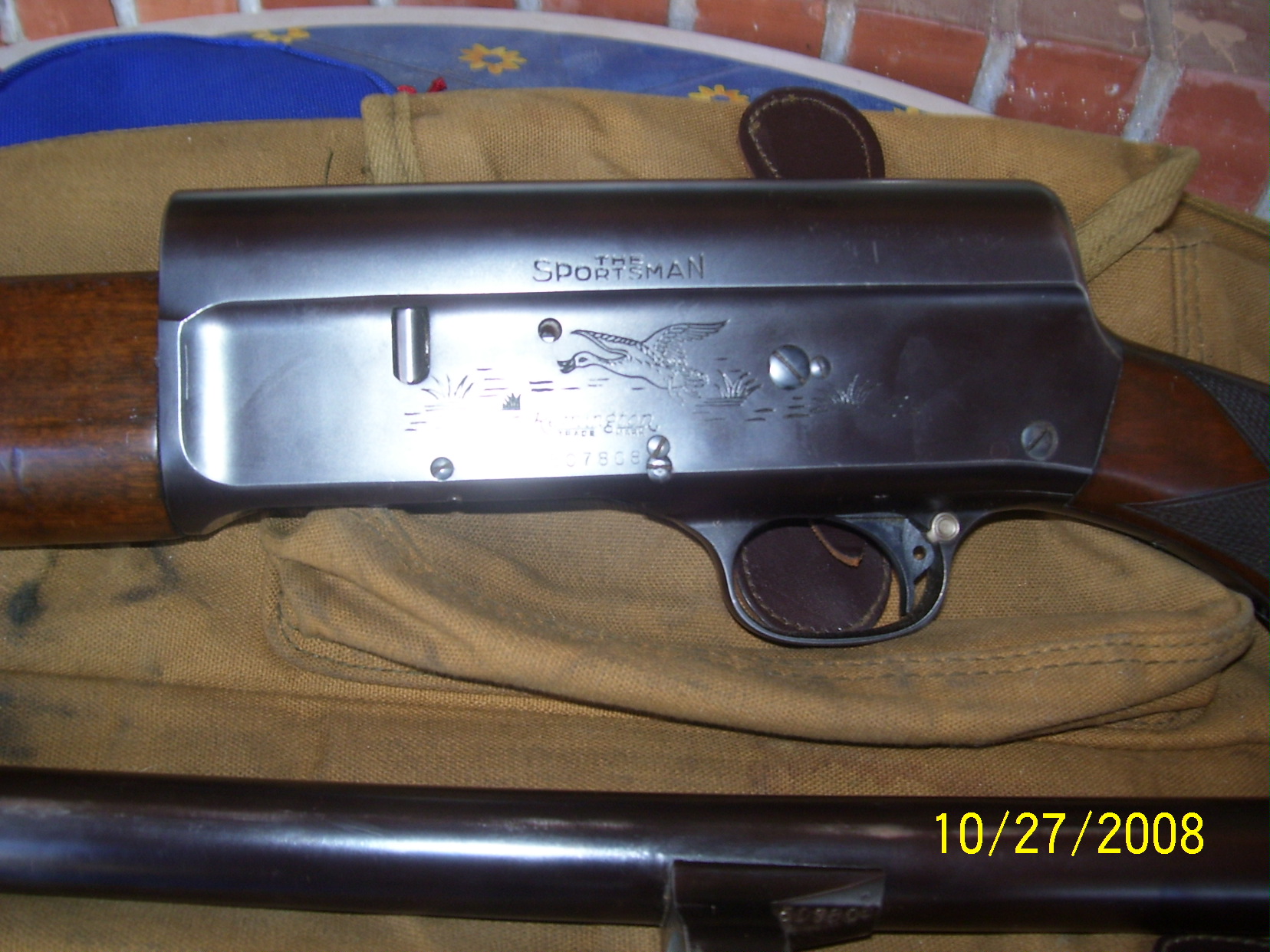

Aimus...you talking about one of these.The Remington model 11
Heres one I had a few years back...

Nice Winchester treefarmer. I have a good friend that lost a Winchester 1892 in 32-20 with the octagon barrel due to a drug addict son that stole it and several other of his firearms and traded them for drugs. The only firearm he has found from that stolen bunch was an old S&W .38 Special M&P model. The police didn't find it. He got a phone call from a guy that had heard about his stolen firearms and asked him if one was a S&W revolver. He read the serial number to my friend over the phone and it was a match to his S&W .38 M&P. Cost him $200 to get that revolver back. My friend's son has now moved on to breaking in and stealing from other people now. I figure he's going to end up in a body bag from going in the wrong house when someone is home and end up getting shot. It's a shame what drugs do to people. Stealing is bad enough but I mean to steal from your own Father? Anyone that does that is a no good useless person in my book.

Yep, thats one of them Johnny. You hit the nail on the head. They are great shotguns. Only fault I have with the Remington model 11 and the Browning A-5 is they are bad to crack the forends from the recoil operated barrel. Savage also made a Browning A-5 copy, I think it was called the model 720.

Yeah...I heard they shot really well....heard that is
I sold this one before I had the chance to ever shoot it.
