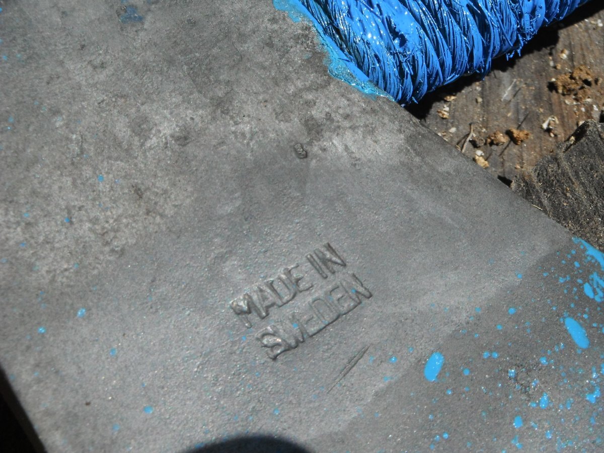

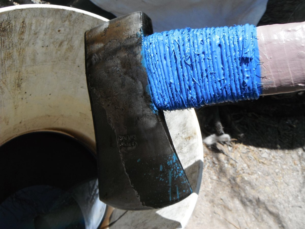

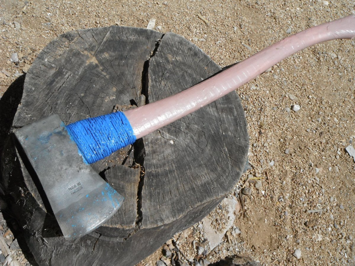

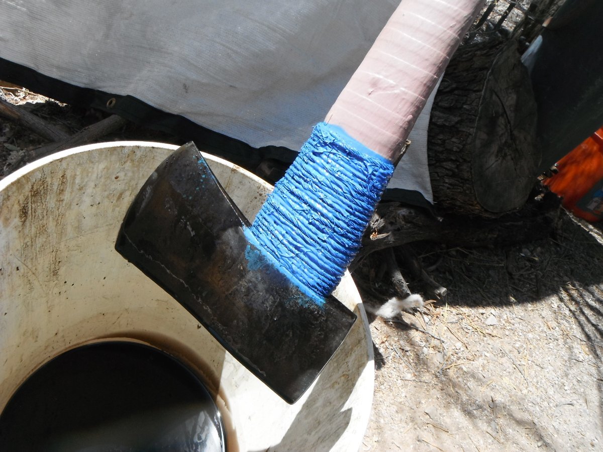

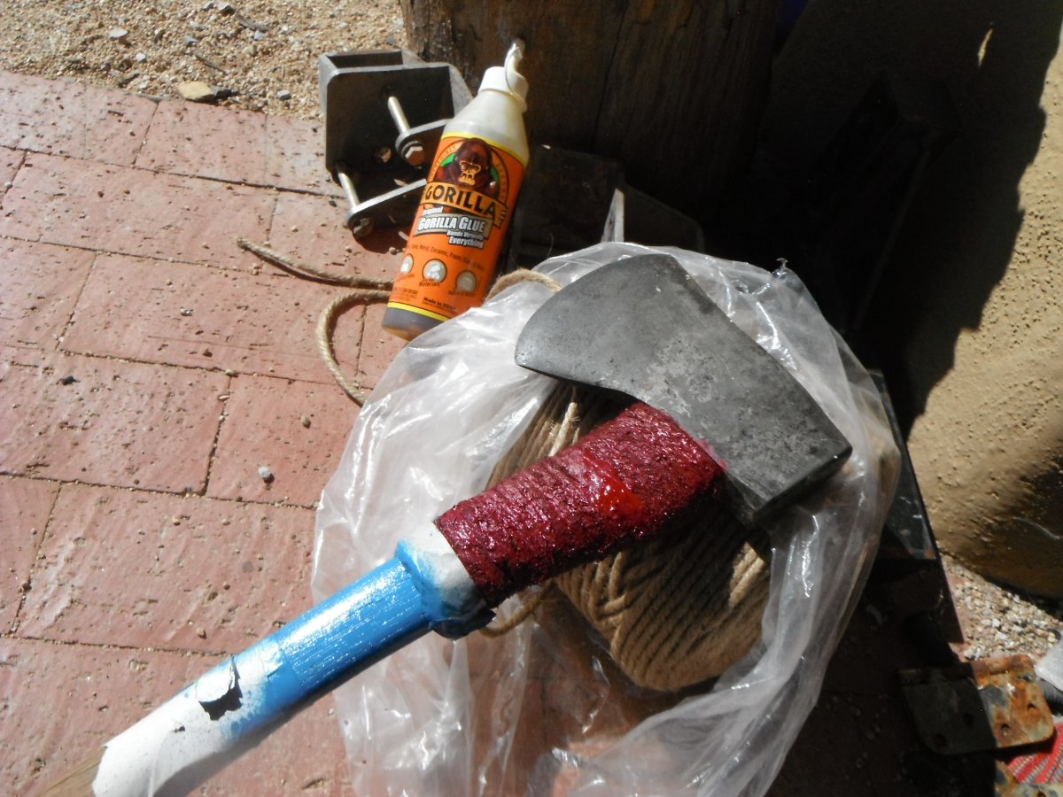

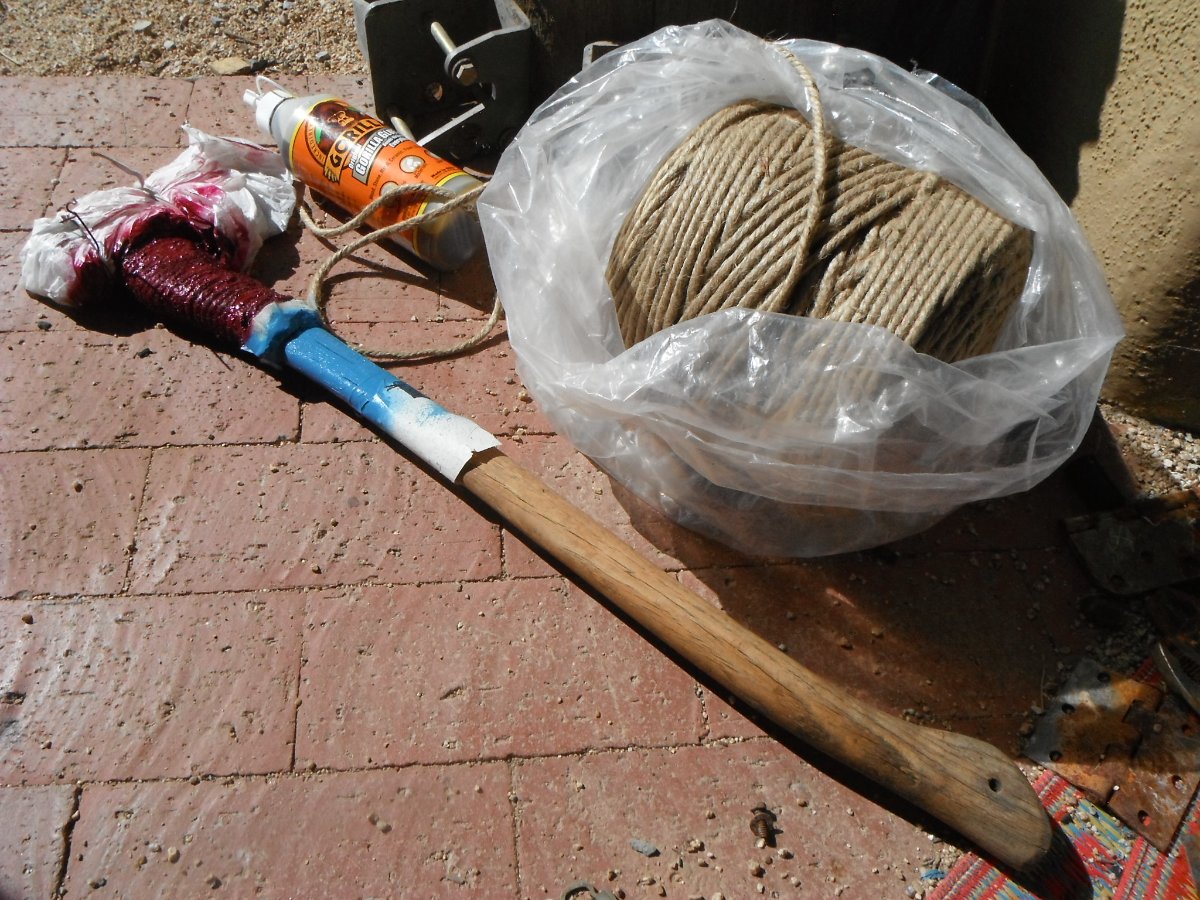

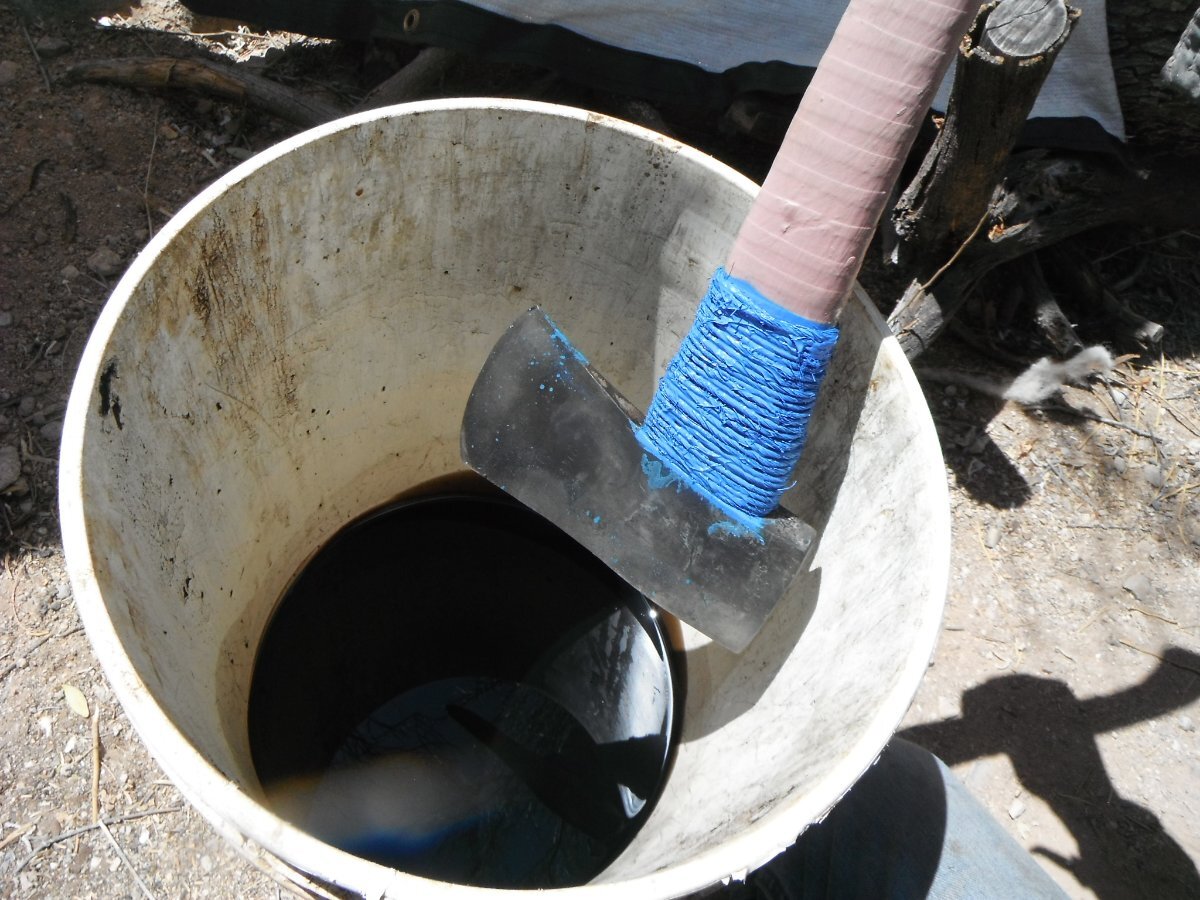

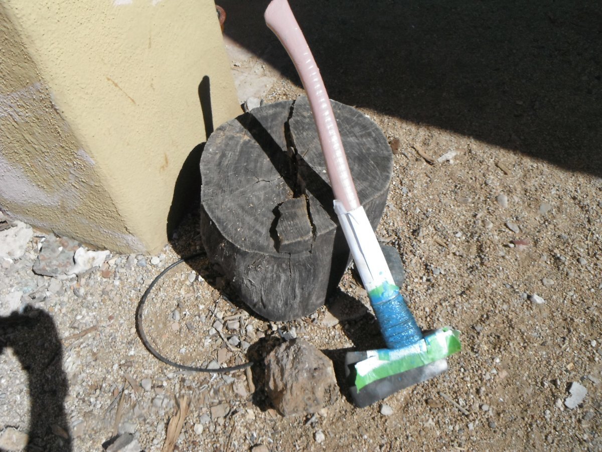

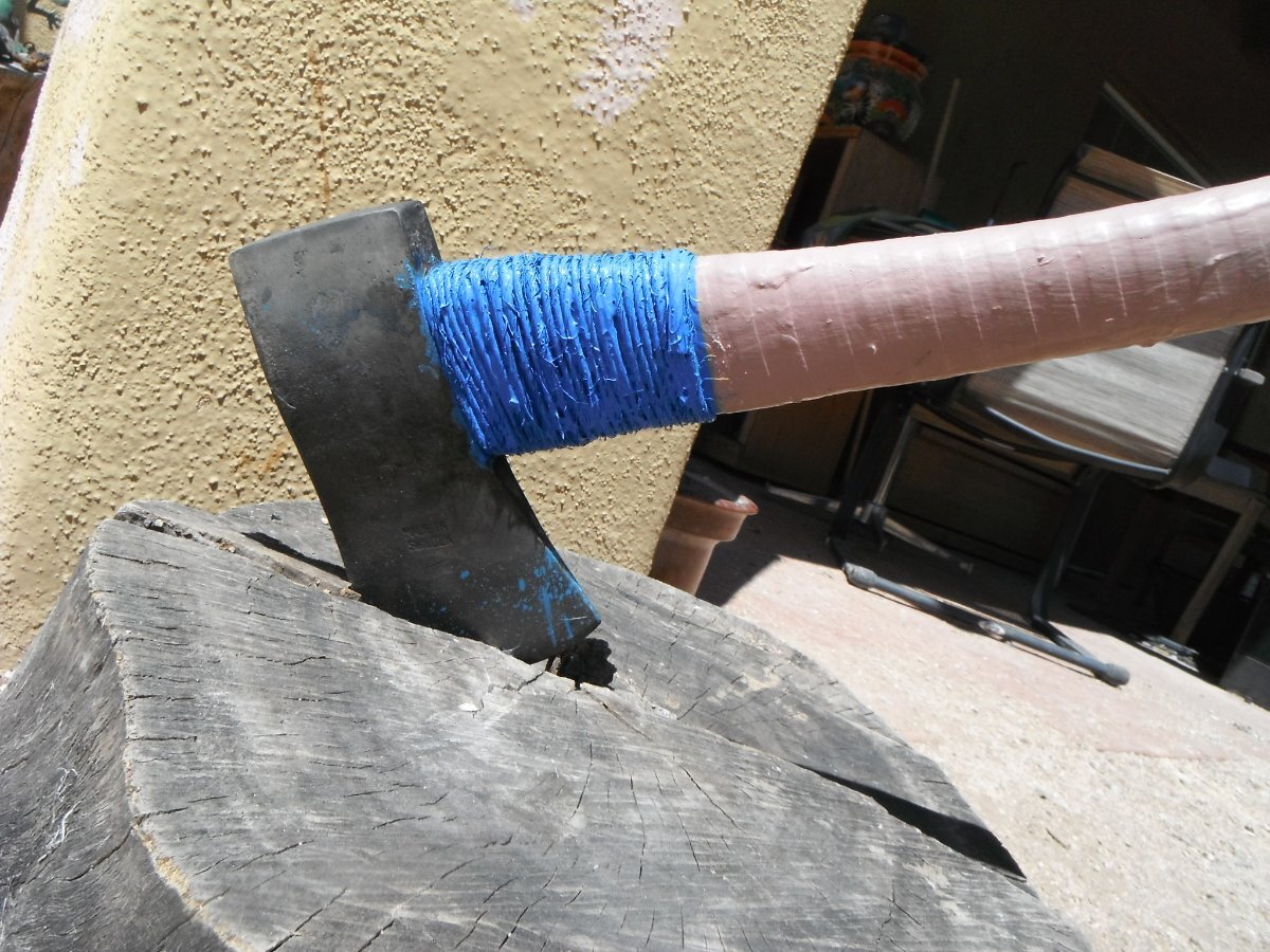

Sometimes I can clean up the wood at the top of the handle by wrapping it with a cord/rope then soaking the cords in a resin or Gorilla Glue. The glue stiffens the rope and keeps it in place so as not to loosen. I can then paint the cord afterwards to help waterproof it. ... ::hmm::

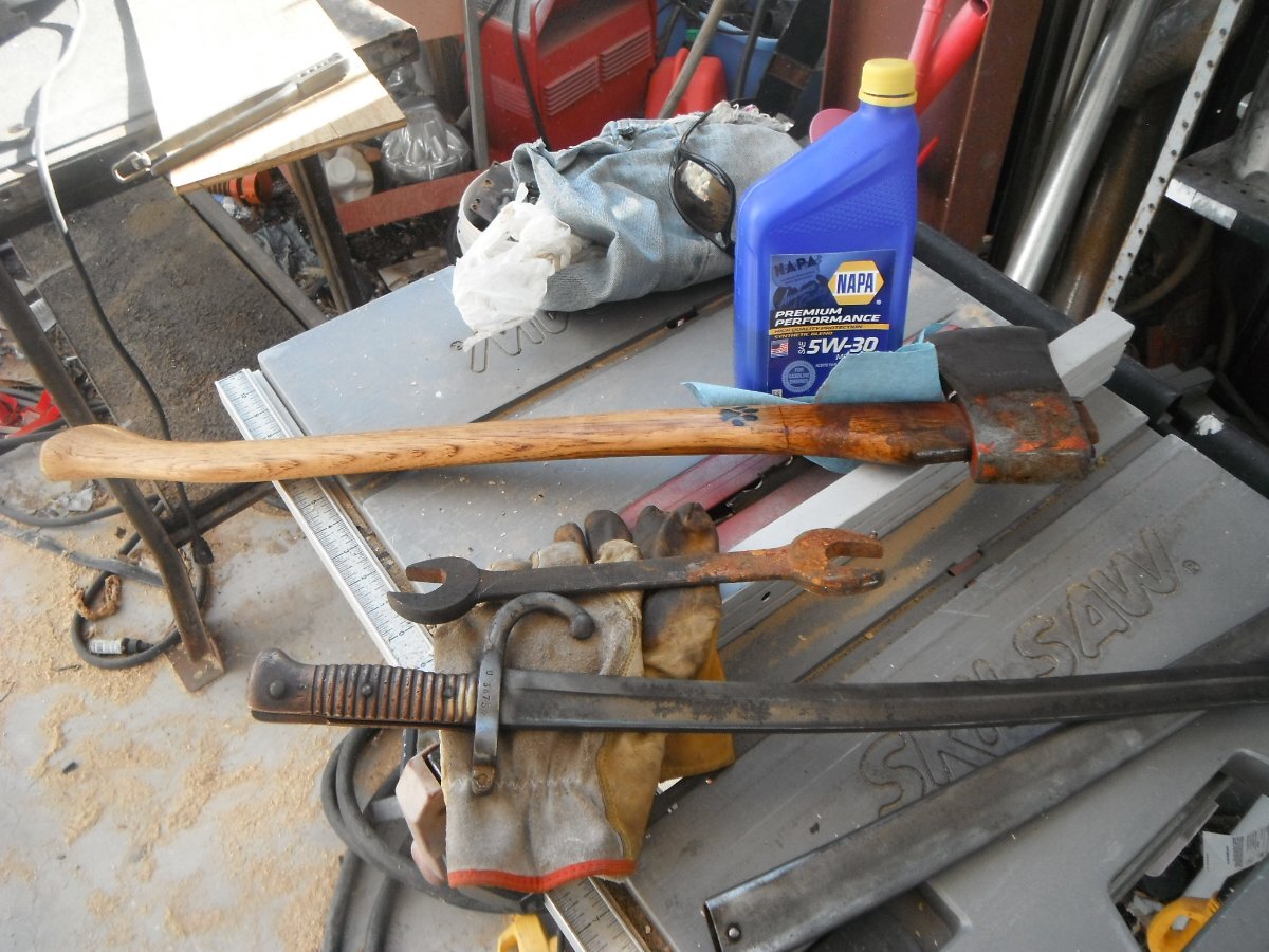

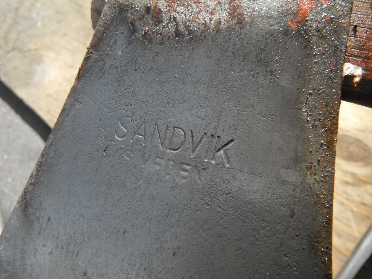

Re: Gransfors Bruks, Hulst Bruks? axes
Post by GSPTOPDOG »

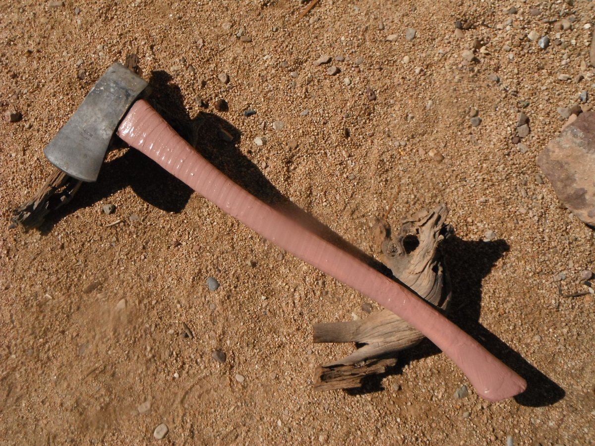

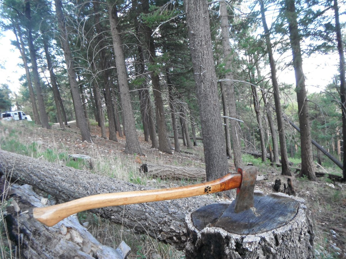

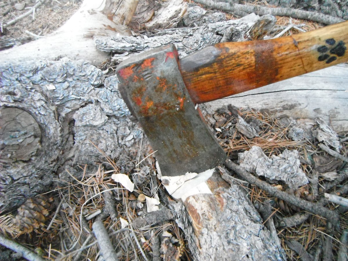

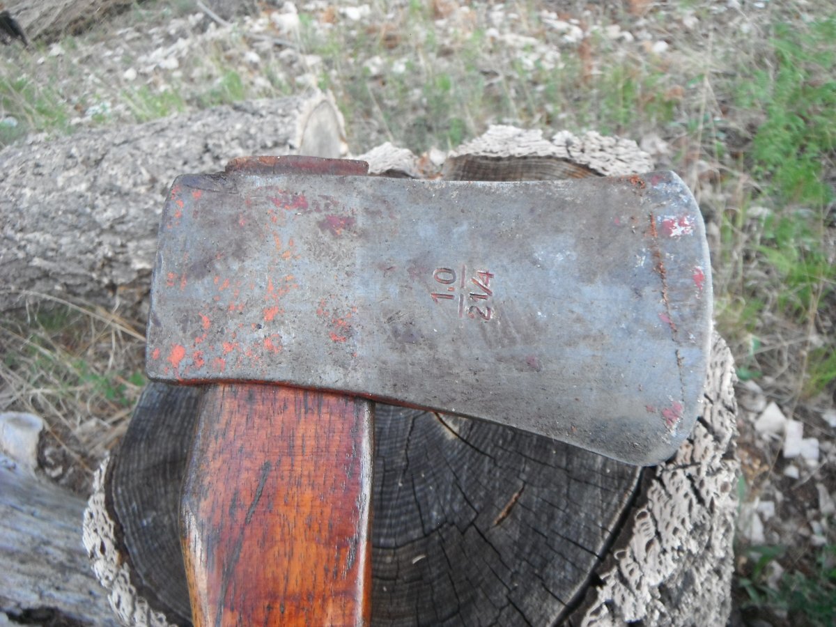

Refurbished, Swedish Axe ....

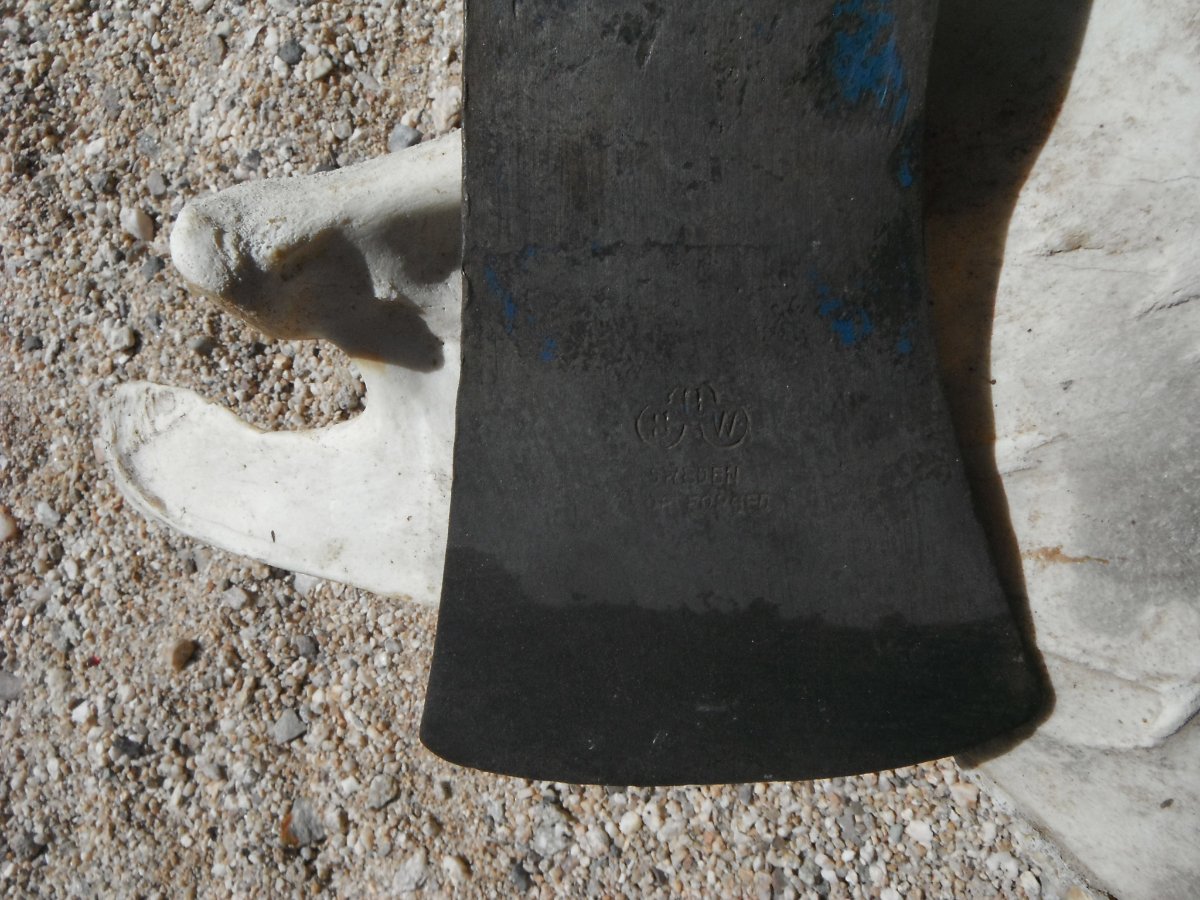

Post by GSPTOPDOG »

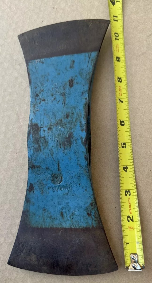

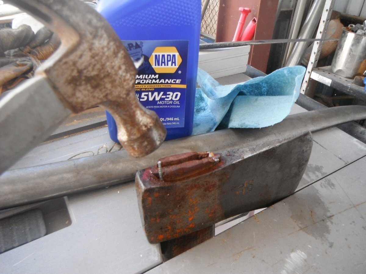

Time to put a handle on this baby ::hmm::

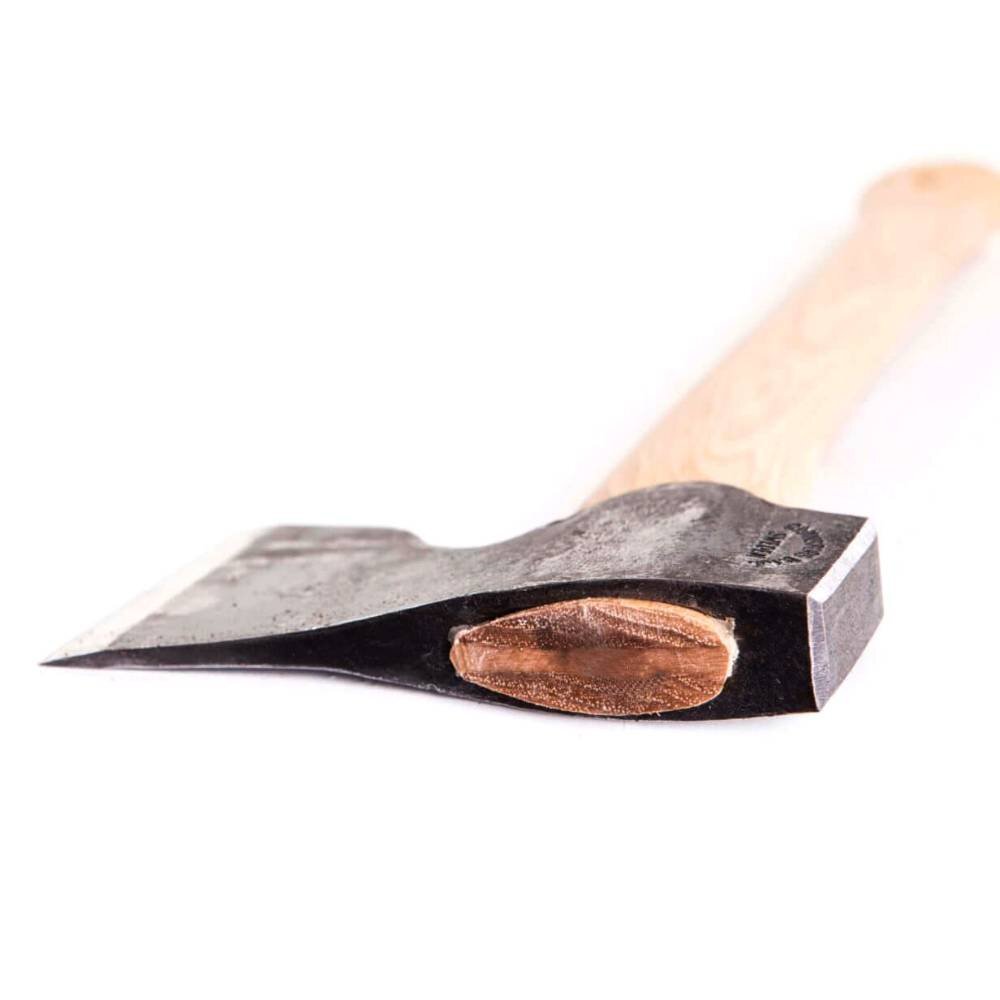

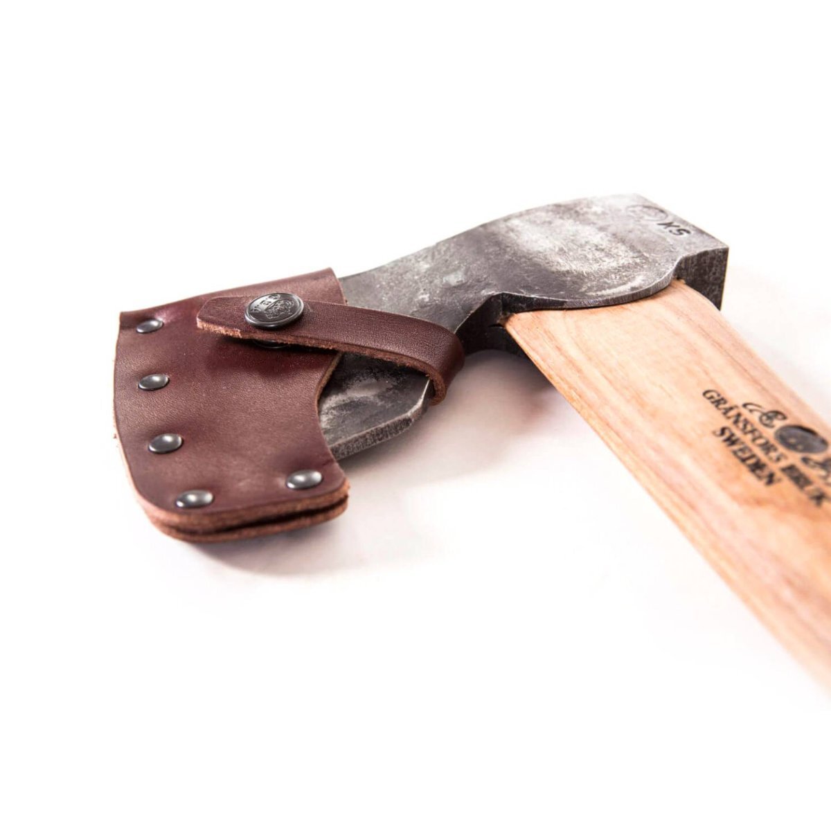

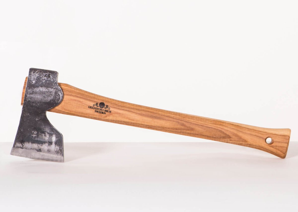

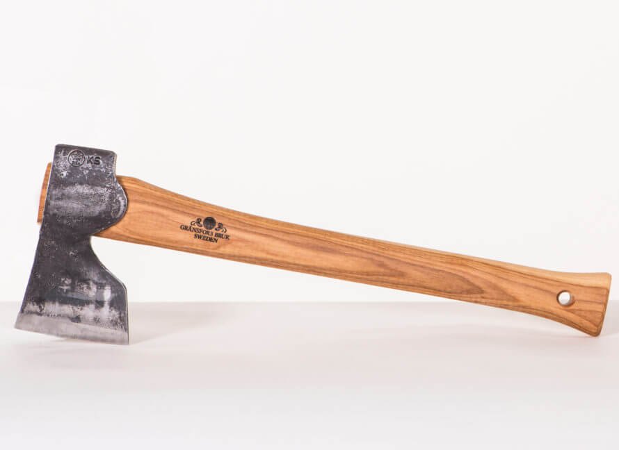

Here it is the night before Christmas... ::paranoid:: when all through the house
Not a creature was stirring, not even a mouse;
The stockings were hung by the chimney with care,🧦
In hopes that ST. NICHOLAS🎅 would be bringing me a Gränsfors Carpenter’s Axe!!! ::woot::

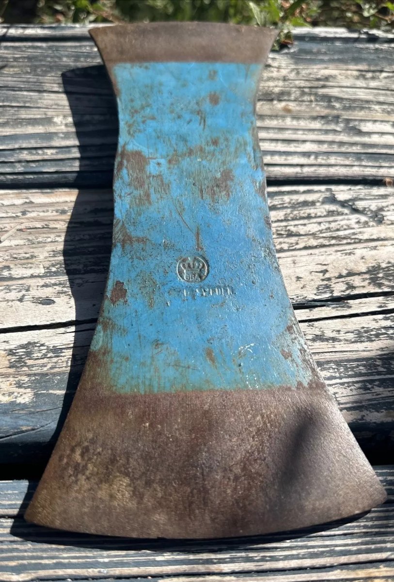

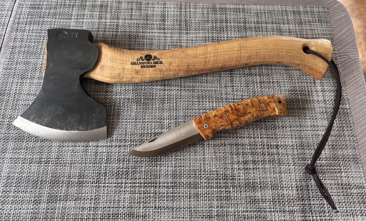

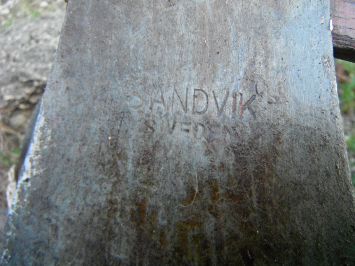

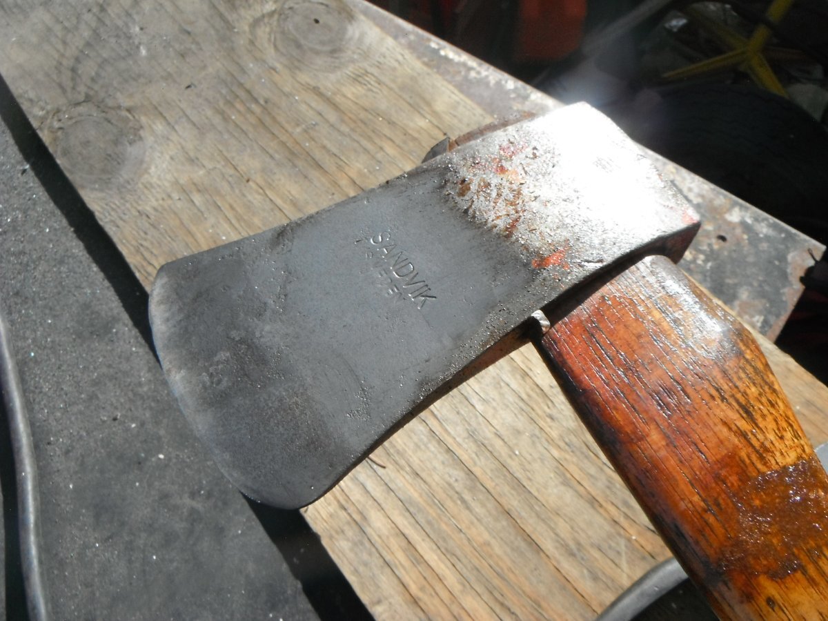

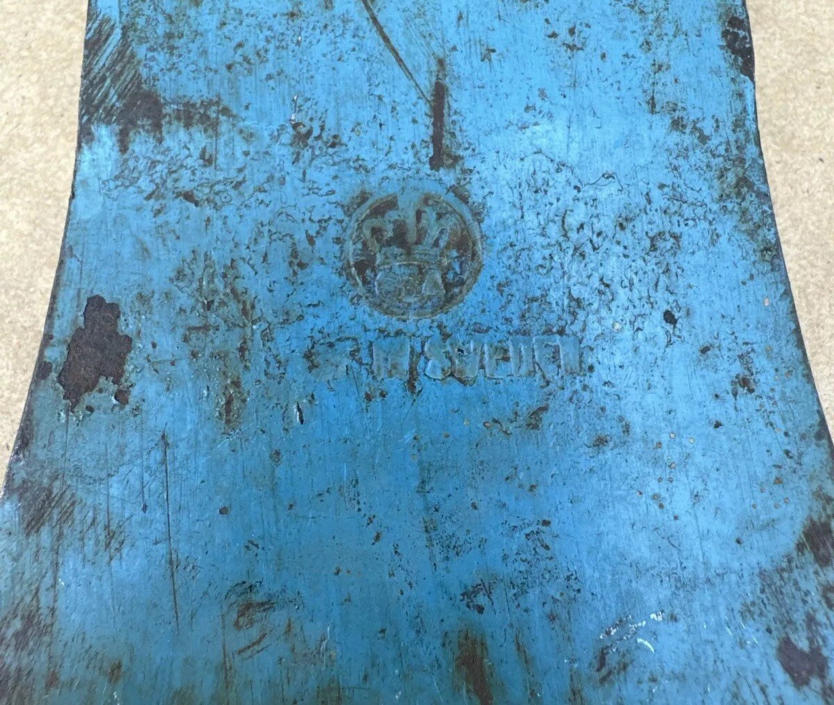

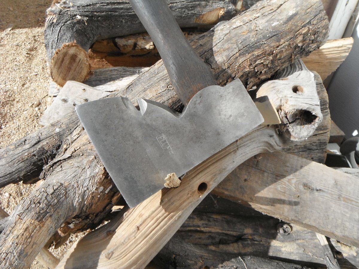

Here is one you don't see very often.... ::hmm::

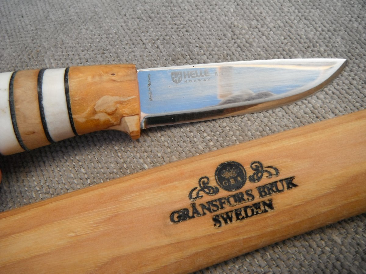

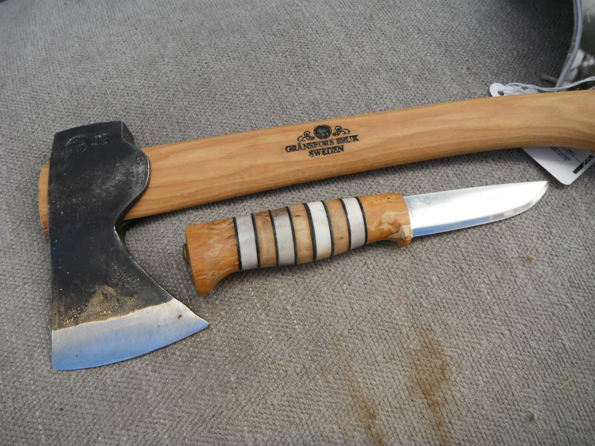

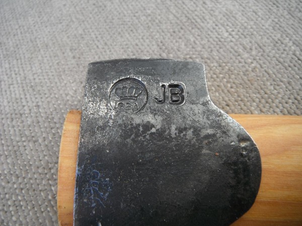

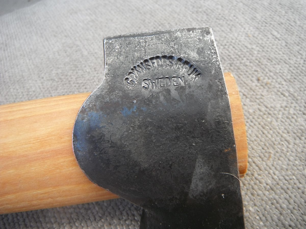

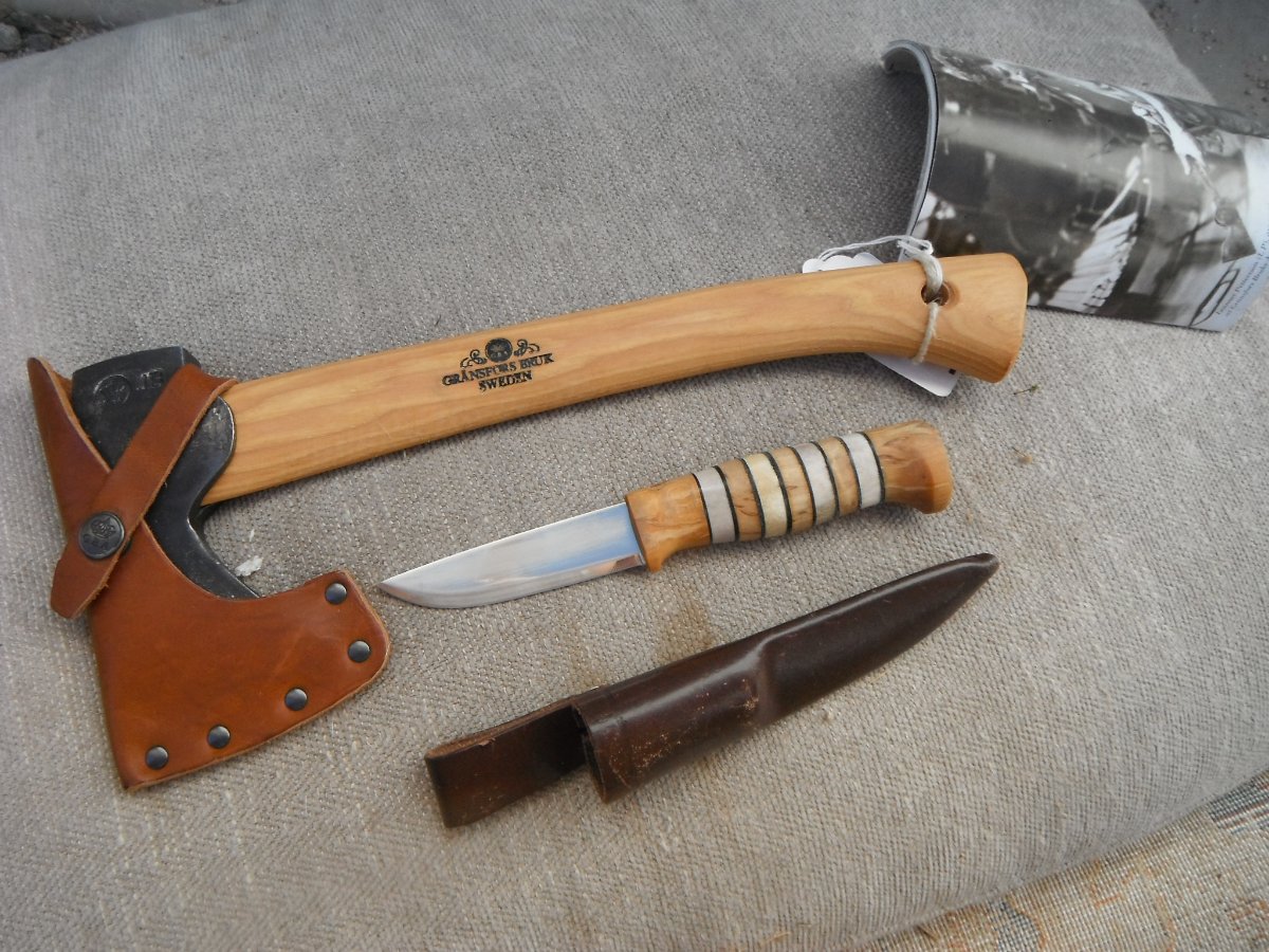

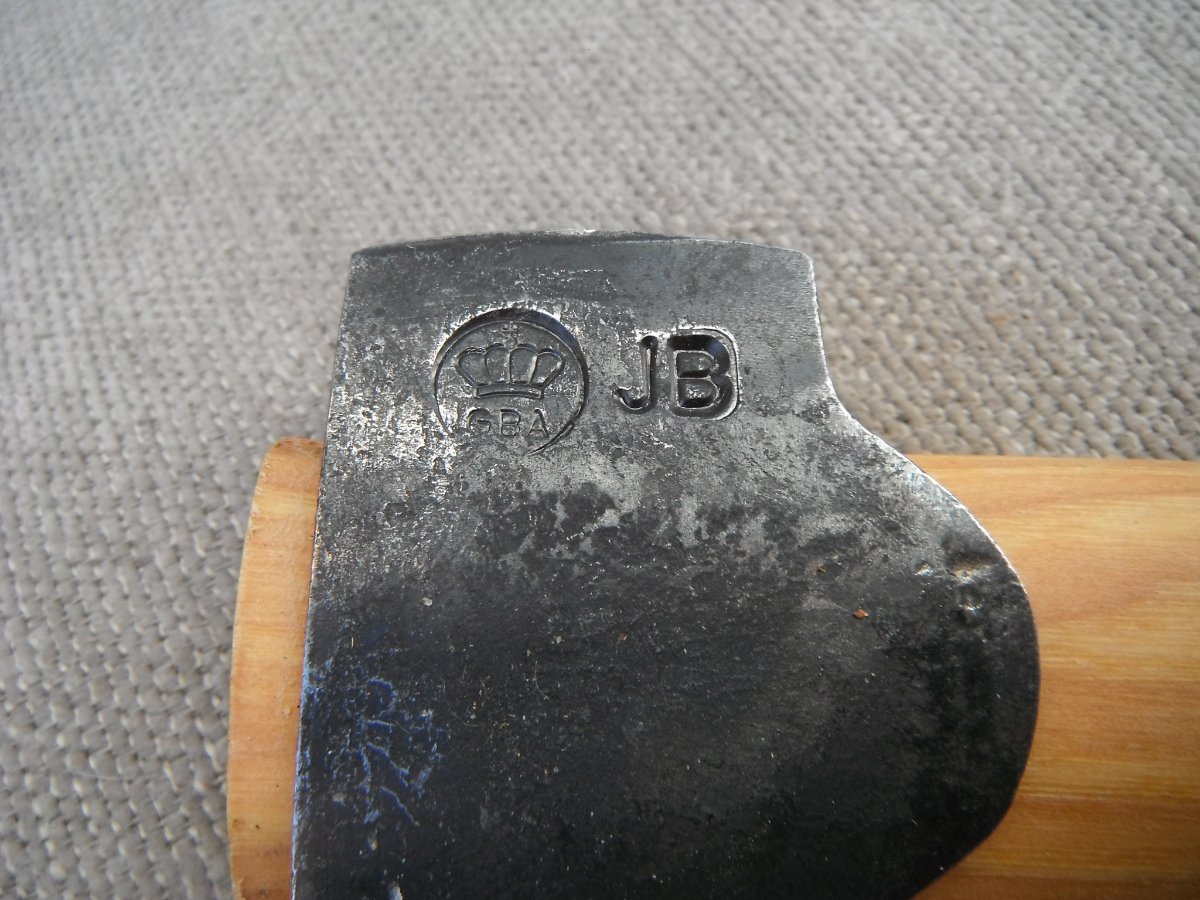

Here is a lucky pawn-shop-find(both :wink: ). It looks like it has never been used. ::nod:: ...The initials "JB" are from the craftsman at the factory who forged the axe head.

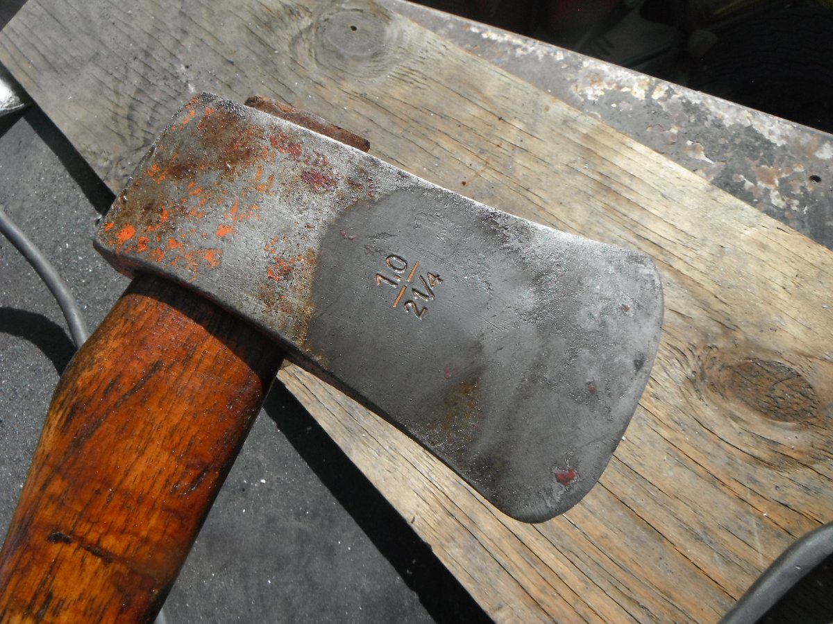

Post by GSPTOPDOG »

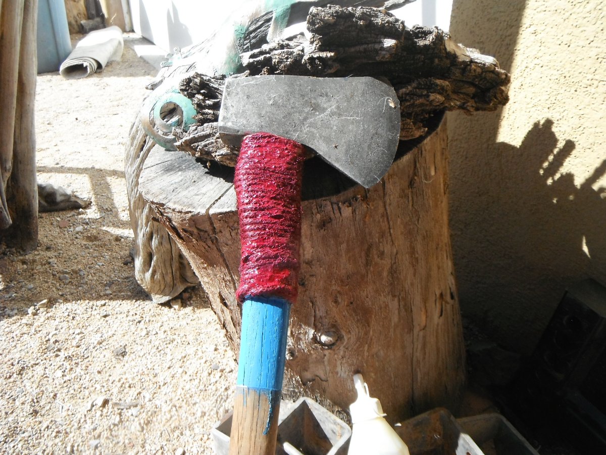

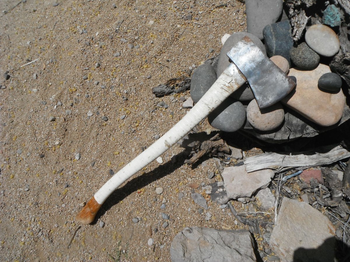

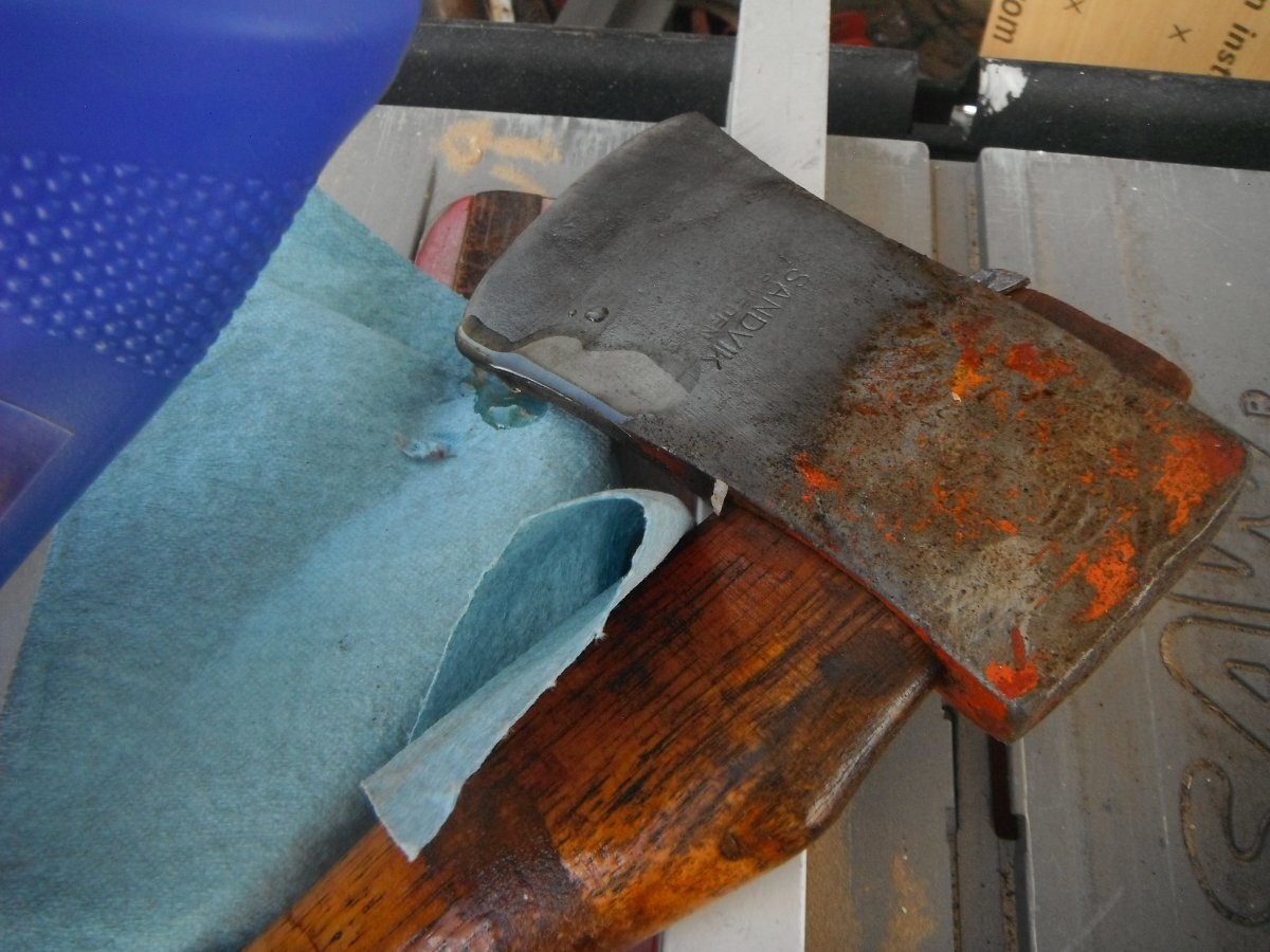

Here is the "before and after" of refurbishing the small outdoors's man axe.
Before:
GSPTOPDOG
Posts: 8014

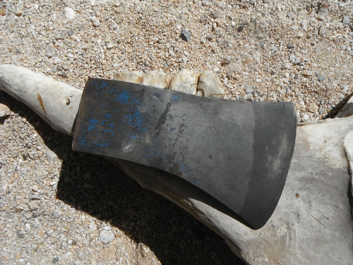

Post by GSPTOPDOG »

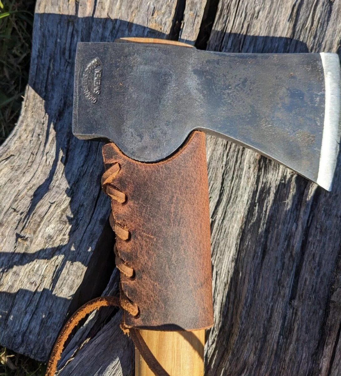

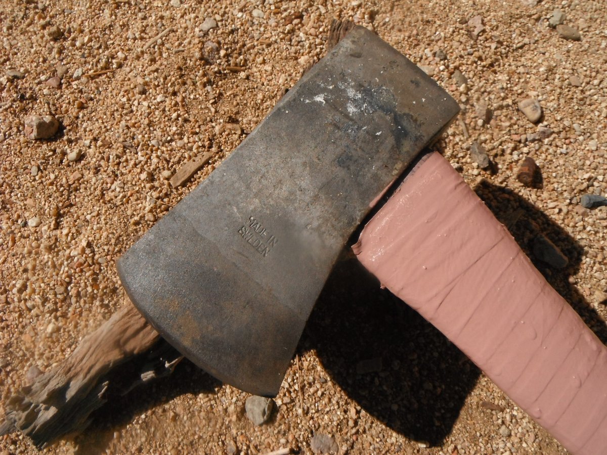

The "after" (and some "during" ::paranoid:: ) of refurbishing the small outdoors's man axe.

I'm guessing Gransfors Bruk named that a Carpenter's Axe because it has a straight handle. Carpenter's hatchets as I know them also have a regular hammer head opposite their blade and a nail puller notch in the bottom of their blade. I do not know the length or head weight of a Gransfors Bruk Carpenter's Axe but the U.S. made 17" 28 ounce version with a checkered hammer face for framing is a rig builder. Better tools for les money.
An uncle heated with wood his whole life. His wood furnance heated his hot water tank and its heat was spread through his house's forced air floor vents the same as a propane or oil furnance. He tightly wrapped steel wire around the top of his 36" axe handles. The wire was some where between 0.1" and 0.2". Despite continuous use those two axe handles lasted at least 30 years. His favorite hatchet was a Vaughn Rig Builder. He bent sheet metal against its wood handle below the blade, folded it along both sides then secured the back edges with wood screws. It also lasted a long time but I do not know how long he had it. I copied his screwed on sheet metal guard on a maul. That extended the handle's life years. I'd expect either method to last longer than cord soaked with Gorilla glue. Give one or the other a try.

::hmm:: ... I suspect that you are correct when you state that the U.S. made 17" 28-ounce version with a checkered hammer face for framing is a rig builder are better tools for less money. I have a hatchet that I think is a Vaughn Rig Builder. I have maybe a dozen or more Vaughn carpentry hatchets and I have found some for $1 or $2 at yard sales, so that is on reason that it is hard to justify shelling out $223.00 USD for something pretty close to what I found at a yard sale for $1.00 .... ::paranoid:: but all the same, Gransfors Bruk Carpenter's Axe... 🤤🤗 I sure would like to have one... ::doh:: .... ::dang:: .... ::facepalm:: .....

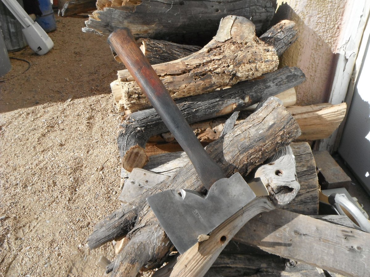

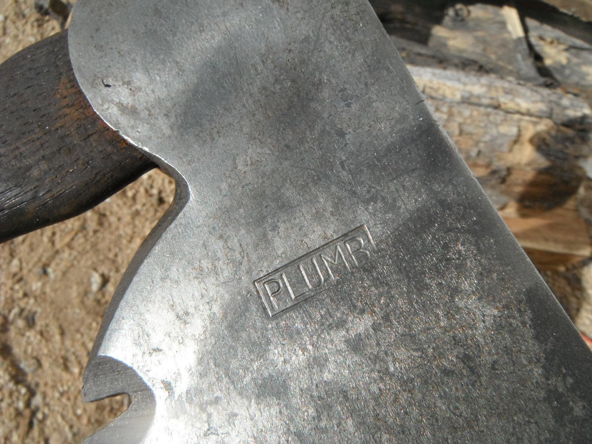

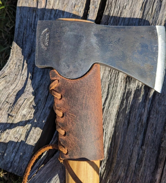

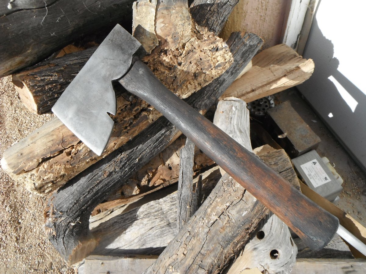

This Plumb carpentry hatchet is very close to the Gransfors Bruk Carpenter's Axe and only cost me $10... and some elbow grease to clean it up. ::hmm::
I guess with the extra money I have saved on buying used axes, ::paranoid:: I could buy a bunch of lottery tickets and then take the winnings and THEN buy all the brand-new Swedish axes I could ever want... ::hmm::
