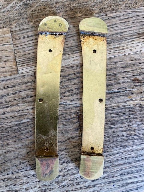

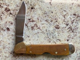

I purchased this small lock back from SMKW to dissemble and rescale. As I started to dissemble the knife I cut through the lower bolster pin and the rocker pin when I got to the top pin where the blades were the razor blade broke so I put a new blade in and that broke and started to bend the bolster and inner brass scale. So I decided to drill out the pin. Half way through the pin the drill bit broke. Now I have a problem so I know I can’t cut the pin with the drill bit broken off so I move to the other side and drive the razor blade into that side again to cut the pin after 3 good hits the pin shears and the top bolster flies off into the barn somewhere. I had a flat piece of brass so I made a bolster. Out of the brass and soldered it on the brass scale. That was one tough pin. I add this up to a learning experience.

The new bolster is on the left color a little off.

I think you did a great job on the new bolster. What is the highest grit paper you used on the new scale material?

Nice save Nev on a rather difficult project! ::tu:: Sure looks good now! 8)

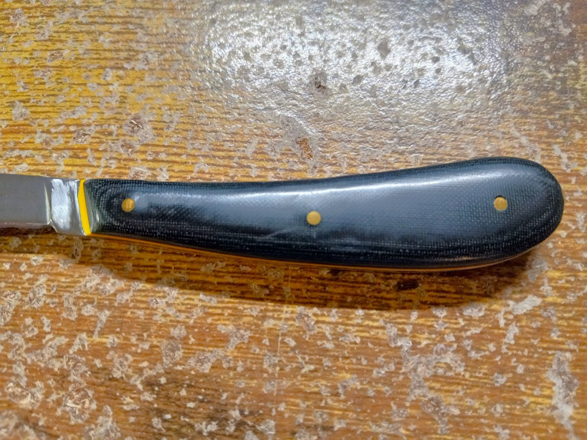

A micarta project I did (letter opener) I used 3000 grit, then either 5000 or 7000 and then end with 10,000 grit. After that I rubbed it down with Murphy Oil Soap and dried it. It almost shined like glass.
Terrible pictures, but the handle has gotten a little dull now.

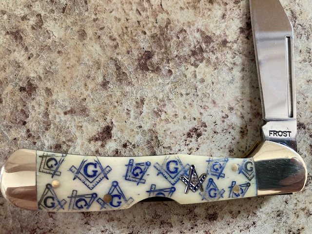

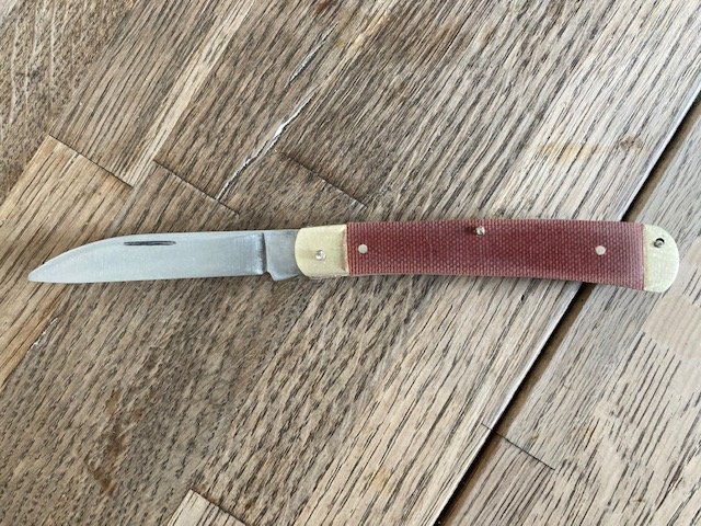

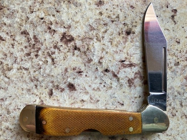

Finely Done,
Phew what a job I made of this so-called small task. ::dang:: Sad thing is I think it looked better before I worked on it. :oops:
Well anyway I used the setbacks as a learning experience.

Nev52 wrote: Sun Jan 23, 2022 10:16 am I have some paste wax for wood do you think that will work?
I'm not sure Nev, but if you have a piece of scrap left try it on that first.

I don't know Nev, ::shrug:: unless you're a big Masons fan your fresh new covers look teriffic to me! ::nod:: Nice work, well worth the effort! 8)
8)

My wife had Murphy's oil soap. I cleaned the knife with it. Than put some past wax on it. I think it is the grit from the sandpaper burned into the micarta.
frost lockback r.jpg (38.14 KiB) Viewed 2645 times
I must be doing something wrong. I will have to experiment more.

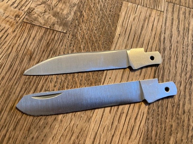

Good Morning everyone.
I started a new project to add more experience to my knife repair hobby. While reading the forum Olde Cutler redid a knife and made a wharncliffe blade for the repair. That gave me an idea to use up the extra parts I had left over from the trapper knife kits I have been building. I had some left over spey blades springs scales and inner brass cut scales since I made some single blade trappers from the kits and made my own handles or scales. So I figured all I had to do was make bolsters solder them on the inner brass scales and regrind the spey blade to a wharncliff blade and I would have a single blade wharncliff trapper from parts I had no use for. Hey what’s not to like about that. It’s like a free knife. I posted pictures of the build.
I would like to thank the people on this sight for their advice and encouragement on my projects on this new hobby into knife repair.

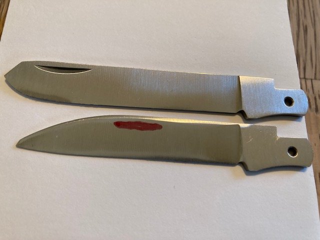

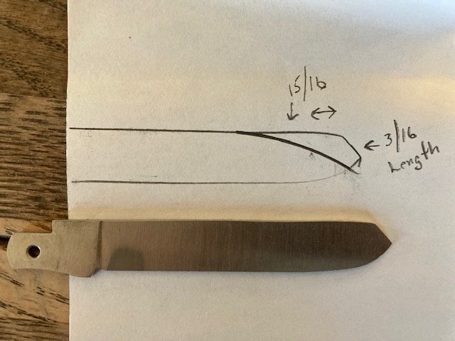

Mark up of blade.
Nev52
Posts: 1243
Joined: Thu Sep 14, 2017 12:37 am
Location: Pennsylvania
Re: Giving knife repair a try.
Post by Nev52 »
Spey blade. to wharncliffe conversion. Only thing I lost 3/16 of blade length.

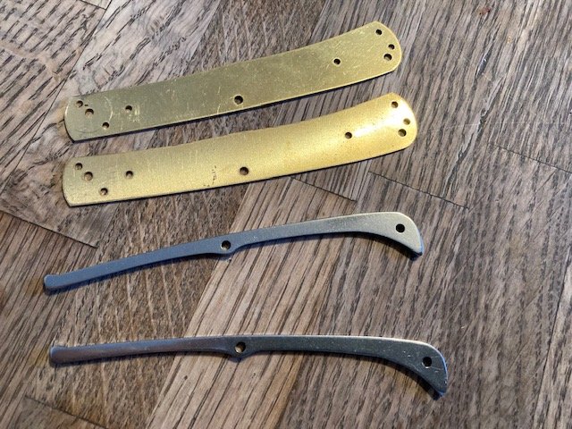

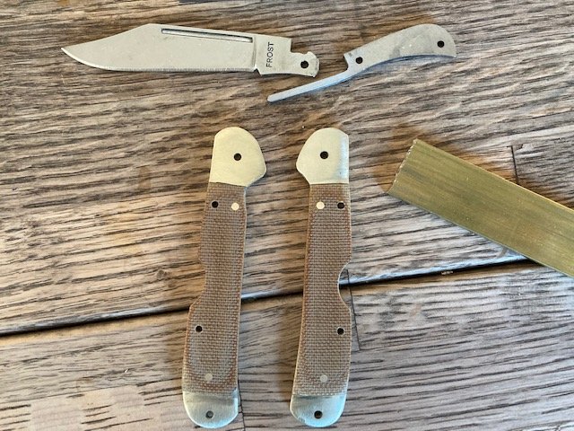

I used old scales to lay out bolsters.
Nev52
Posts: 1243
Post by Nev52 »

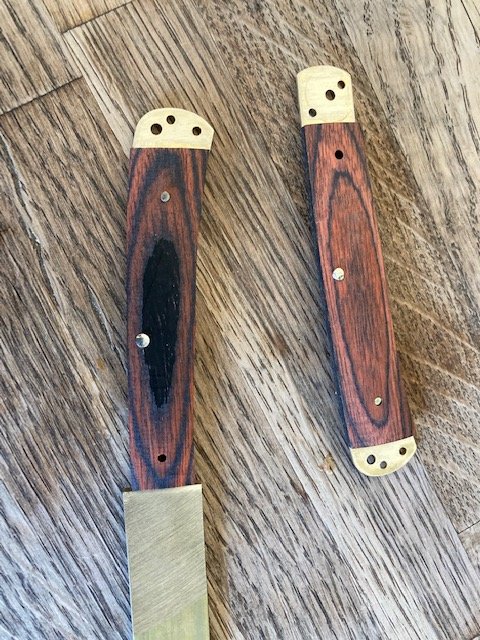

Soldered bolsters on scales. Then I shaped and had to drill out for pins.
Nev52
Posts: 1243
Post by Nev52 »
Rough markup of knife.
