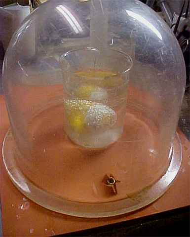

Hey Whittlenut
Yes, Bill is correct about lookin' at it and you are on the right track. The water temp would have to be around 2500-3000 Degrees F, a small 10,000 gallon pool would be your best bet and you would have to drink about a pound of Titanium dust/grindings with a gallon of water before juming in also. Be sure it is distilled water.
Then P (in your pool, of course) on your item.
Kinda like underwater sand/bead blasting, if you catch my drift.
It may help if you had some morphine or other major narcotic mixed in there. In case there was blockage, it may feel like passing a million kidney stones before you get the job done.
This is all in theory and you are doing this at your own risk. Let us know how everything comes out. Post some before and after photo's/images if possible.
Good Luck
9ball
BTW:If you did it with the vacuum method, you would not be able to breathe.
Good Luck
9ball
- Attachments
- Under Pressure.jpg (14.75 KiB) Viewed 4510 times
