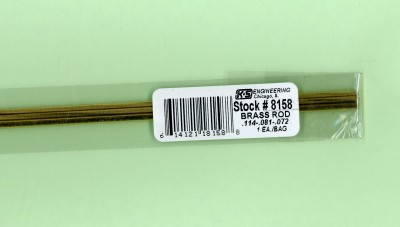

BRASS PIN-STOCK
The assortment of brass pin stock Jantz has is a bit more limited.
They carry 1/16”, 3/32” & 1/8”.
I also get an assorted package at Ace Hardware that contains the following 3 sizes:
.072”
. 081”
.114”
- This is the label on the pack of 3 assorted sizes of brass rods (pin-stock). You can use this label to order this pack from your local Ace Hardware store.
I think True Value Hardware also gets brass rods from K&S Engineering.
I use a lot of the .072” & .081” size pins.
