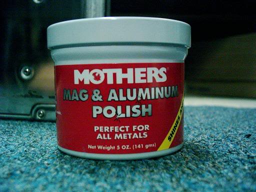

This works well with just a rag.
- Attachments
- Metal_Polish.jpg (35.22 KiB) Viewed 4310 times
