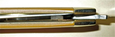

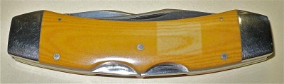

Just bought this 1980 CASE Texas Lock Horn. It's not been carried, and is in 'as new' condition except as noted below.
It's unused, but blemished by the shadow of a sticker on one of the Micarta scales; known before purchase, and not a serious issue for me.
The two ends are essentially identical, each blade having a short lock-back.

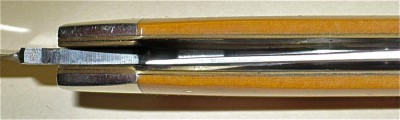

But one of the blades hasn't been properly fitted during manufacture so as to correctly bypass the other in folded position.
The blade at fault is not adequately offset away from the liner on it's side, and hangs up during the fold; it can be eased in.
I have seen, somewhere, the term 'krink' for the technique used to assure proper folded blade clearances.
I'm considering sending it to Case for repair, even if I have to pay for the effort, but thought to ask here for comments before mailing.
Thanks for your help, all. wlw

Nice knife, too bad it has this problem. Looks like it probably came off a board from a Case retailer's display case. I have dealt with Case factory repair service in the past, although not recently, with good results. Be aware Case doesn't stock old parts. Repairs requiring parts are made using current manufacturing parts. The Lockhorn pattern is discontinued so my recommendation is to call or email Case factory repair first, explain what you have, and ask what they can do to repair it. You can get contact info from the Case web site http://www.wrcase.com.
There are also some good knife mechanics on this forum, so some of them may be able to tell you more about how this knife can be fixed.

Hard to tell without knife in hand and from the pics but are you sure the blades are falling into the proper location? Correct side, I mean.
I have seen a single backspring CASE double ended jack or pen where the blades got "crossed", if you understand what I am describing. I assume this could happen even on a two spring knife also.
Just a thought.
Regards, Jerry

The correctly aligned blade lays exactly as it should, and clears the liner on it's side by about .015" with the other opened. Thanks!
This is pretty conclusive, Jerry; no 'crossed' blades.

wlwhittier wrote:The correctly aligned blade lays exactly as it should, and clears the liner on it's side by about .015" with the other opened. Thanks!
OK, thanks. Just trying to help out. I had a small pen do that to me once and it was kinda of a bear to get undone. Now that I recall the experience and look closer at your knife, if they were "crossed", the nail nicks would be partially covered. My bad.
