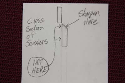

Just remember you only sharpen one side on the scissors, they are a single bevel tool. I've seen folks try to sharpen scissors and hedge clippers like a knife or ax, on both sides, and ruin them, Joe.

rarefish383 wrote:Just remember you only sharpen one side on the scissors, they are a single bevel tool. I've seen folks try to sharpen scissors and hedge clippers like a knife or ax, on both sides, and ruin them, Joe.
Yup. That's why I knew my Lansky Turn Box wouldn't work.
Great reminder!

A picture is worth a thousand words. I don't know how many pair of good hedge shears I've seen ruined because someone sharpened both sides. I try to explain that's why they call them shears, they are single bevel. If you cut a double bevel on them the blades will spread apart as they close. Sorry for preaching to the choir, Joe.
