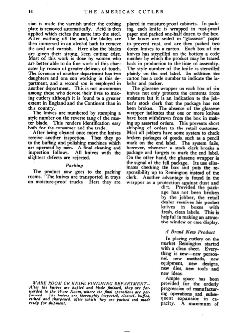

After posting the release of the Bullet knife as found in the American Cutler 1921 I found this article with photos on Remington in the next issue (June 1921) which describes their cutlery business in detail after it had begun in 1919 - to me it was a cool article describing the whole Remington knife making process with some great old photos... In fact you never know which of those workers may have touched and worked on your old Remingtons in your collection :D ... Anyway again this was a pdf but turned it into jpegs of each page - unfortunately the photos wouldn't copy into the article text so any photos from that page would be below the page text as an attachment - and hope they are good for viewing. This will have to be 2 posts in a row to get all the pages and photos included as I think the limit is 10 photos per post.. The last attachment is the end of article but about halfway or so down the page. Personally I can see now how Remington put out so many knives - lots of workers and equipment... Hope you enjoy it! Feel free to pin it to the top if all decide it is worth it....

CONTINUED-
END

This is a great educational thread, Lee. ::tu::
That the glazers used wooden shoes and pants is very telling as to the time period.
Also, I was surprised to see that after the women put a cutting edge on the blades the blades were stamped with with a
style number on the reverse tang of the master blade. After heat processing.
I really enjoyed this thread, Lee.
Good show!
