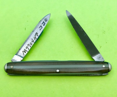

Here's a shot of a CutCo inkydinky.

tongueriver wrote: Wed Jan 15, 2020 2:32 am Here's a shot of a CutCo inkydinky.pile.JPG
Cal, the salesmans ink on that knife is sooo fake, you should send it to me as I know how to deal with it. :D
