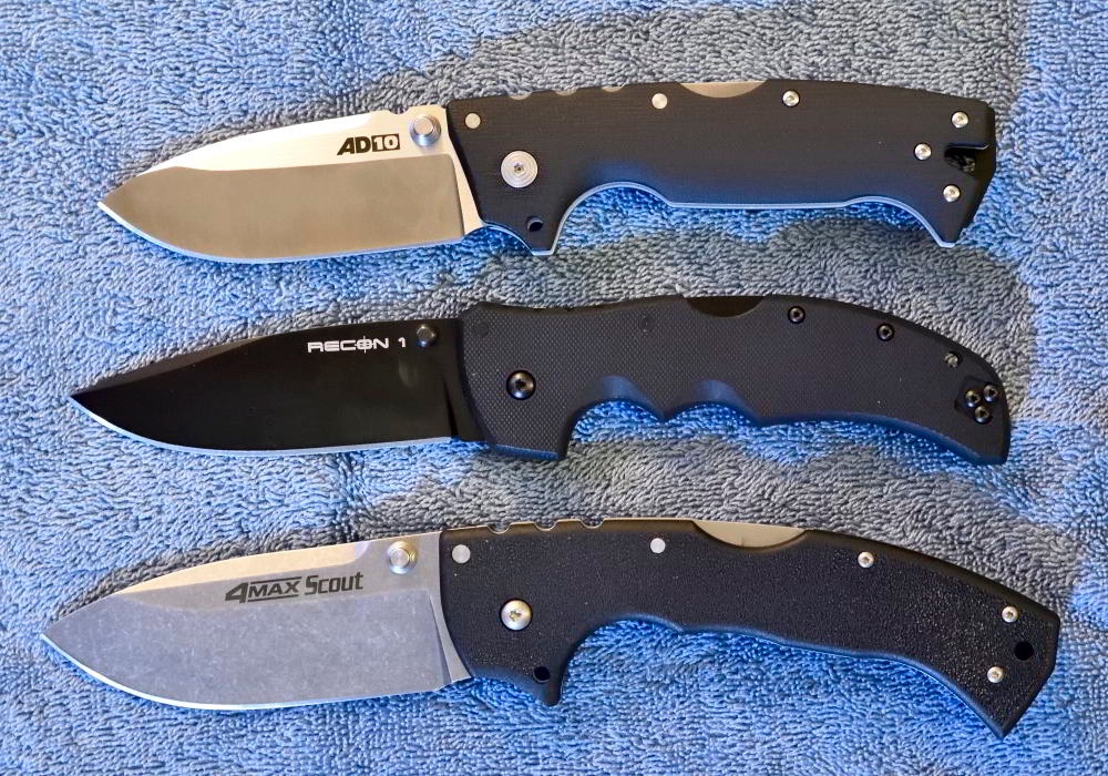

The AD-10, Recon 1 spear point and 4 Max Scout:
I am very happy with these knives so far! I didn't think I'd ever want to carry anything other than a liner lock or Axis lock, etc. for EDC but these Triad lock knives are growing on me. It's hard to express just how carryable that huge 4 Max Scout is. It's surprising. I don't think it's too practical for EDC but it's fun to show it off.
