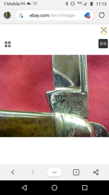

His signature long pulls running clean into the tang stamps on a NYKC and C. Platts.
I guess the guy cutting those into the blades isn't always good about putting the brakes on soon enough.

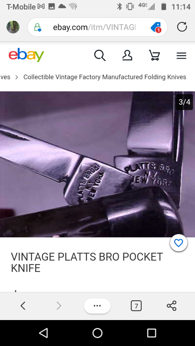

I'm not the brightest bulb in the knife drawer, but even I could see that fake. The old tang stamp not only shows through, but it looks like it was arched stamping too.1967redrider wrote: ↑Thu Feb 25, 2021 1:07 am Classic signature Myrtle fake.![]()
https://www.ebay.com/itm/Vintage/164718679985

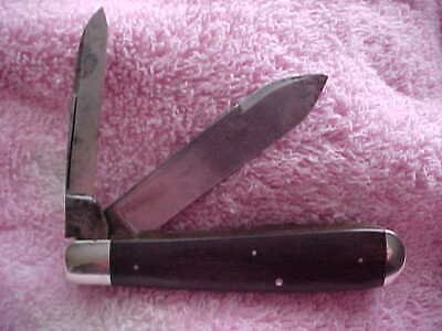

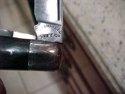

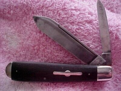

Speaking of.... he's got this Northfield up now, ending in about 4 hours currently sits at $118
So is this another fake or ???

Sold! ... $285
Guess it was real enough

My opinion is that this knife is a total fake, a couple things I notice right away, every Northfield 2 blade I've handled has both tang stamps on the mark side, the shield looks to be Holley, Northfield may have used it but I don't recall seeing one, many times on Myrtlefayes knives a tang stamp looks cold stamped and is not square to the blade, the impression will be deeper on one side of the stamp and almost non existent on the other side such as the tang stamp this knife.
He posted a couple doozies yesterday and I noticed he is taking photos now where he is covering part of the tang stamp on the main trying to hide the obviously poorly done stamp. If you really look hard at most of his knives they all appear to be worked to some degree.

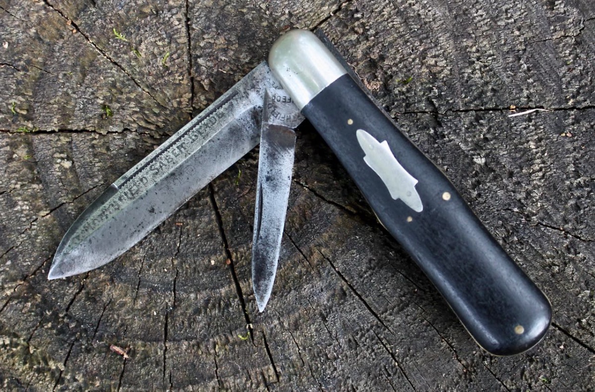

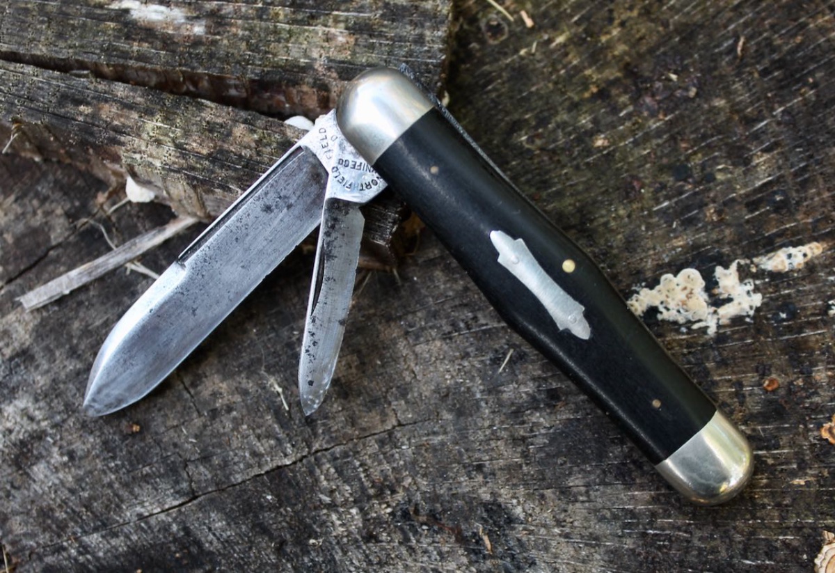

Two real Northfields I have in my collection.

Bad fake.If he posts a real non cobbled knife,it is by accident.Gone2Three wrote: ↑Fri Mar 19, 2021 8:57 pm Speaking of.... he's got this Northfield up now, ending in about 4 hours currently sits at $118

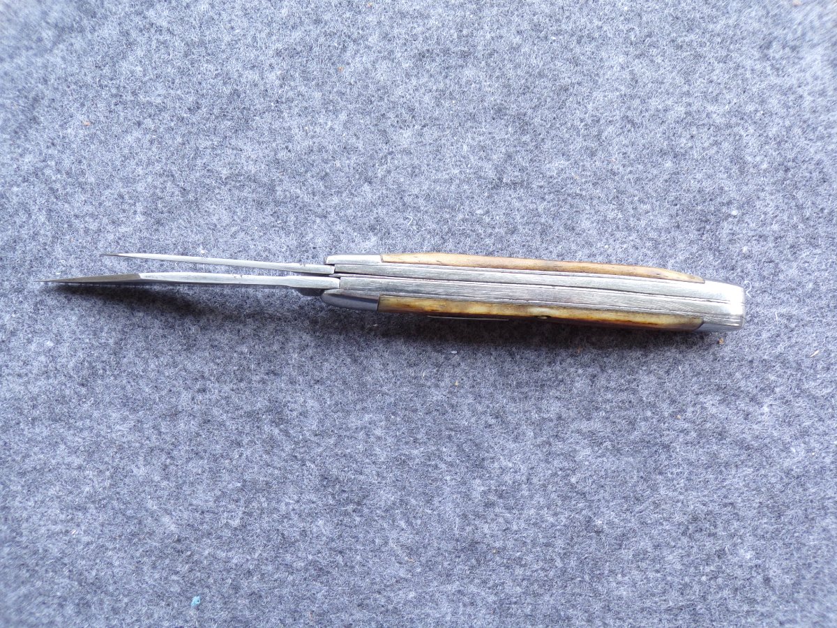

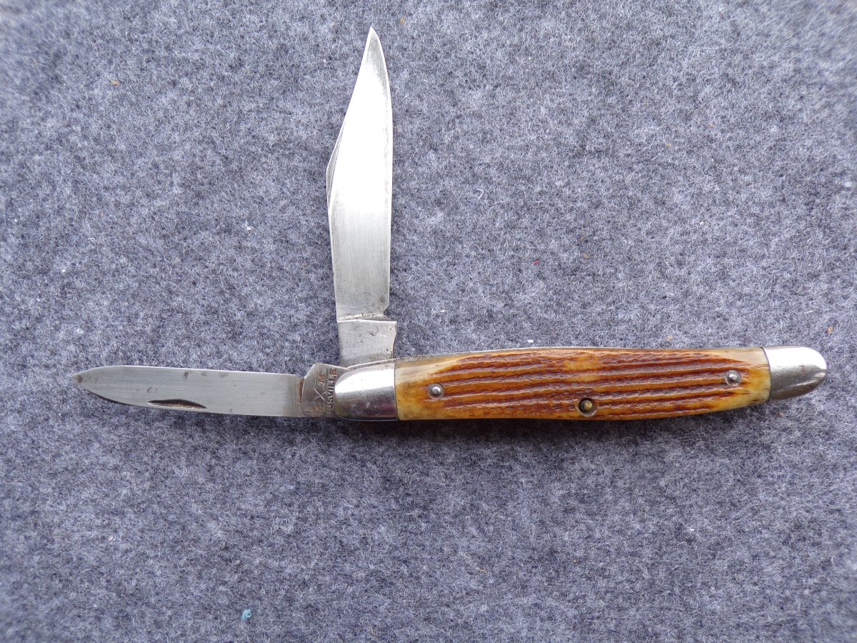

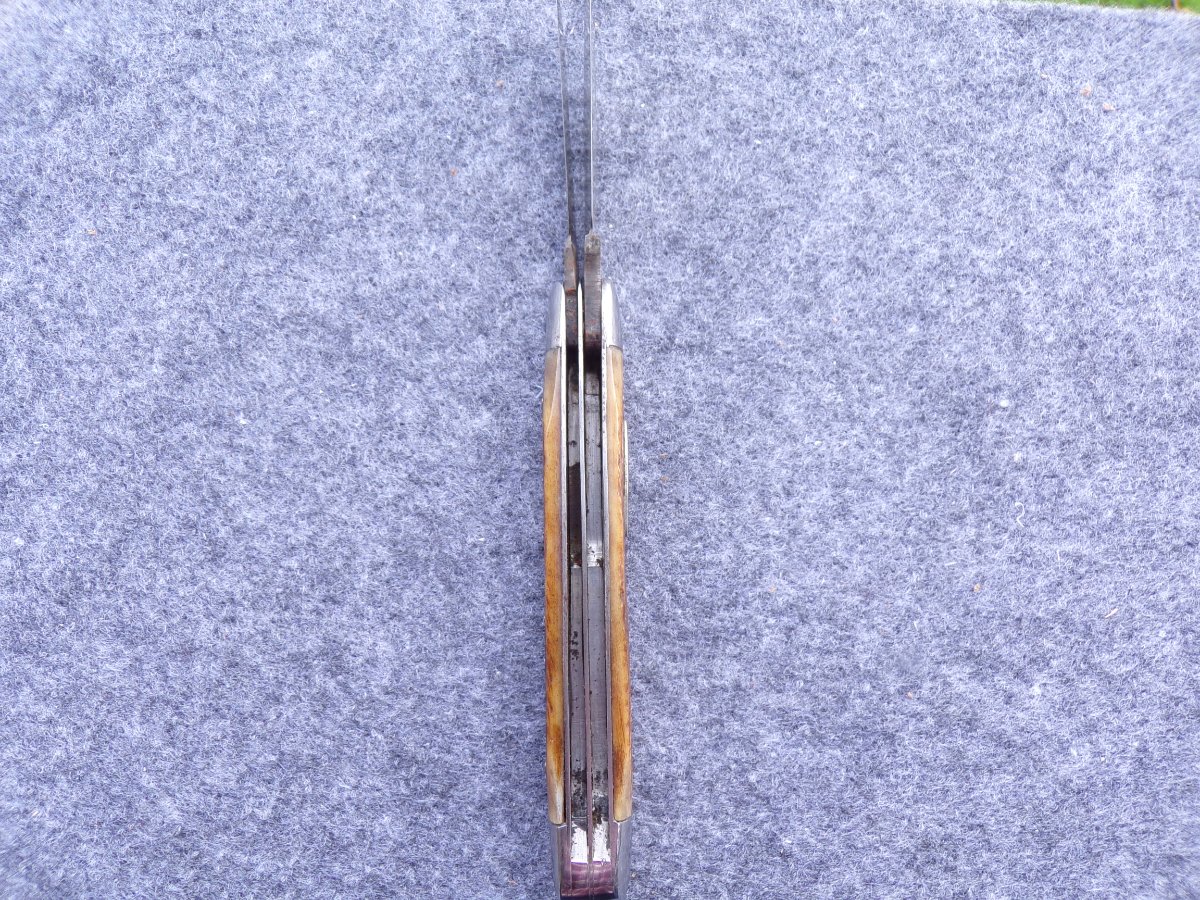

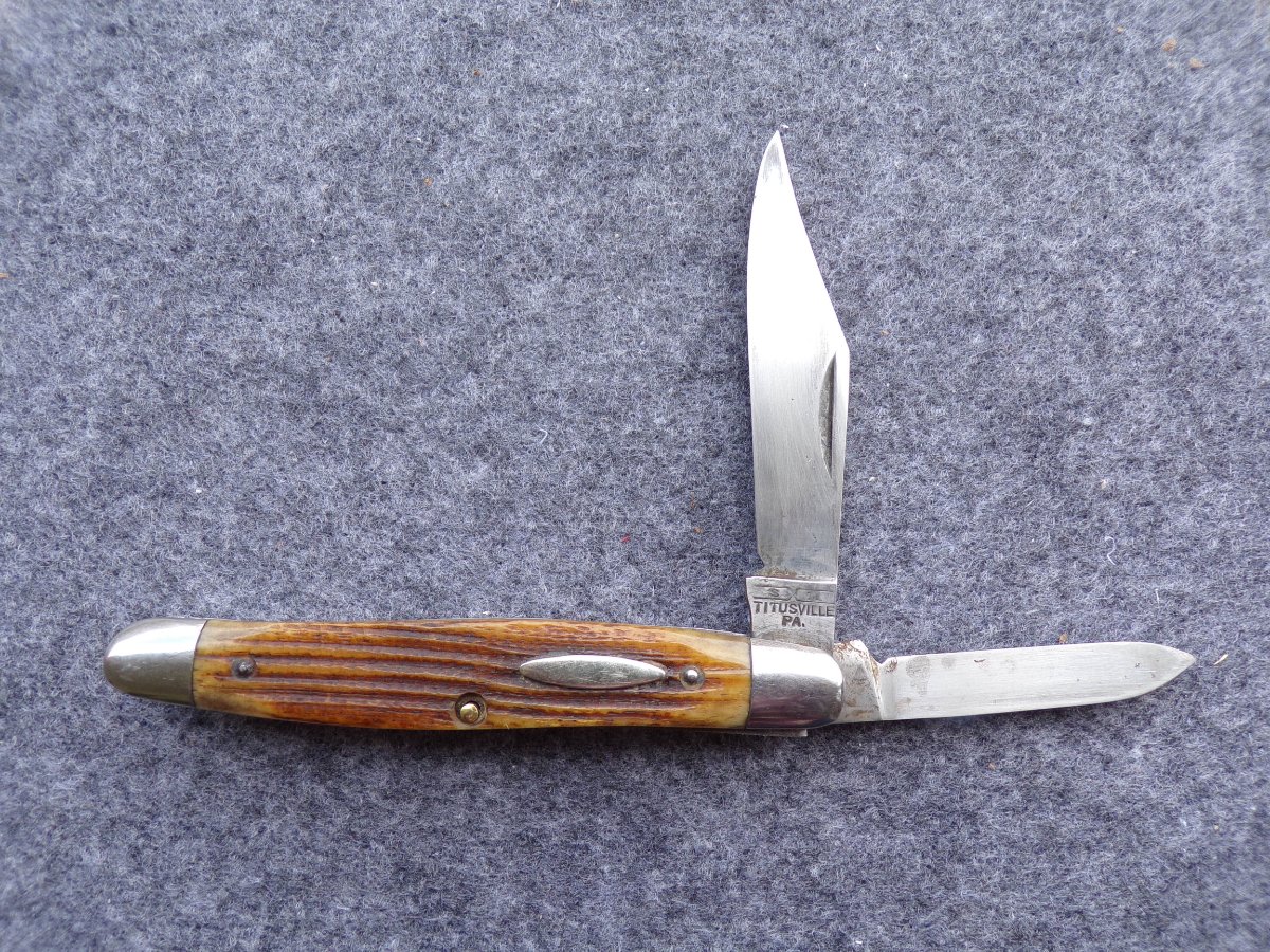

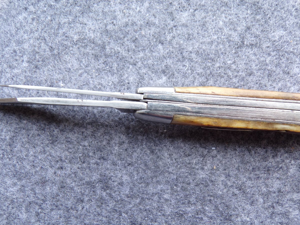

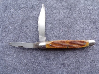

I will confess, I bought a knife from him 7 or 8 years ago. I knew it had been posted in this forum that they were fakes. I was curious and wasted $65.00 or 70.00 dollars. I carried this knife for a while and showed it to my knife friends. So here it is for all knifers to see.

What is marked above "Titusville" ?

S&M I should have told that to start with.

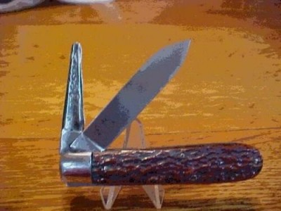

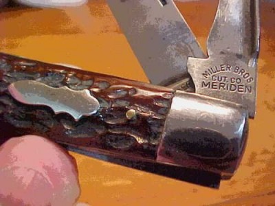

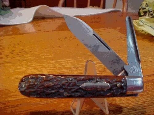

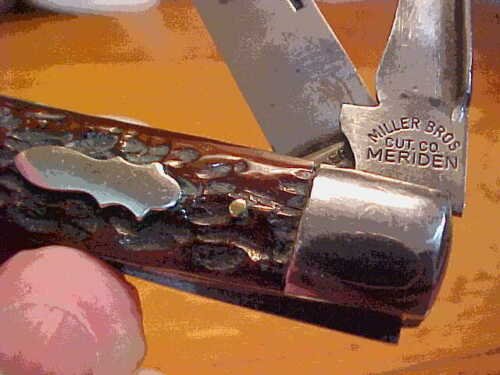

This one just sold $232.50!!
The entire knife is fake, not a real Miller in any way
