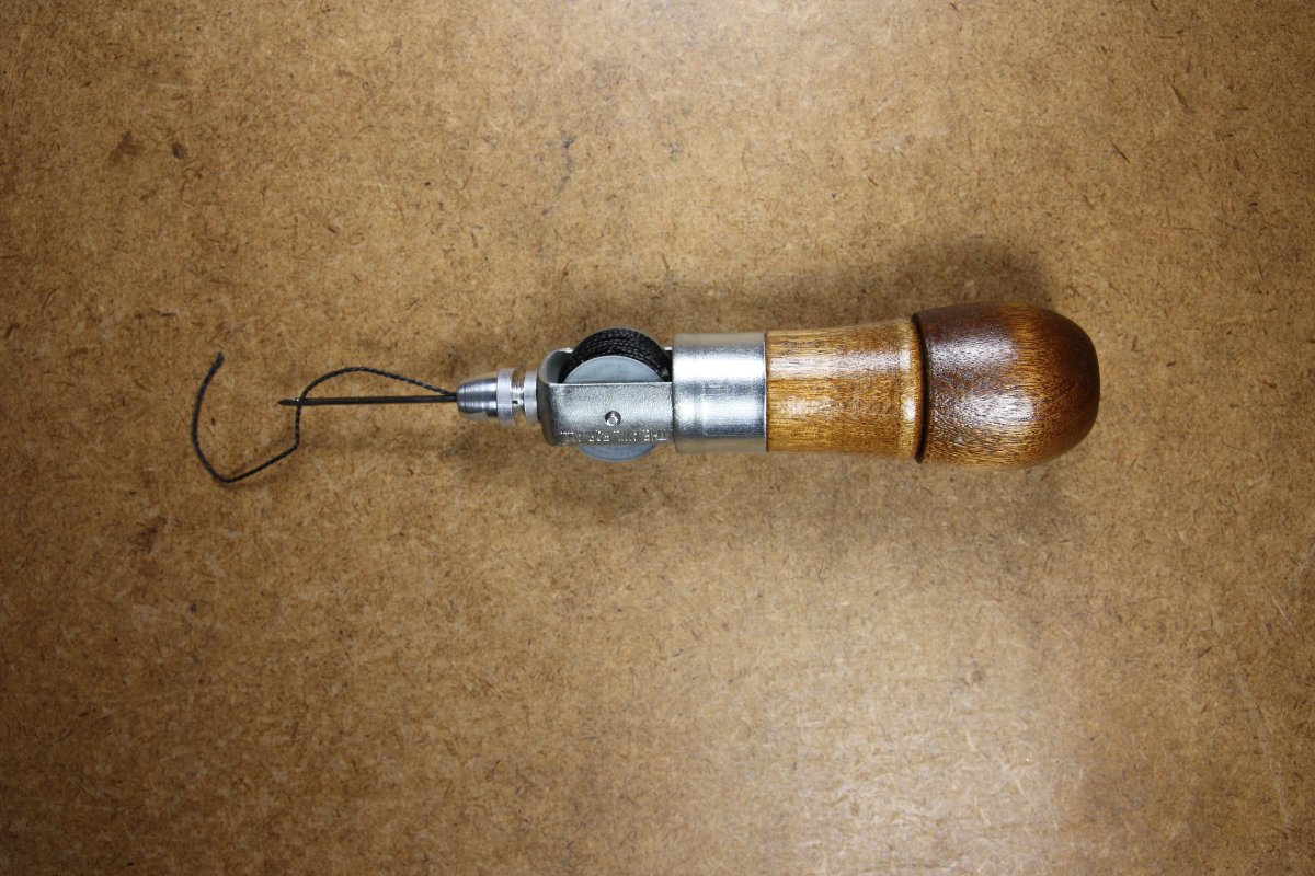

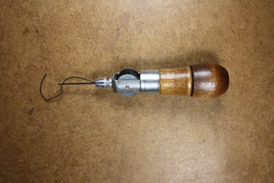

I agree, the sewing machine you mentioned may be capable of sewing leather, but only thin suedes, pigskin and elk. The leather you would require for a sheath would be much too heavy and would require a harness type stitcher. Hand sewing leather is not that difficult, but does require that a hole be pre punched with a very sharp awl that is perpendicular to the surface and evenly spaced between stitches. Those are the two things that affect the appearance of the finished product the most. The harness stitch is the much preferred method for strength, which is basically one long thread with a needle on each end which is "woven" back and forth alternating thru the pre punched holes. As an alternative, I have pictured a device most commonly called a "speedy stitcher" which can be purchased at many hobby type stores and even some hardware stores. It would do an acceptable job on leather, but the two requirements of having a pre punched hole evenly spaced would still need to be done before stitching with it. If the sheath you are looking for is not readily available, and making your own does not appeal to you, then your best bet may be having someone make one up to your specs.
