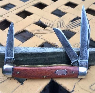

I have some Schrades where the shield is just a bit proud and some where it is flush. I am guessing that getting the shield flush was not a big deal for the fellows putting the knifes together. I do not have any Schrades where the shields sit overly proud, to my eye or touch.
The two on the left are flush, the two on the right are just a bit proud.
