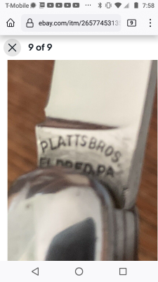

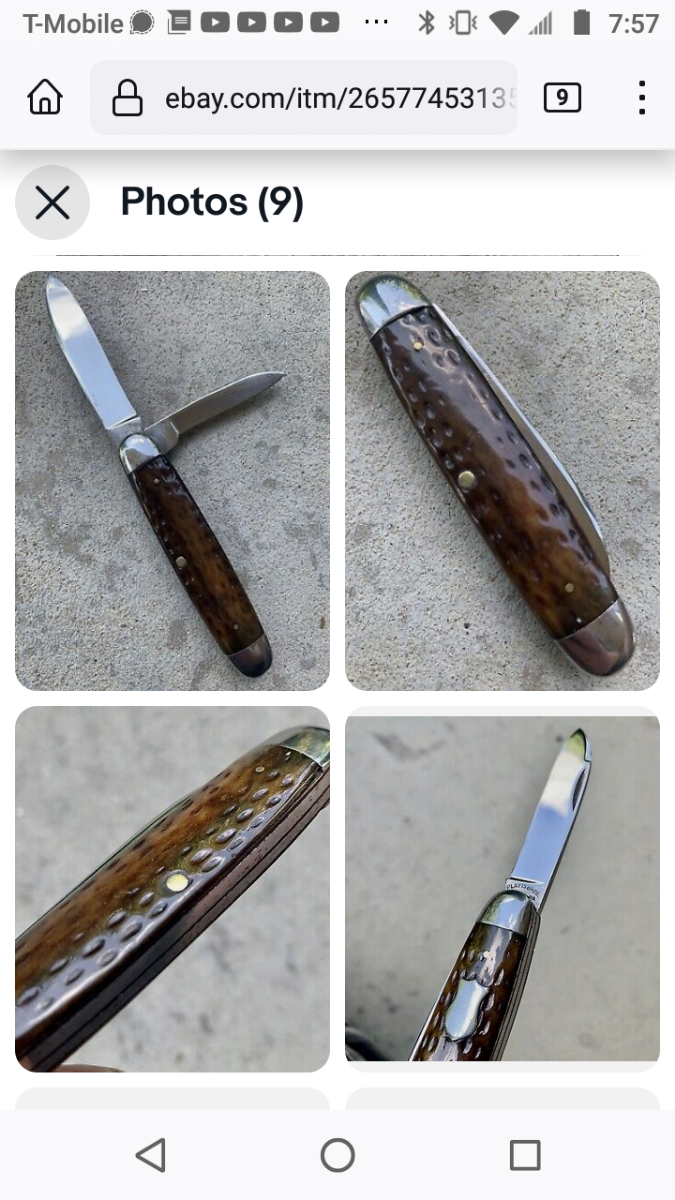

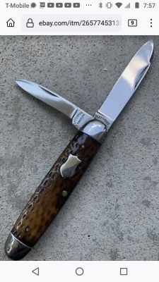

Thoughts on this one boys and girls, a friend bought it and just showed it to me.

I was watching that knife Mike. Two things,one out of my price range and I had no idea if it was legitimate??? It is a really good looking knife, to good almost??

Thanks Bill, I don’t like the look of it. Stamping looks new and I HATE buffed knives. They can hide a multitude of sins!!

I watched that one. Heavily buffed, and looks like a Challenge Cut Co jack. At least I have owned several Challenge cigar jacks identical to that knife.

I thought friends didn't let friends buy over buffed knives!! Man, I hate when they buff the bone!! I am suspicious too Mike, blade grinds do not look like early or perhaps any Platts I have handled. Of course what we think won't get his money back unless the seller is a really understanding person. I think he could probably get a nicer Platts knife for that kind of $$, even from Artie.

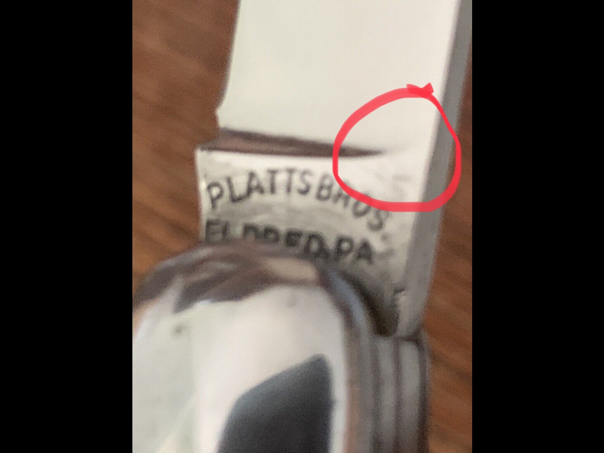

Letters look too round as well, but that is hard to tell from photos.

That shine to the bone is the result of buffing on a wheel. Somebody just buffed the whole knife, bone, bolsters and blades. May have been pocket worn, but a buffer wears bone down too.

Steve nailed it. Over buffed challenge frame, heavily buffed blades with bad stamps. If it was legit I wouldn’t entertain that price range with all the buffing.

Stamp is definitely not right,letters are rounded. ::td::

Grind line shoulder has the tell-tale curve up as it nears the spine, typical of a “shaved” tang.

I think that sums it up pretty good the round corners on the tang mark was the clincher for me. The book on counterfeit knives is also very helpful I still have a long way to go on learning what to look for and it’s nice to know I have a group of guys and girls with years of knowledge that are willing to share thanks again Pete
