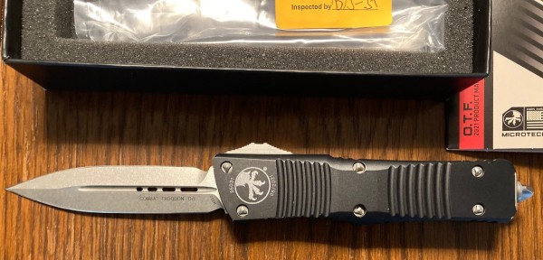

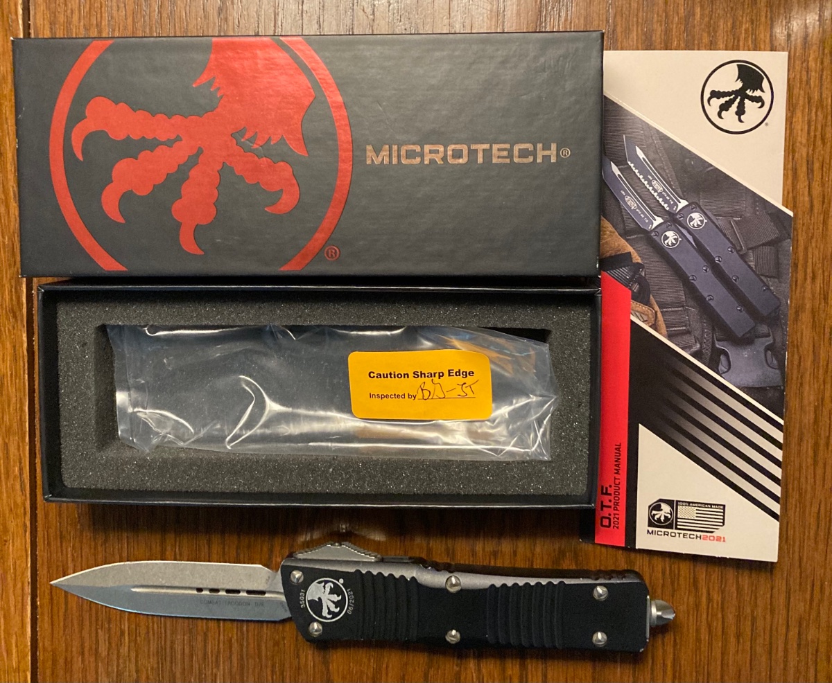

Just bought one used, though it appears brand new and the deploy/retract is so stiff I can't work it with one hand. Is this normal? Can it be mad easier to operate?

Should have posted pictures. I feel certain it's Microtech. Bought it from someone I have bought from before, retired military man, have no reason to doubt him

As it turns out after all my worry about the Troodon opening difficulty, the responses here and my son-in-law simply pushing with a stronger thumb than I have made it open and close with relative ease. I think it still needs oil and compressed air clean out and it will be working easily enough for my old arthritic hand to make it open.
