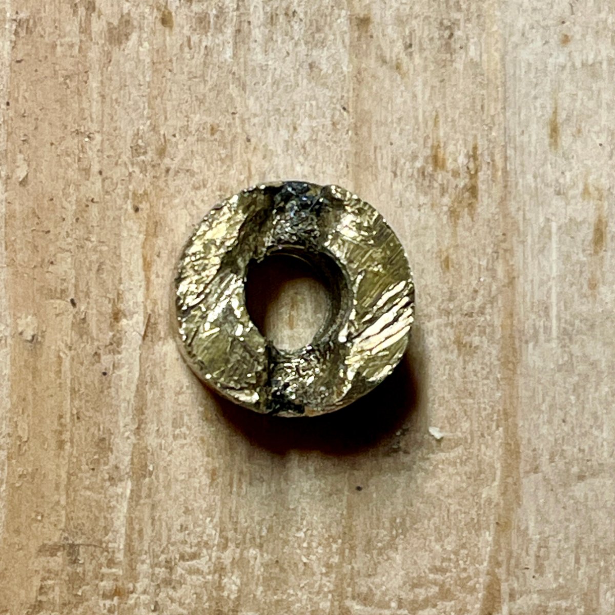

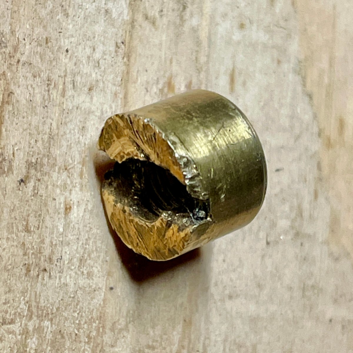

I then dis-assembled the handle to see what condition all the elements were in. The stag did have a little loose wobble in it. The brass tang nut was particularly stubborn, and I'm afraid I made quite a mess out of it getting it off. :oops:

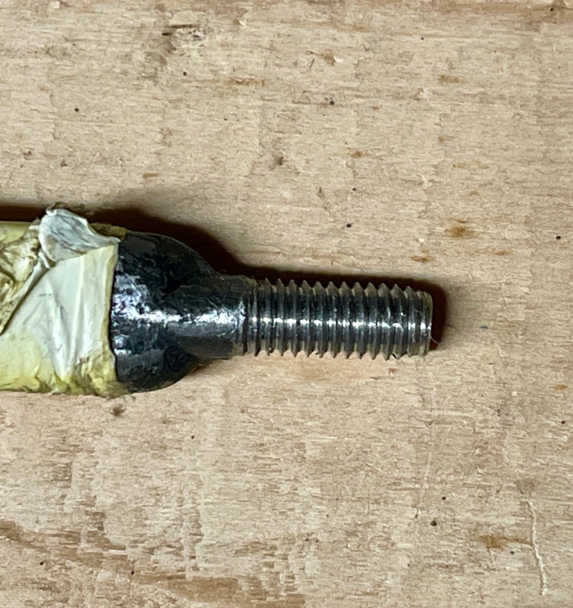

The threads also did encounter some damage while removing the tang nut. So I purchased a thread repair file, as well as a 10x32 die, and did some repair on it tonight which seems successful. :D
The original brass tang nut goes on nicely now. Unfortunately, the nut is a mess on the top side. I did order some tang nuts from Crazy Crow, but it seems like none of them are correct. So, that leaves me with either trying to repair the damaged brass tang nut (doubtful), or finding a replacement from a similar knife. Any thoughts? Suggestions? Advice? ::suspense::

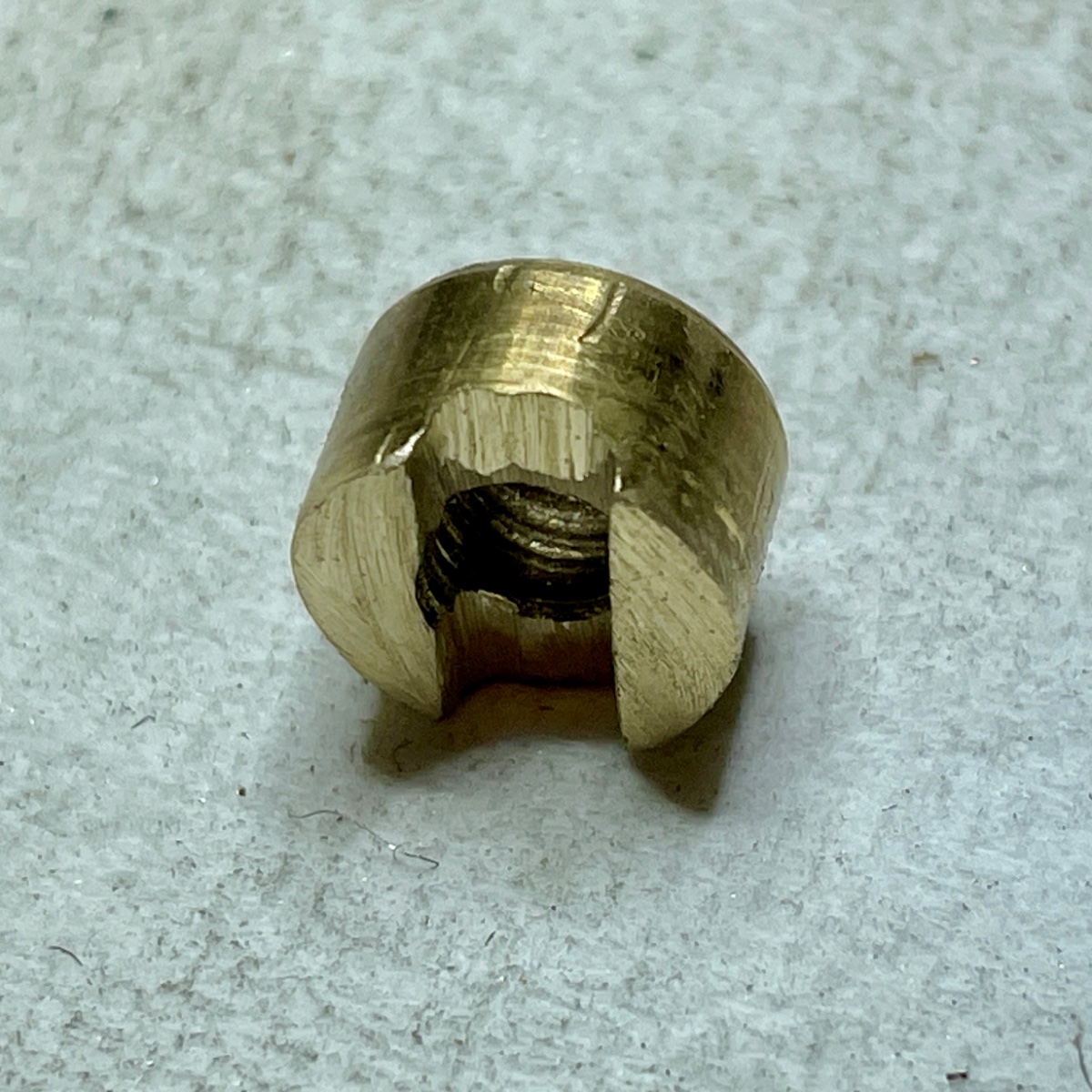

Pretty easy to reproduce if you have a friend with a lathe. You can make it by hand. Find some solid brass rod of the appropriate diameter, center punch it and drill a hole through the center. Then tap the hole and file the slot on the top. Use a split screwdriver to tighten. Good luck.

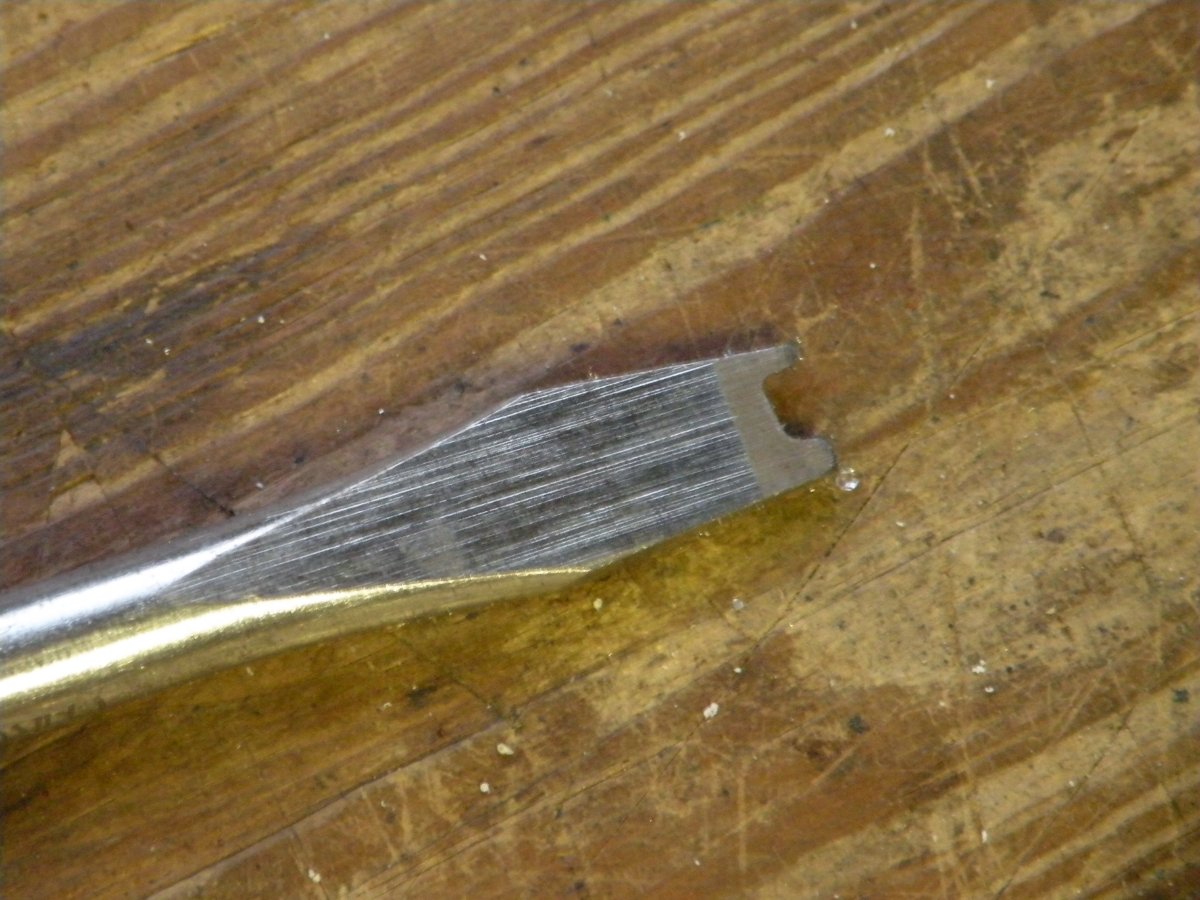

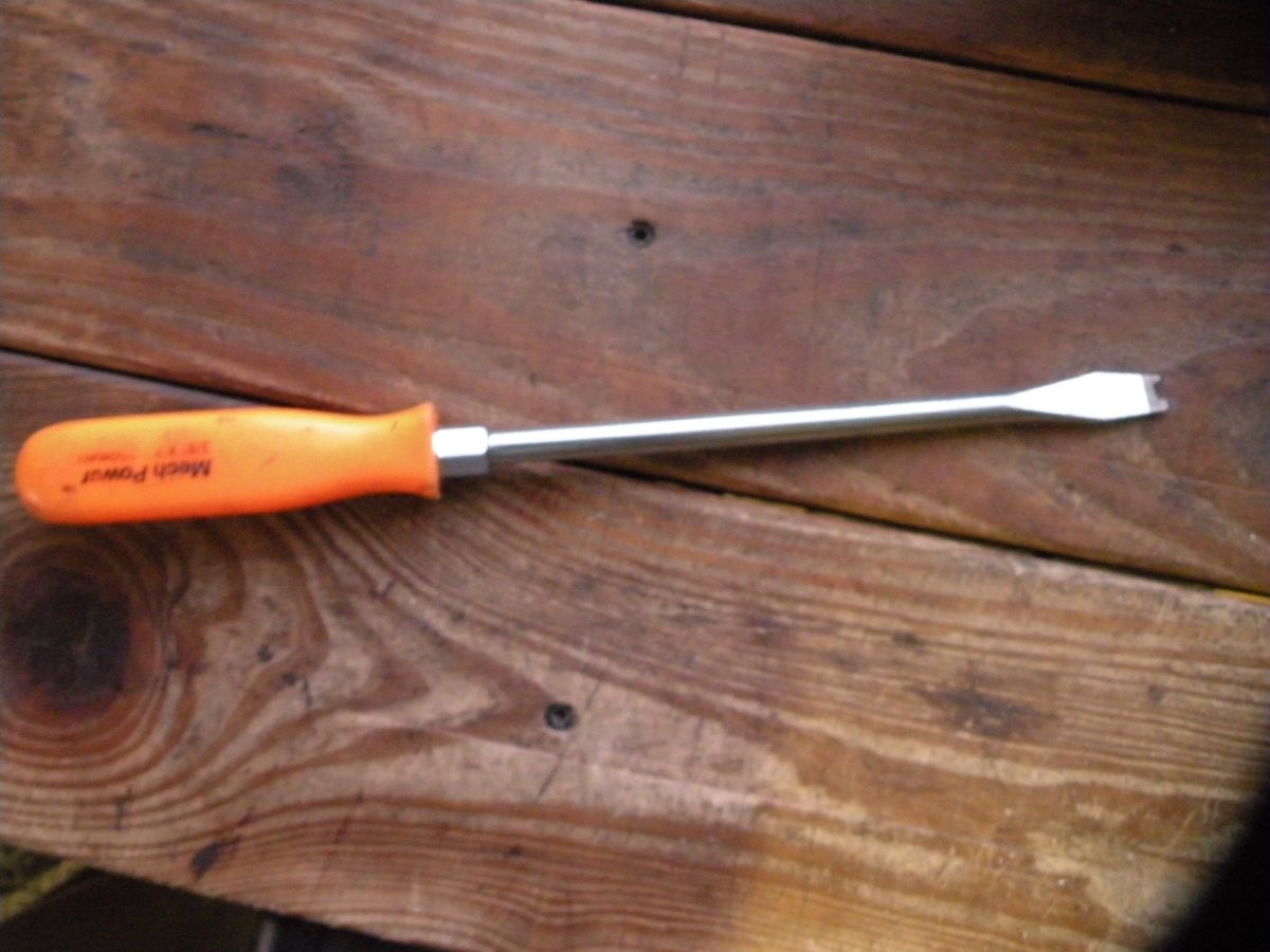

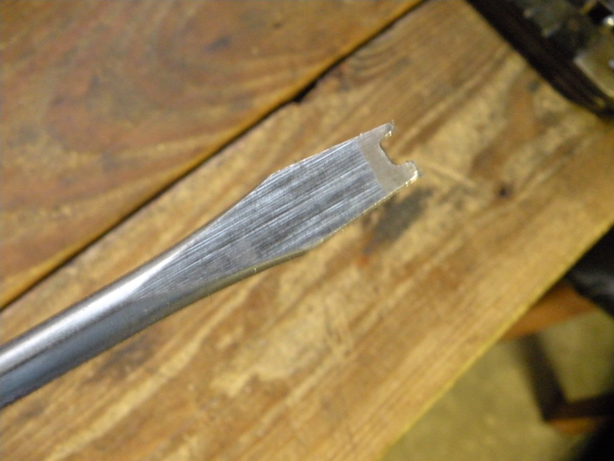

What you did to the nut could have been completely avoided by simply making and using the proper tool.
You can file the damaged end flat, and recut the slots, but it will have to be installed with the proper tool.

You might get away with cutting a slot in the other end and installing it upside down.

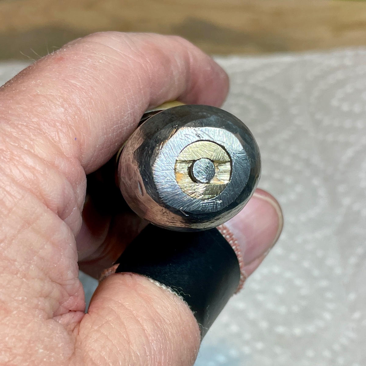

Please keep in mind this is my first knife restoration project EVER. Every bit of this was new to me. I did watch several YouTube videos by knife makers/sharpeners, which gave me some courage to undertake it. I tried making a tang nut tool but failed on that (chisel not a good chouce! LoL).
I got out the dremel last night and tried to clean up that nut. Turned out okay, I think. But it is shorter now.

Others mentioned this too, but its about finding the right diameter brass round. If its common like 1/2", 3/8ths, .375 and others in mm's then you just buy the brass round stock for $5-10, cut off a slice, drill, tap and groove. Sounds easy but takes tools, you already seem to like to tinker anyway so there you go.

You may be able to space it out with a washer (or two) between the tang nut and bottom of the hole in the pommel cap. Not an ideal solution, but no one would know unless they took it apart.
It would be easy enough to make a replacement for the original nut, but now one original dimension (the length) is missing. It could still be figured out pretty well by reverse engineering the depth of the hole in the pommel cap.

Fisher Cat wrote: ↑Fri Jan 12, 2024 7:59 pm You may be able to space it out with a washer (or two) between the tang nut and bottom of the hole in the pommel cap. Not an ideal solution, but no one would know unless they took it apart.
My thought EXACTLY! :D

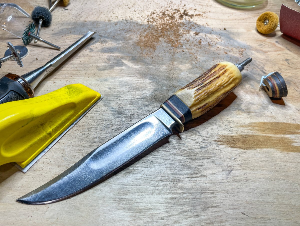

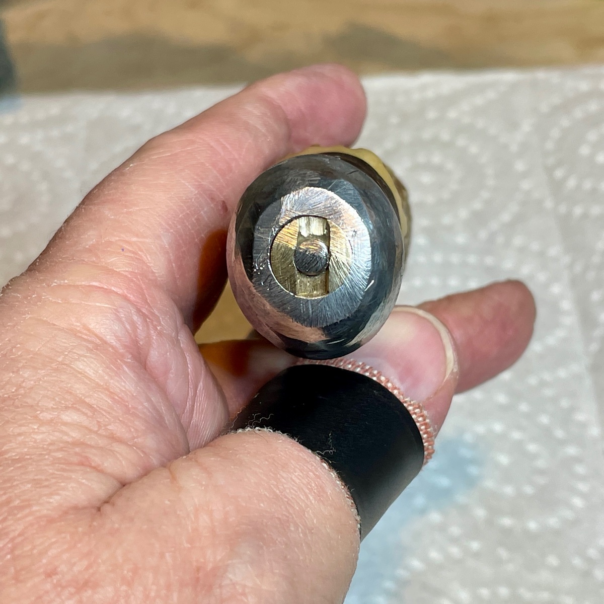

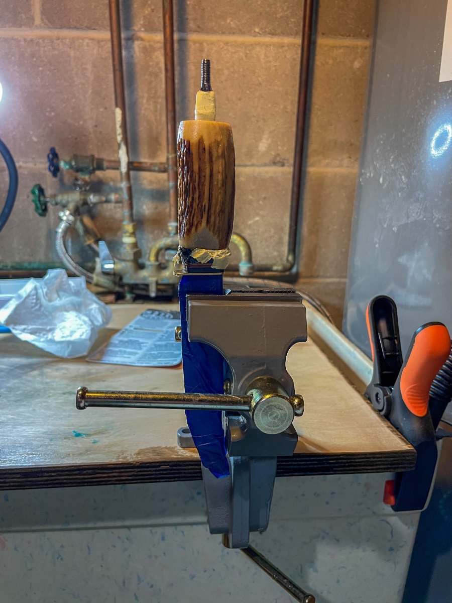

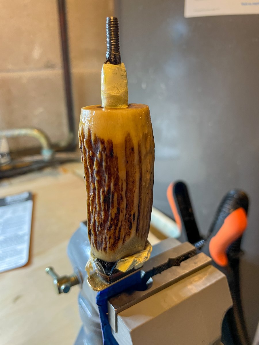

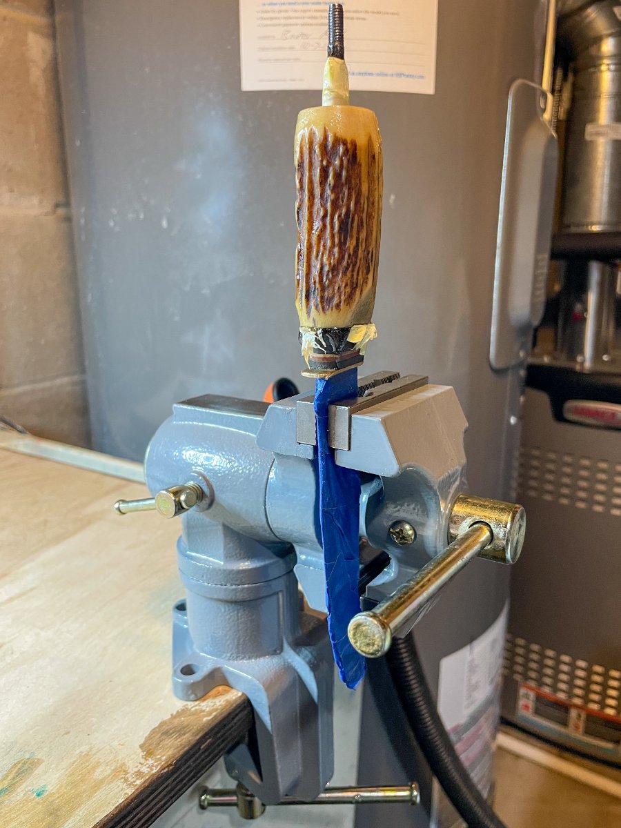

Took the plunge tonight and poured epoxy into the stag fitted to the tang handle. My little work area is downstairs, a board placed atop of the laundry tub. Had to run out to Harbor Freight to buy a clamp-on vice as I couldn't come up with a way to stabilize it otherwise. Found a nice little vice for $25. Gotta love HF.
Anyway, it was a bit of a panic. Thought I could use a syringe to suck up the epoxy and then plunge it down the stag between the tang handle. Epoxy mixed, and all of the sudden that didn't work! O boy, what now! ::dang:: So I quick pulled the stag off, taped up one end, and then fed as much epoxy down into it as I could. Then I flipped it over and quick fitted it to the tang handle. ::paranoid:: And, then I tried to carefully feed more epoxy into the small open areas at the top of the stag where the tang comes out. It was a panic. :lol:
I did tape the tang handle with plumbers tape, as well as the flat between the stag and the leather atop the hand guard. HOPEFULLY, after the epoxy is set I can get the stag off again to clean things up before final assembly. That epoxy pretty much got on everything. I'll have to clean out the tang threads again, and clean up the hand guard, and the leather padding atop the hand guard. More work to do. ::groove::

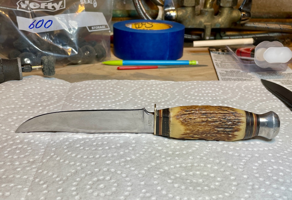

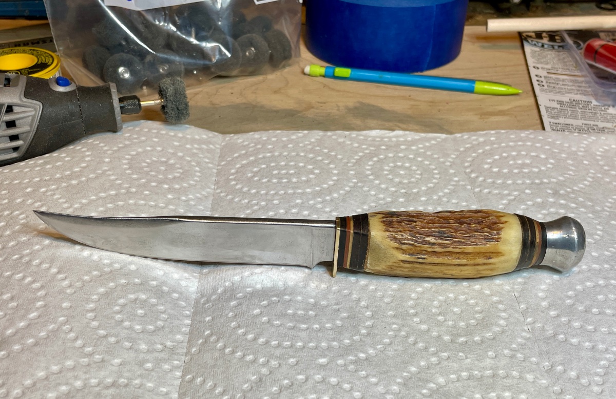

Today I finished up the G.C. Company hunting knife. After yesterday's epoxy pour to build a new fit for the stag handle, I needed to remove the stag and clean up leftover epoxy. It was a challenge but I finally prevailed with the removal, and then I cleaned up all the bits of epoxy that had dripped places we don't want it.
I then reinstalled the stag, and then worked on installing the leather padding slices. I used contact cement on each layer. Then, I installed the aluminum butt, and assessed how much I would need to compensate for the now shorter tang nut.
I had some small washers that would serve as spacers but they were too large a diameter to fit. So, I put all the washers on a small bolt and tightened them up good, then I took it to the 1x30 belt sander and used an 80 grit belt to reduce their size. That finished, I was able to get 3 or 4 of them installed before the tang nut. I then threaded on the modified tang nut and got it to a good tight fit. That left about 1/16 inch above the butt end, and a quick trip back to the belt sander brought it nice and even with the butt of the knife.
I almost can't believe I'm finally done. This project took me about a month from start to finish. I needed to watch several YouTube how-to videos and purchase a couple new tools. I took my time, and with some trepidation, only moved to a next step when I was ready for it. My boyhood hunting knife is back into a beautiful condition.

A suggestion for next time you are using epoxy in a situation like this. When I'm afraid I will get epoxy on places where I don't want it, like on stag or on the tang threads, I coat the area with a coat of Vaseline. It doesn't have to be a super thick coat, but you don't want it too thin either.
Keep the Vaseline off of the area where you want the epoxy stick. If you do get Vaseline on areas where you want the epoxy to stick, just wipe it off with isopropyl alcohol.
This method has saved me hours of cleanup work and still gives a good bond where the epoxy is applied.
