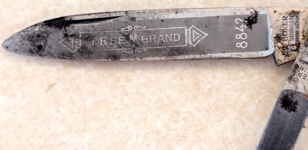

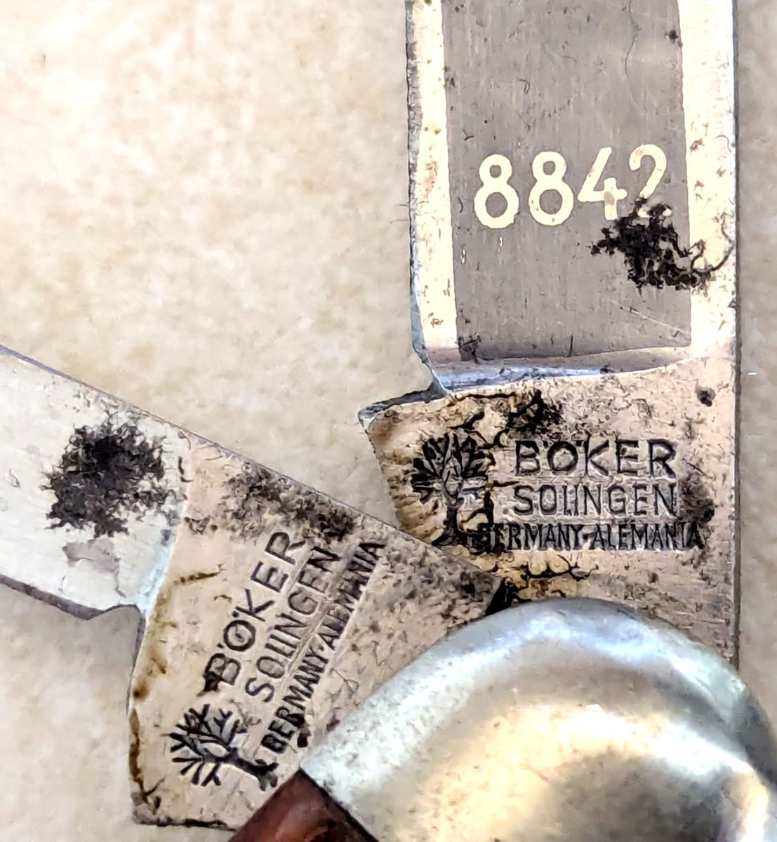

Is there any method that can remove rust stains as seen in the images below without doing any damage? Can a Boker knife be returned to be restored? Thanks.

I use a #2 pencil, the lead removes the rust/grime but not the etch. I would definitely give it the #2 Pencil Spa treatment.

Pencil lead will remove light surface rust as well or better than anything, in my experience. I like those “carpenter’s pencils” for cleaning knives - they have a wider lead than a regular pencil. Although pencil lead will improve things it will not remove rust pitting or “spidering” that your knife appears to have.
I know of nothing which will remove pitting without damaging the etch. Removing any pitting requires removing metal.

I also would use a carpenters pencil. Whatever you do, be aware the rust particles are very abrasive. Be careful not to rub them in. You want to knock it off and let it fall away. Blow it off with compressed air. Then oil and a rag.
The pitting will still be there, but the etch will be preserved. The knife will still be “honest”
