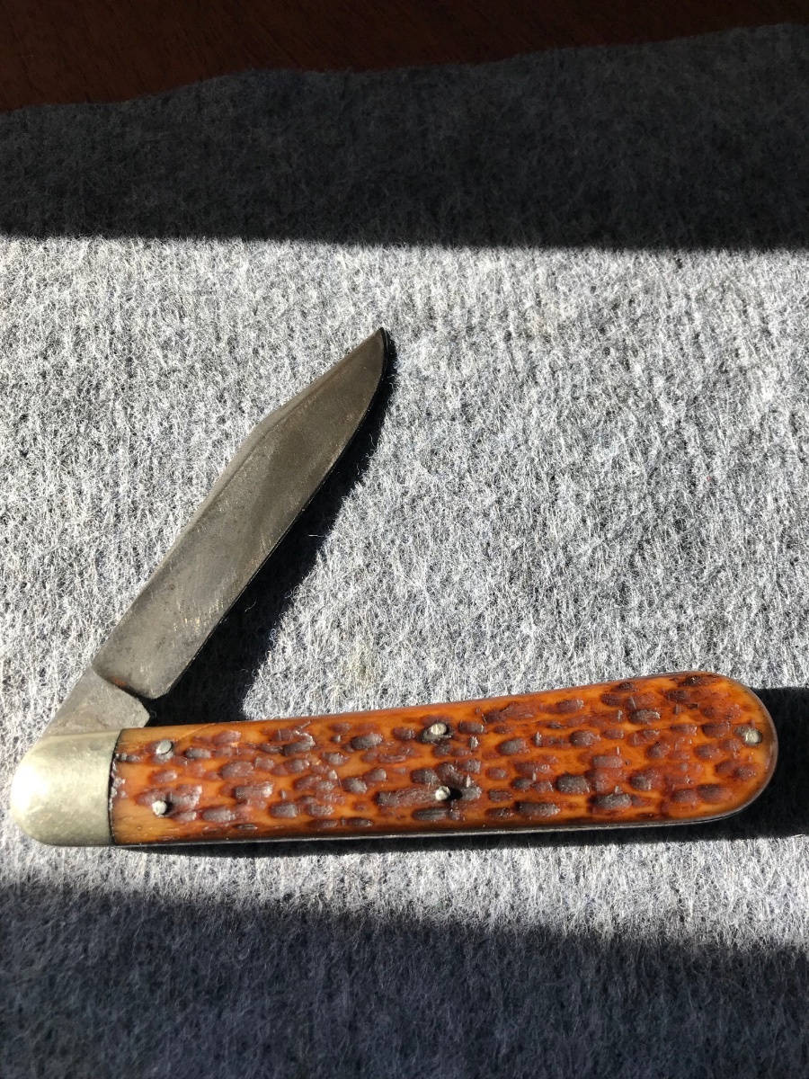

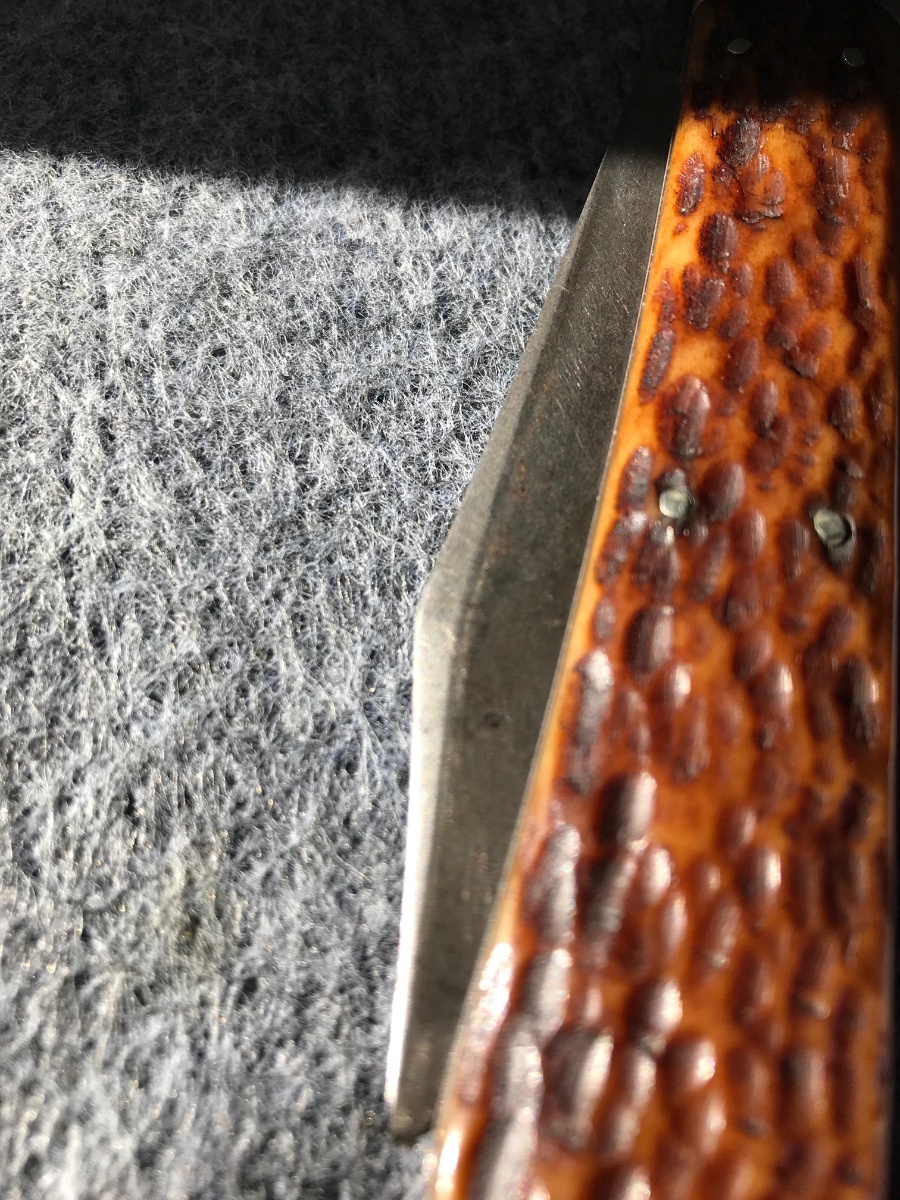

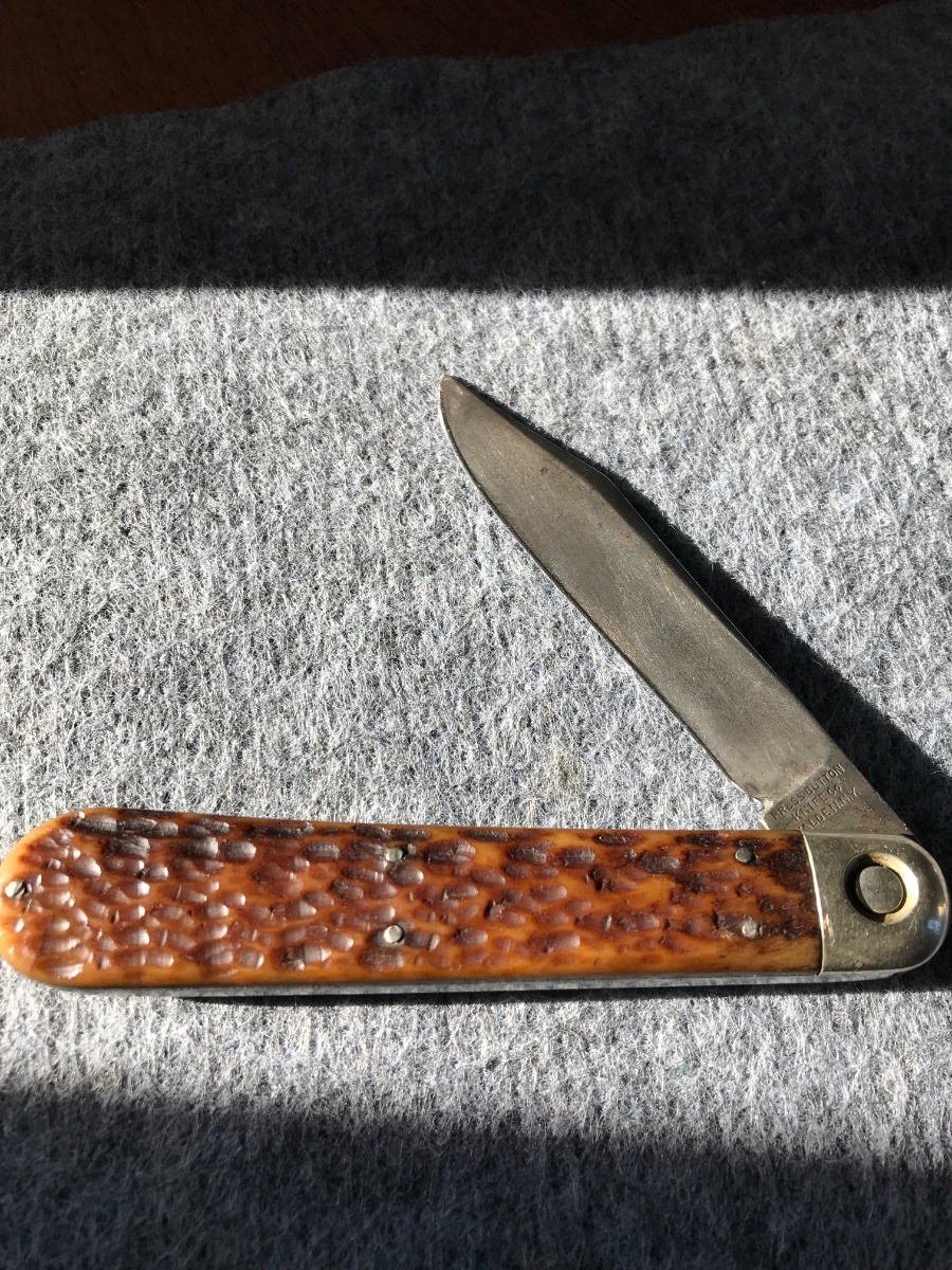

May try to send it to someone for repairs. This is my second one I have owned. The first one was perfect even had the beautiful etch. Sold it was stupid. Harold

The bottom of the blade tang just needs a LITTLE material removed. There may be a raised area where it meets the back spring. That is what you file/sand/ grind down a BIT. PIECE OF CAKE!

That may work on regular folders but will wreck an old spring knife ….Do not do this ! There’s only 2 ways to properly correct the peek and both involve taking it partially apart….. I’ve seen some regrind the top off the blade to get that tip below the liners but …. Not the preferred method.

Thanks for looking at my old knife, I knew about the blade from pictures before purchasing it. So don’t feel to bad. I contacted a couple really good repairmen one was off with some health issues the other one was booked, but I can get in line. I enjoy the older knives, the history. The old manufactures. Harold

Very cool blade there Harold! Thanks for sharing it. Glad you found a coupla guys that can work on it. I’m sure it can be put in proper order. (There are apparently, two ways to fix it.)stockman wrote: ↑Fri Nov 22, 2024 7:13 pm Thanks for looking at my old knife, I knew about the blade from pictures before purchasing it. So don’t feel to bad. I contacted a couple really good repairmen one was off with some health issues the other one was booked, but I can get in line. I enjoy the older knives, the history. The old manufactures. Harold
If you remember, after you get it squared away, let us know details of the repair—like to know the techniques they use to remedy that situation. The more you know, right?

If I do get it repaired I will post it again. It is still good as is. Not my first auto with blade peek.

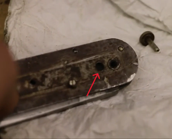

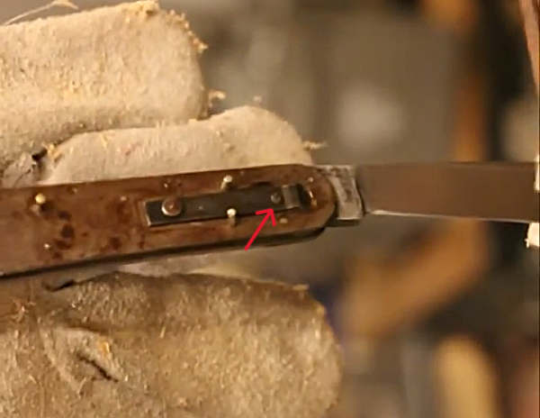

Here are some photos to show the inner workings of a Press Button knife.
The first pic shows the sear spring. It's located under the back handle scale. The red arrow is pointing to the sear pin that holds the blade in the open and closed positions.
The second pic shows the back side liner with the sear removed. The red arrow points to the sear hole.
The third pic shows the blade and the two holes I mentioned earlier.

Killgar, good information, I'm not going to mess with this knife myself. may leave it as is. If it is repaired on my part I will send it out.

Cheers again, my man! These pics of the internals are great!Killgar wrote: ↑Sat Nov 23, 2024 7:34 am Happy to be of service.
