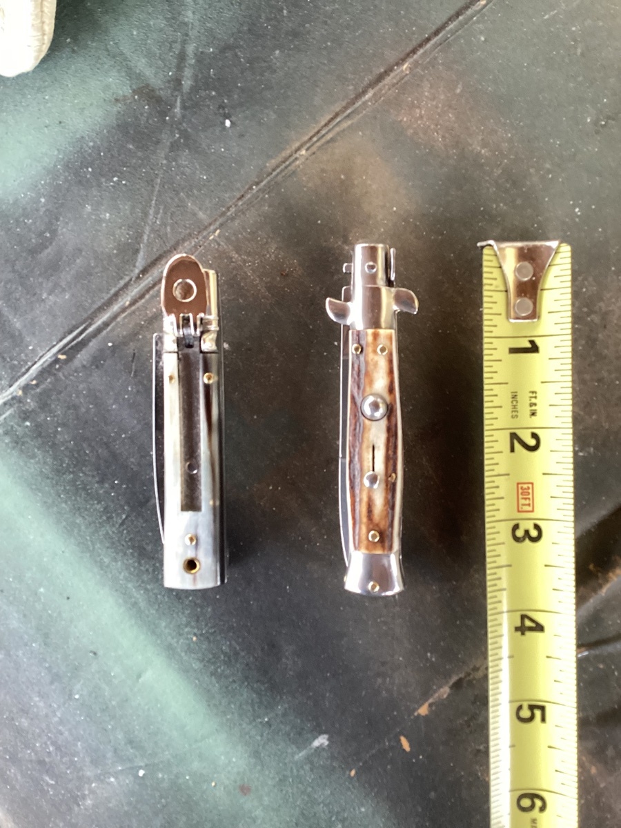

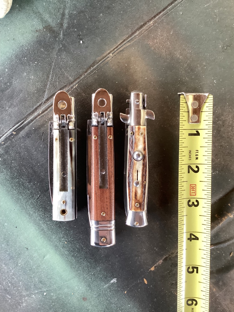

First observations,OOTB: With pics: My 6” Campolin, and 7.75” AKC Slimline are included, for size comparison.
1.) Looks good coming OOTB. It’s a nice bit of stag, not too gnarly, but nice, well placed scales, chunky, and not smooth beveled, into the bolsters. Overall, pleasing, and comfortable in hand.
2.) The blade is well centered when closed. And fit and finish is good to almost very good.
I say almost because the F&F is nowhere near the F&F of the Campolin I have. ( The little AGA is a much more solid feeling knife, with an explosive open—no joke, it kicks hard! And locks TIGHT.)

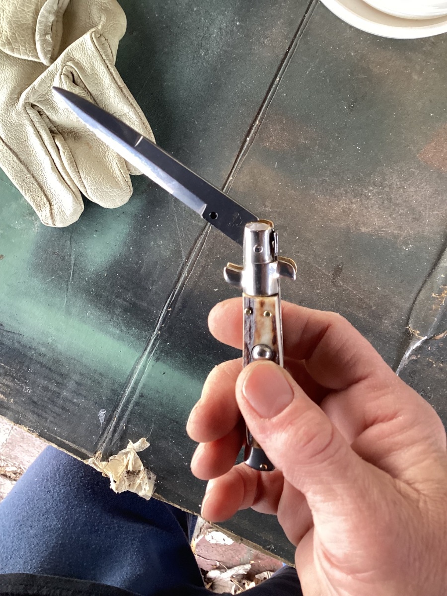

Not so with the new DM. The first few openings were marred by a coupla failures to fire. Leaving the blade caught on the pick lock mechanism. Like this.
Pressing the release button more firmly seems to take care of this issue, and it fires normally, but doesn’t lock up as tightly as my other autos. But it does lockup, with no wobble or play

Holding the stiletto firmly in the hand when opening will insure complete deployment.

One word- lubrication.
Lubrication can be an Italian switchblades best friend. Lubing the pivot might help with producing a complete opening, and putting a little white lithium grease in the blade catch hole can also make firing the knife easier (I learned that from Bill DeShivs :wink: ).
You might also look between the liners to see if the spring is rubbing on one of them during firing (rub marks). If it is, a little oil on the spring where it's rubbing can improve firing.
