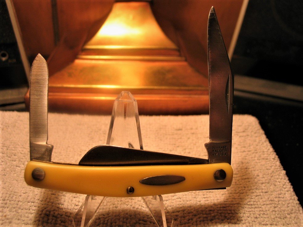

TRiver, I have a Walden 835Y that has celluloid and pinned pivots. Here is a picture of it for comparison purposes. Thanks for the info!

Nice knife and nice pic! ::tu:: Set your alarm to check it at least twice a day for gassing. Those 835Ys are some of the most notorious.

I know what you mean. So far so good on this one. It's in a Glass display box, and has been good for about 7 years now... Did they ever do any with Delrin and pinned pivots? This one really looks like delrin. I need to do the smell test I guess..
