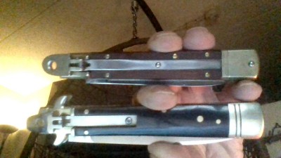

I'm way late to this party, and my following information was info I read, but, it claimed that if the rivet in the middle of the metal strip that runs down from the lever on the front side of the knife is a fixed rivet, then the knife is genuine, but if it's a screw, the knife is a clone. For what it's worth!
I know for a fact that the knife on top with the RIVET in the metal strip is the genuine article, since it was purchased in Germany 35 years ago, and the knife on the bottom with the SCREW in the metal strip I know for a fact is a clone, since I purchased it from DHGate.com(Chinese site)about 1 year ago. If you click-on the pic it will expand so you can see it better!
