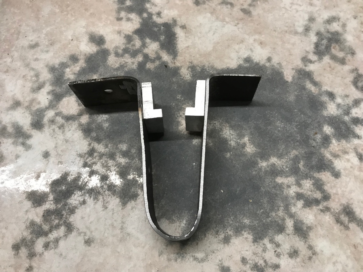

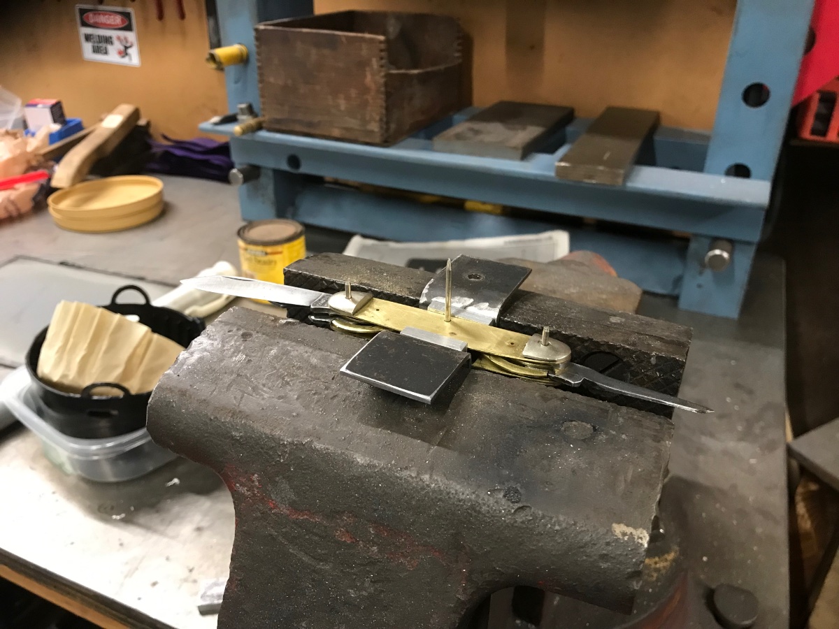

I made a spring tool that Dale has shone . It’s great on a Camillus , sure it will work for other type knives.

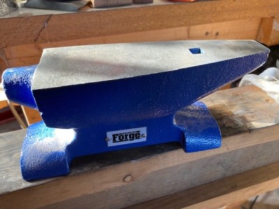

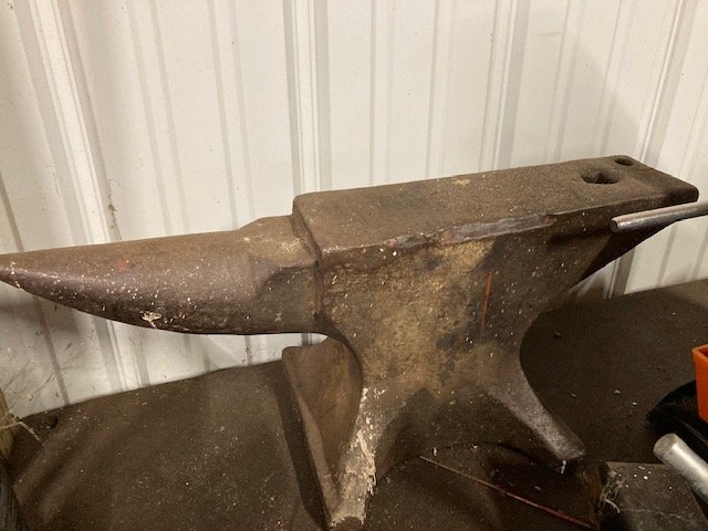

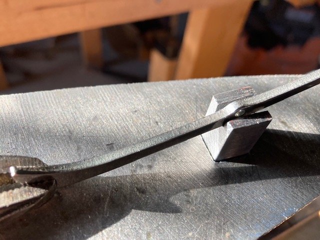

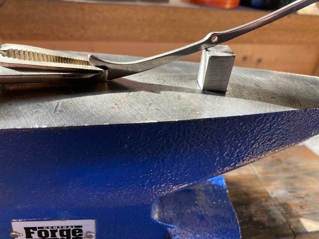

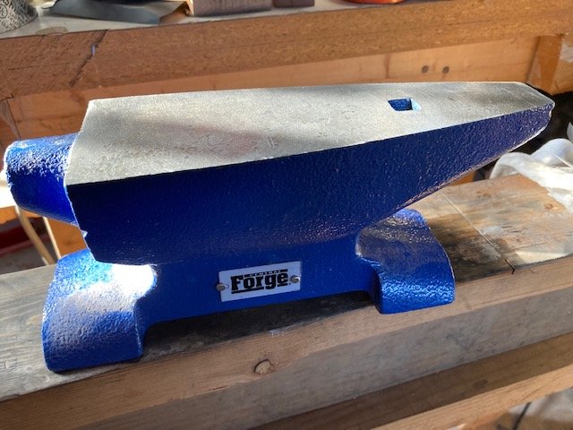

I have been using my dad's old anvil we used for equipment repair about 200 pounds, But I wanted something I could use on my small knife work bench. I purchased this small 15-pound anvil. It is easy to move around. I also made a small insert to hold knife springs as I strike them to add tension. Just thought I would share some photos.

Ingenious idea.Nev52 wrote: ↑Wed Feb 23, 2022 11:48 pm I have been using my dad's old anvil we used for equipment repair about 200 pounds, But I wanted something I could use on my small knife work bench. I purchased this small 15-pound anvil. It is easy to move around. I also made a small insert to hold knife springs as I strike them to add tension. Just thought I would share some photos.

I’ve got a similar Forge anvil (not sure if it’s the 15 pounder). I’ve been using it for a few years and it’s still working well. I like your fixture for holding springs, very cool!Nev52 wrote: ↑Wed Feb 23, 2022 11:48 pm I have been using my dad's old anvil we used for equipment repair about 200 pounds, But I wanted something I could use on my small knife work bench. I purchased this small 15-pound anvil. It is easy to move around. I also made a small insert to hold knife springs as I strike them to add tension. Just thought I would share some photos.

Thanks Jeff,
I really like this small anvil. I was a little apprehensive at first when I compared it to my old anvil but for small work it seems great. I am glad yours has lasted so long now I feel better about the purchase.

Good thinking!
I like that little hardy you made for your small anvil.

Thanks Mike.
I got tired of chasing the springs across the shop floor.
The hardy holds them in place

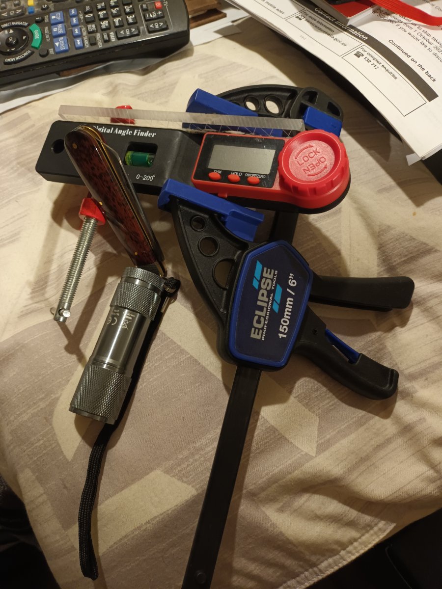

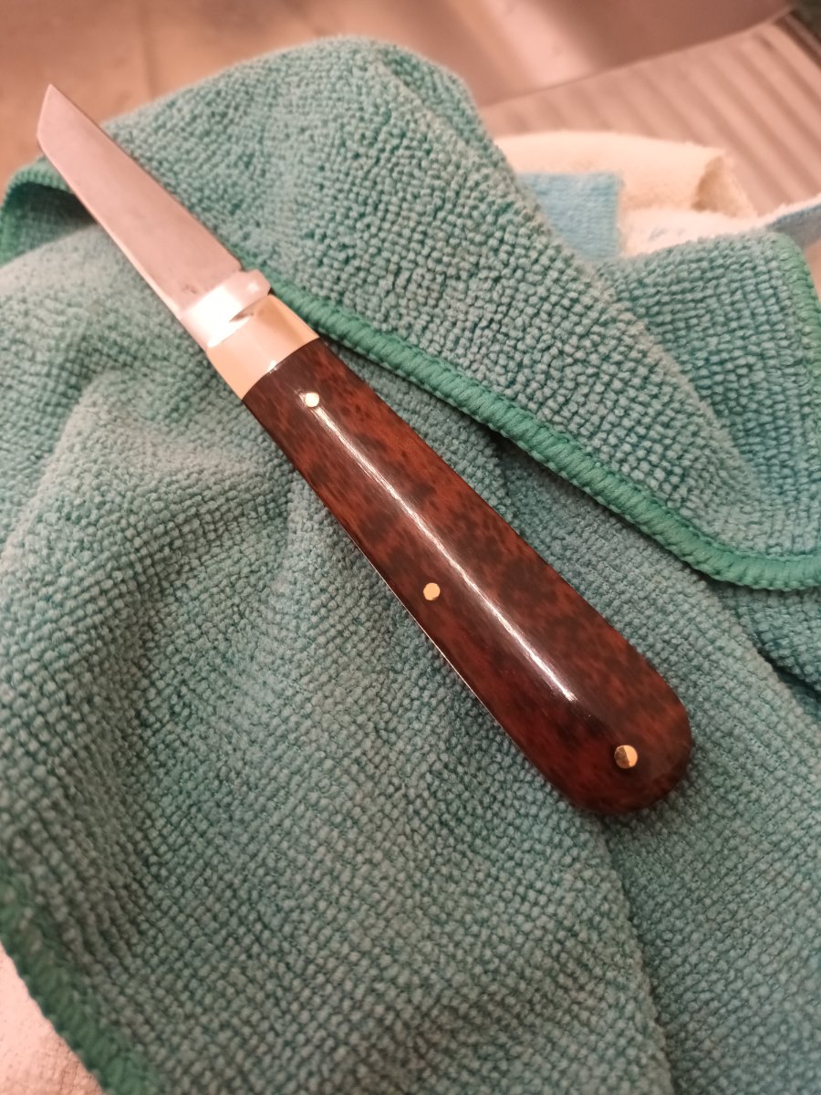

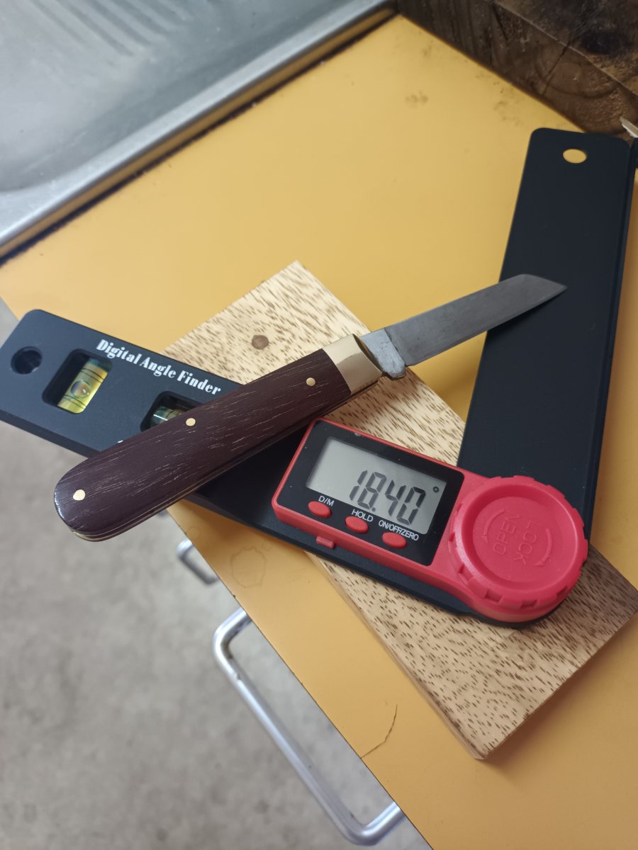

Working on a project, thought the tool thread needed a boot along.

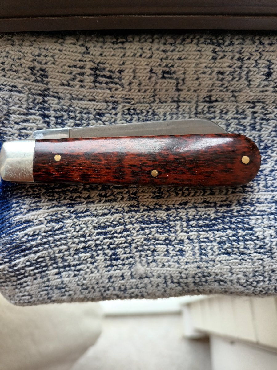

Here is a better photo. It as an A.Wright Lambsfoot with snakewood covers. Glad you like it, and i like your new Avatar.

Very nice knife

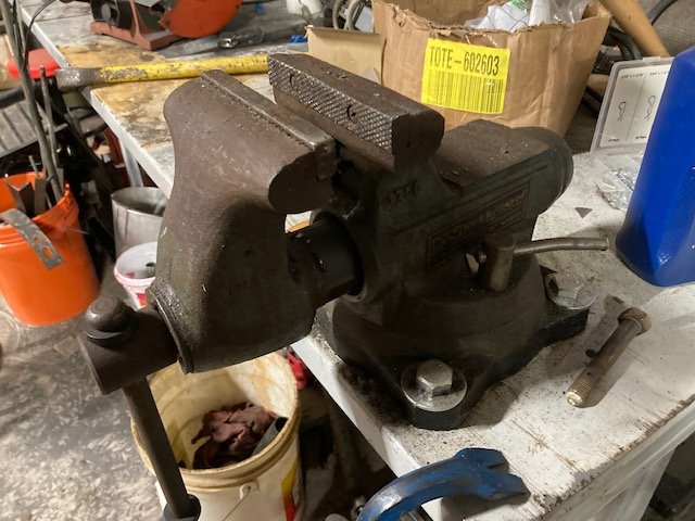

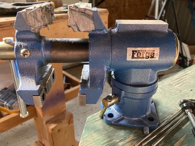

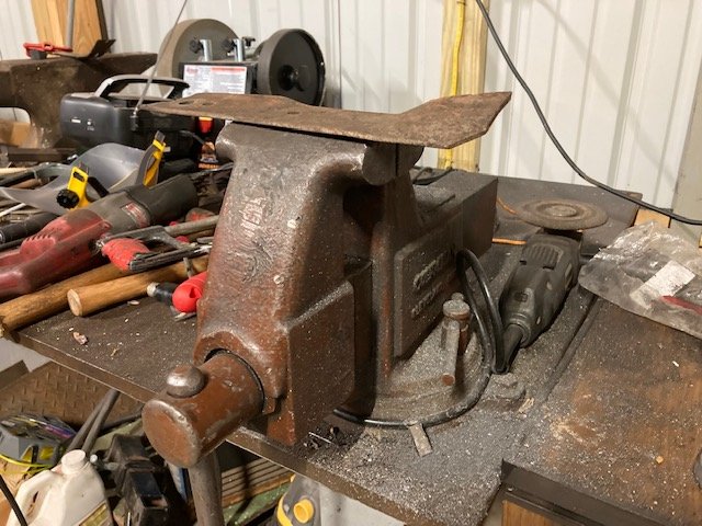

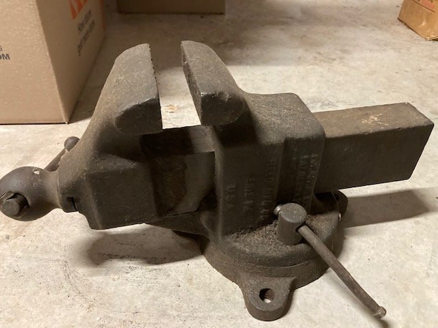

Here are my Vises. I use the big ones for heavy things. 1 is for taking the knife apart. The other big vise I have on my welding table. I use it to make springs out of lawn mower blades. The one on the floor was my dad's when I get the house built it will go on my gun smithing bench. The small vise is a cheap harbor freight. Believe it or not it is a great knife vise.
I put g10 on the top jaws so it won't scratch the knife. In my opinion it is a perfect size for pocket knife repair. Just thought I would share.

Great collection of vices. Good that you have your dads old vice, and some of those cheaper vices do a good job. The vice is one of the great inventions in the tool industry in my opinion, the tasks that can be achieved with a vice are amazing, work shops would be poorer without them.Nev52 wrote: ↑Sun May 01, 2022 12:37 pm Here are my Vises. I use the big ones for heavy things. 1 is for taking the knife apart. The other big vise I have on my welding table. I use it to make springs out of lawn mower blades. The one on the floor was my dad's when I get the house built it will go on my gun smithing bench. The small vise is a cheap harbor freight. Believe it or not it is a great knife vise.I put g10 on the top jaws so it won't scratch the knife. In my opinion it is a perfect size for pocket knife repair. Just thought I would share.
I have been trying in vain to find a nice antique American-made one locally--most got sold for scrap metal. Those that didn't ended up in antiques store windows for stupid prices.
Making a trip to Harbor Freight soon, and I think I'll pick one of those up. I've been using the anvil surface on the big farm shop vise.
I have a rather small vise missing the jaw pads that was my great-Granddad's. My plan is to tap and drill for new bolts (as well as extract the broken screws that are still holding on a damaged jaw pad on one side) and use G-10 or similar to make the pads.

Thanks, Cudgee
You can never have too many vices.

I think you will like the Harbor Freight Vise. It is good for knife work. In my opinion

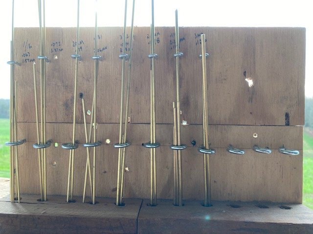

I took some junk wood and made a pin stockholder. Not pretty but it works for now.

Nev,
I love the jig you made to hold knife springs, very good thinking! I may have to copy your idea!

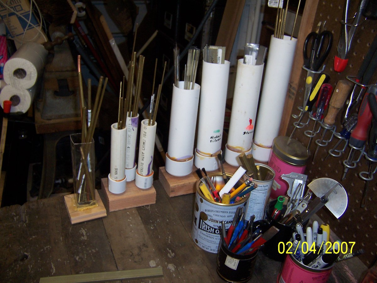

Your pin stock holder is also a good idea. The more pin stock you get the harder it is to manage it so for the sizes I use most frequently I have organized in PVC pipe.
This is a very old picture about 15 years ago when I didn't have a lot of pin stock. I will try to get a picture of my new pin stockholder. I do pre-make make a lot of pins and keep those in plastic containers by size. I also have a lot of premade pins I purchased when Schrade and Camillus went out of business. But the actual pin stock itself is kind of a pain to manage because you want to keep it somewhat organized so you don't spend half your time looking for the right size pin stock!
This is what I used to hold pin stock15 years ago. I will try and remember to get a picture of my current storage method.
