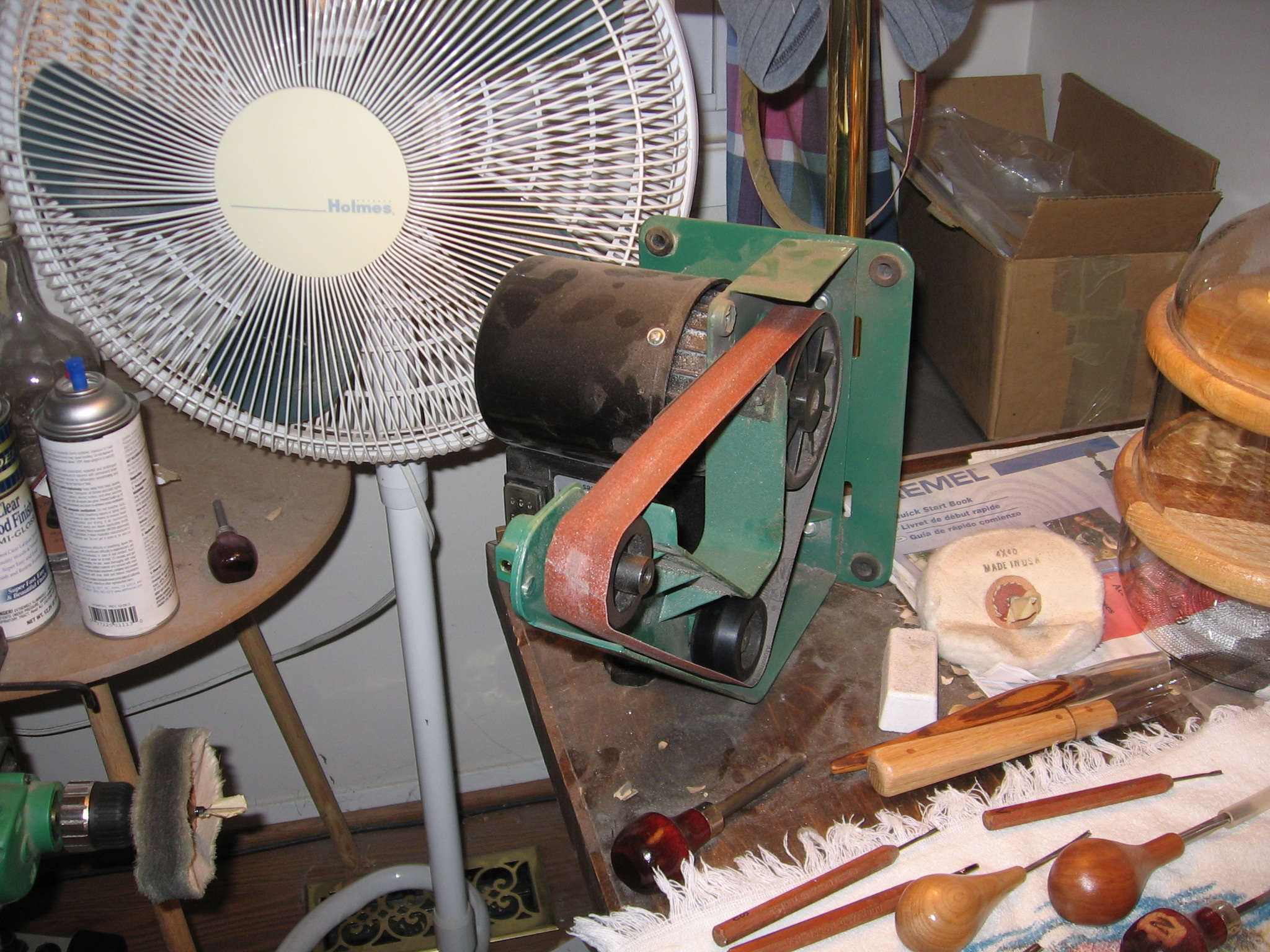

I have a Delta 1"x30" belt sander with a disk on it. I have 240 grit belt on it now. Works good. It looks similar to the ones that HF sells. I use and old, antique ,motorized grinding wheel to rough out before using the Delta. I have a HF dust collector for a tablesaw that works good. I got a HF log splitter a couple of years ago. It leaked hydrolic fluid after one use so I shipped it back for a full refund.
