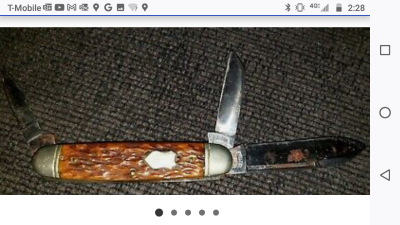

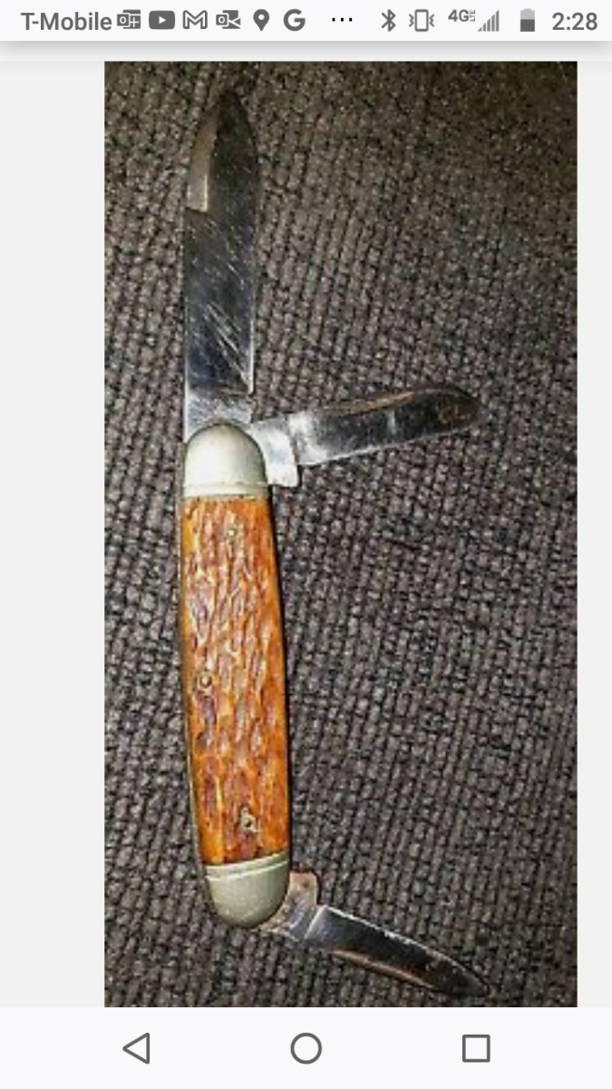

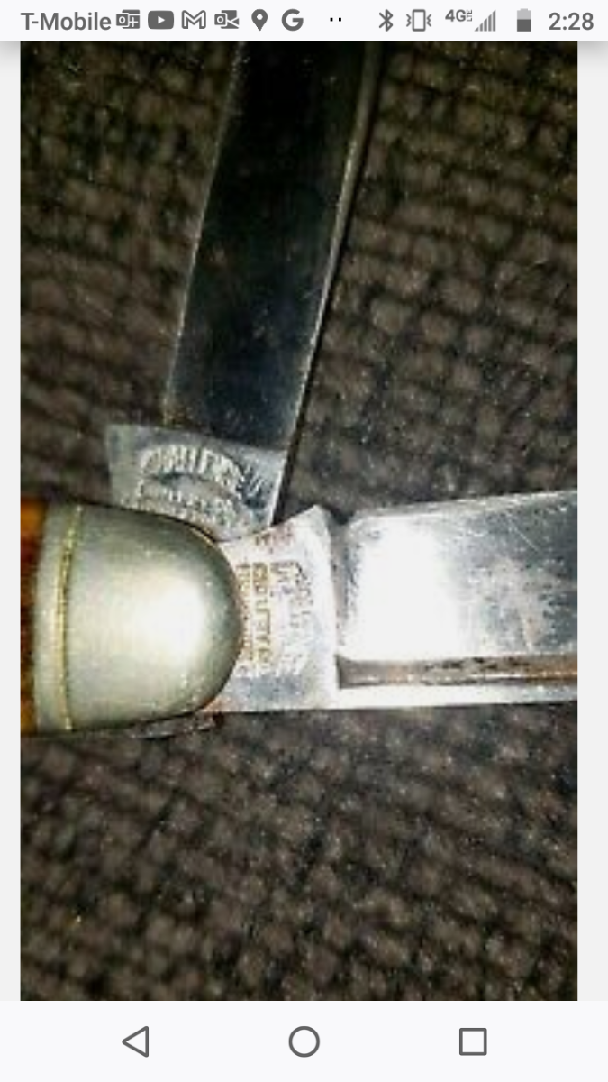

Please forgive my attempt to attach a link, I’m new to this iPad. But I just wanted an opinion on this Challenge. I’m personally not liking the fit around the shield and the look of the stamps. But the style and the long pull looks typical Challenge. However I don’t want go so far as to insult what might be a legitimate knife.

That looks legit to me. The bone looks typical Challenge and the shield is uniquely identical to what they used on their cattle knives as are the blades. Stamps are kind of a hard thing to discern when you're dealing with bright lights. All kinds of shadows and bright spots tend to pop up. I'd read the knife first.

The stamps do look strange to me, but the tangs definitely look full and unshaved. Nothing else about the knife looks counterfeit to me, just something odd about the stamps.

My pleasure Froe! Also keep in mind that tangs tend to acquire some pitting due to their proximity to the liners, which traps moisture, and also the fact that they tend to be softer than the blade. This pitting transfers to the tang stamps too giving them that somewhat rough look. I've got a number of knives with that same effect.
Also note the bolsters. They've got decades worth of patina with no sign of them being messed with and no visible pin. Everything's got the same wear meaning the knife doesn't appear to have ever been taken apart. I wouldn't be concerned with that one regarding the stamps, good luck if you go for it!

Knife looks OK to me, I have noticed that Challenge tang stamps can be a little wonky at times, have seen it on several knives, I think I have a few in my collection.

That one was the real deal. I believe that it was one of the Challenge knives that was actually made by Utica on contract.
