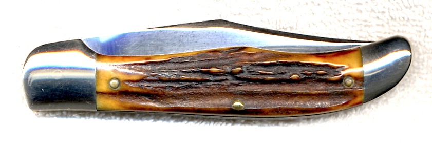

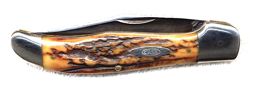

Hello all, I'am showing a Case Stag that is very pretty. It has a couple tiny spots of red on the back and one on the mark side. I'am not naive enough to think this is Red Stag, just though it
would fit in here. Hope it shows up well.

Harold your knife is proof that stag don't have to be red to be beautiful....AWESOME.
BTW awesome pics too.

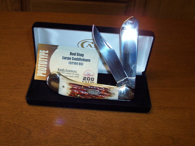

Any Stag is ok with me!! Here's one they call Red Stag. By the model # 52100 its India Stag. It don't have a R in front of the 5. The card I got with the knife says Red Stag, so Is it or isn't it? Either way it is a keeper. Ed
