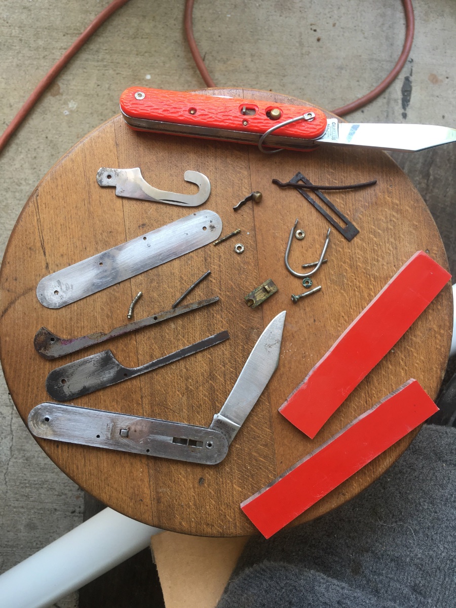

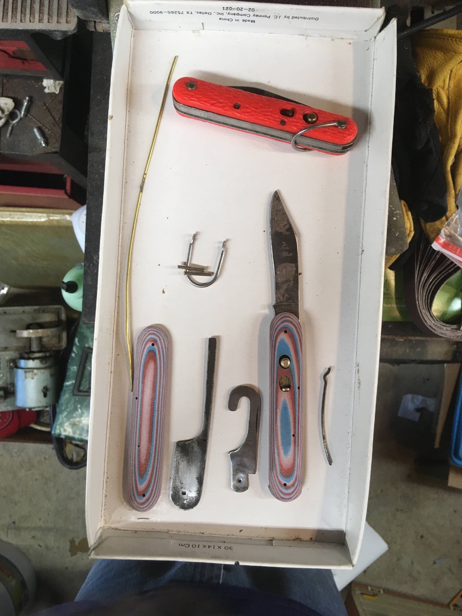

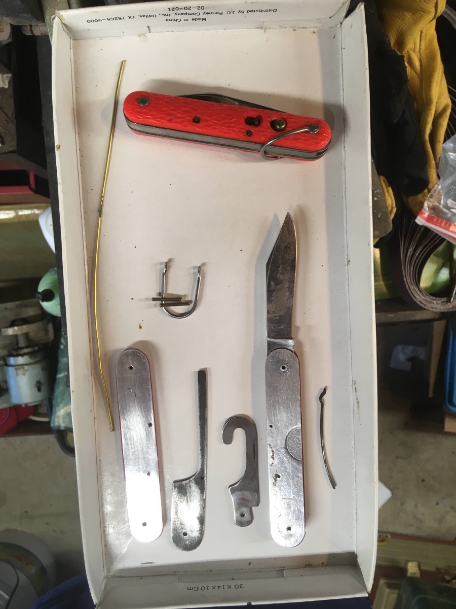

Disassembled MC-1 ready for new “patriotic” scales.

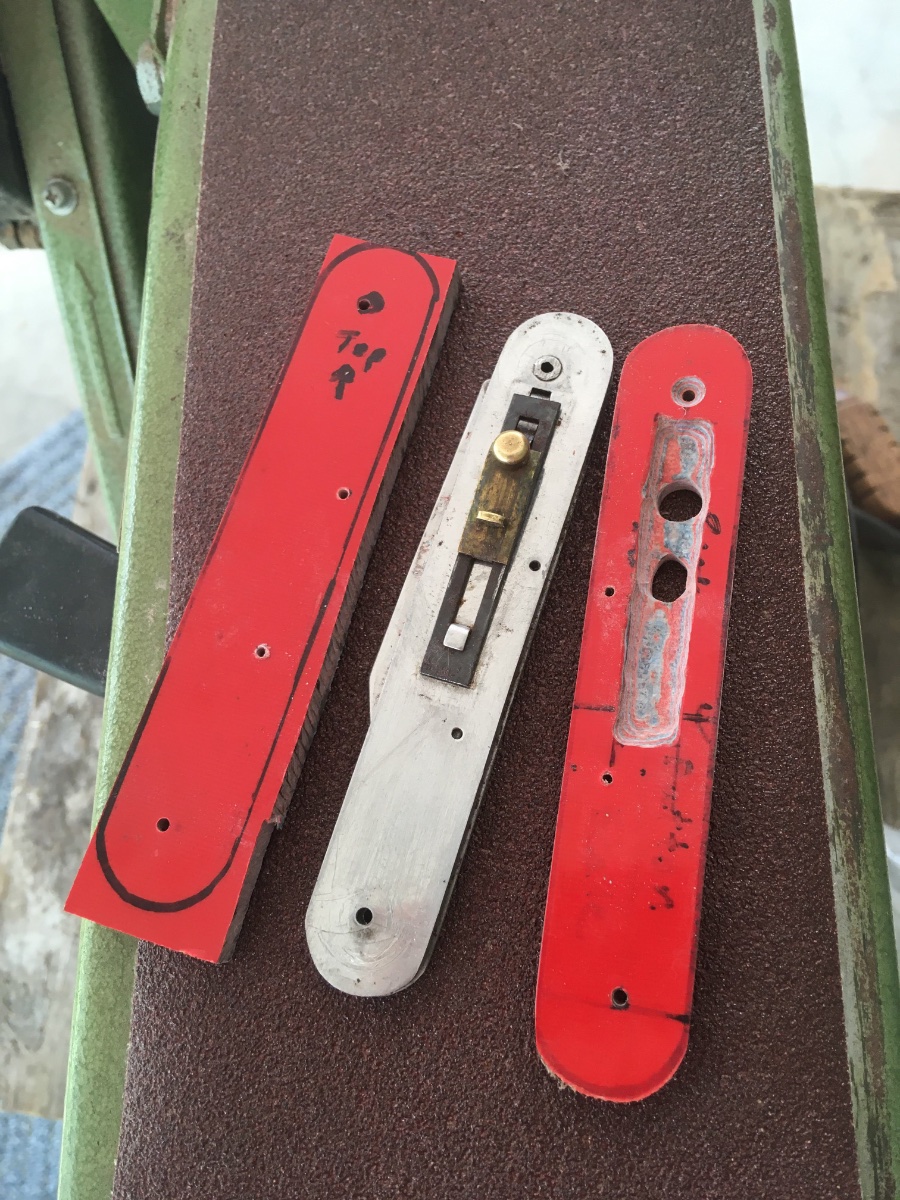

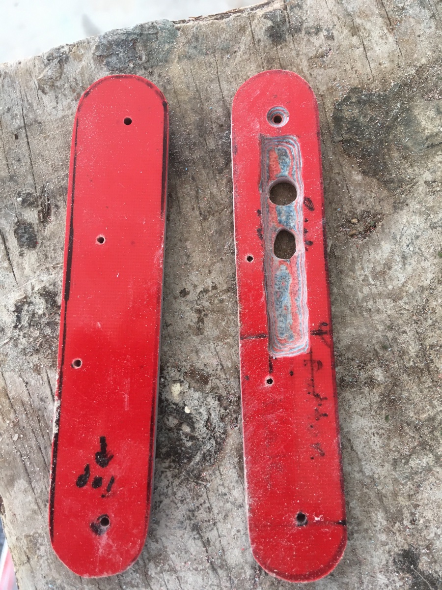

Scales cut to length and ready to measure and mark.
Scales drilled and roughly inletted.

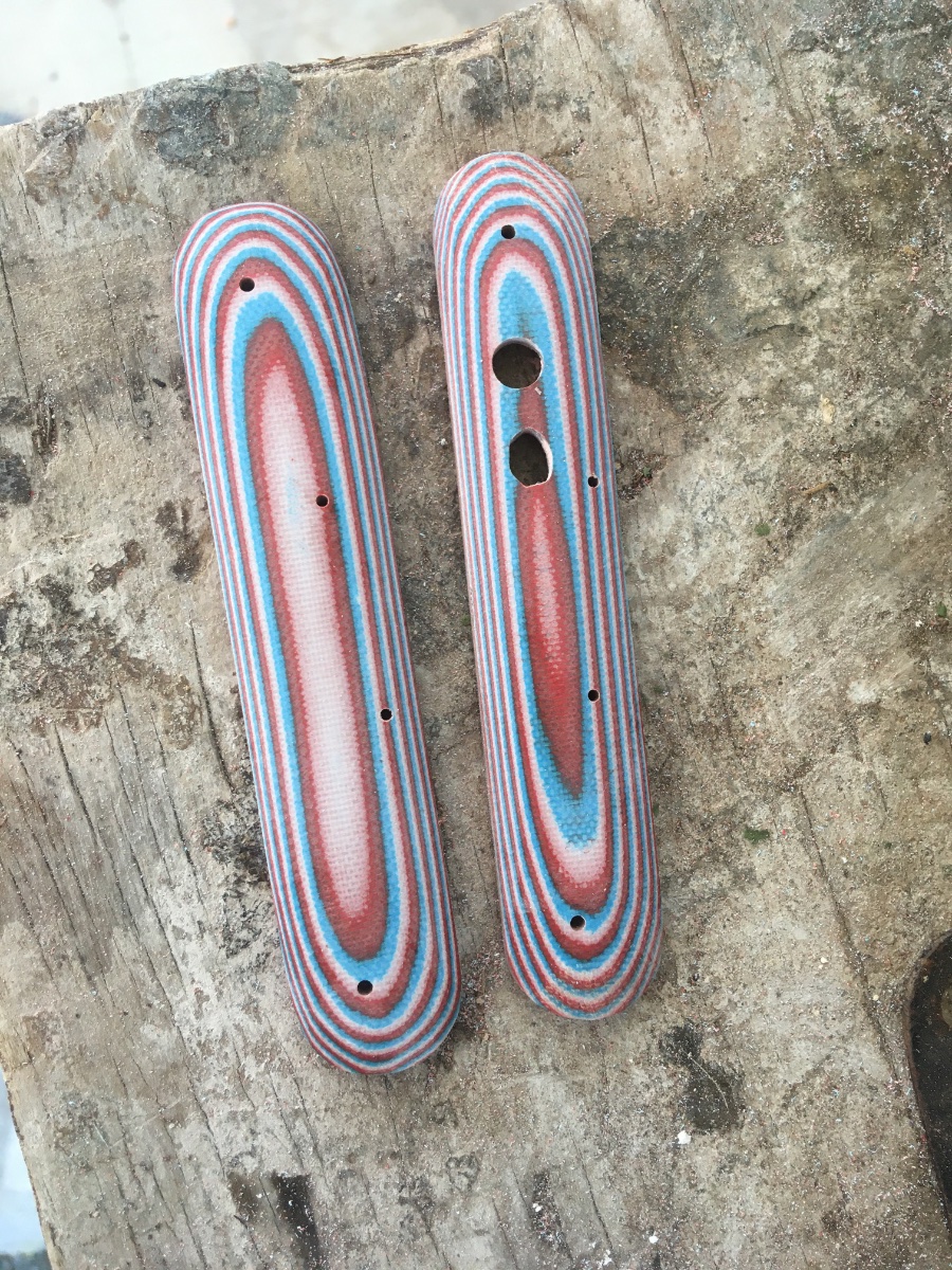

Beginning the “fitting” process.
Shaping using belt sander and Dremel attachments.
More shaping and fitting.

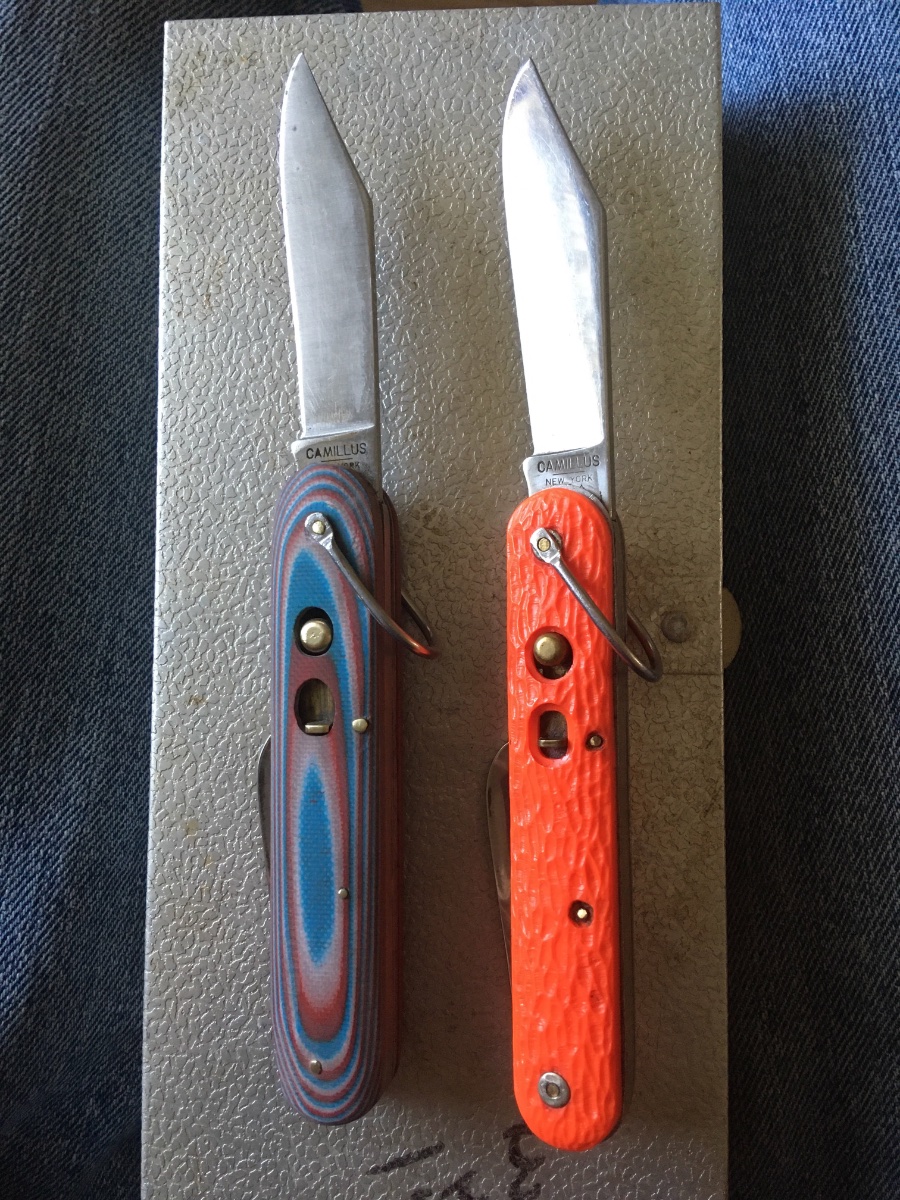

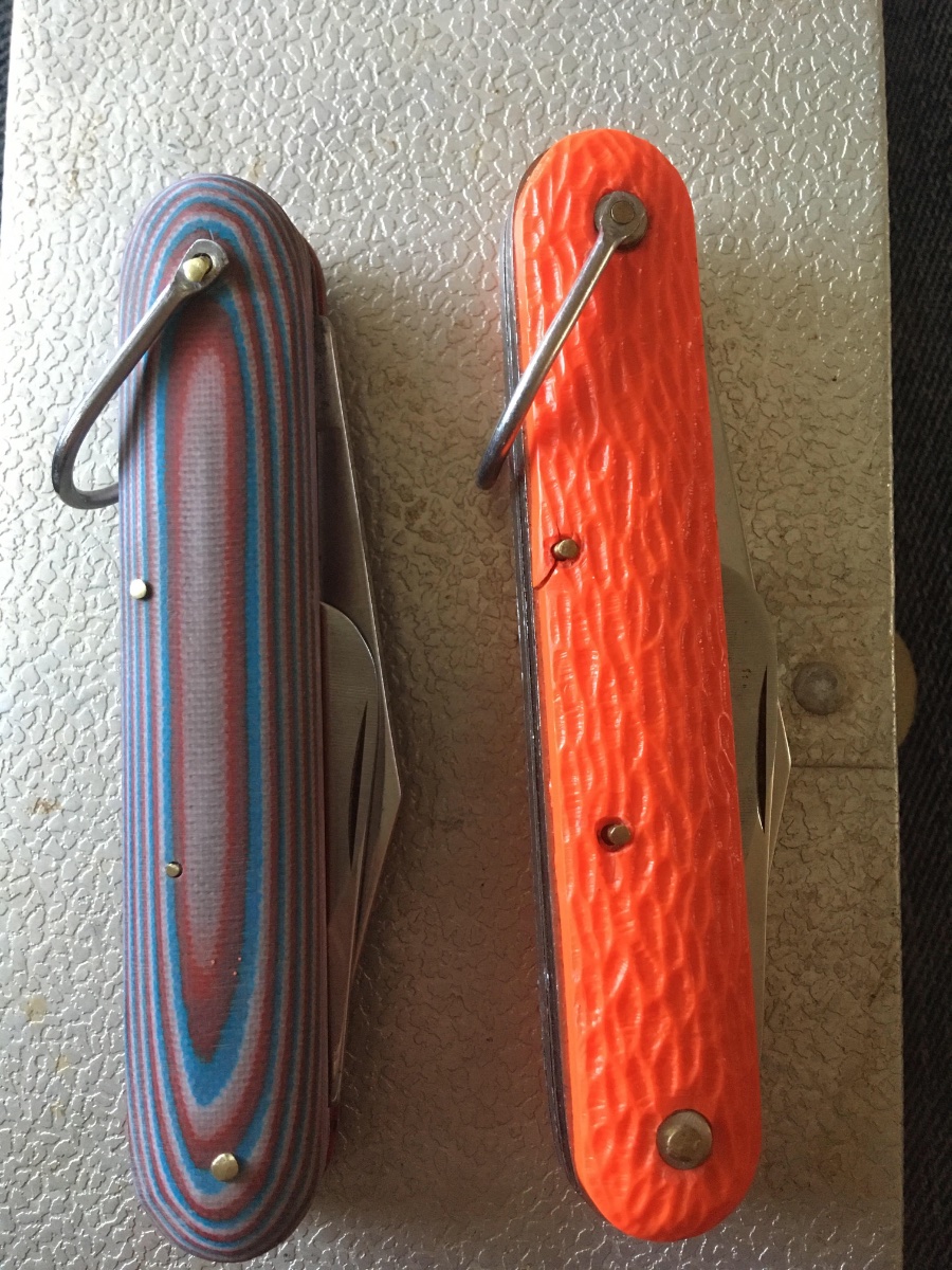

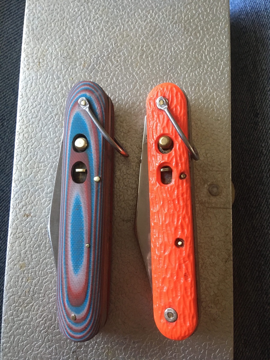

End result, shown with an original MC-1

The material is red, white and blue G-10. (I wish the blue had been more of a navy. )

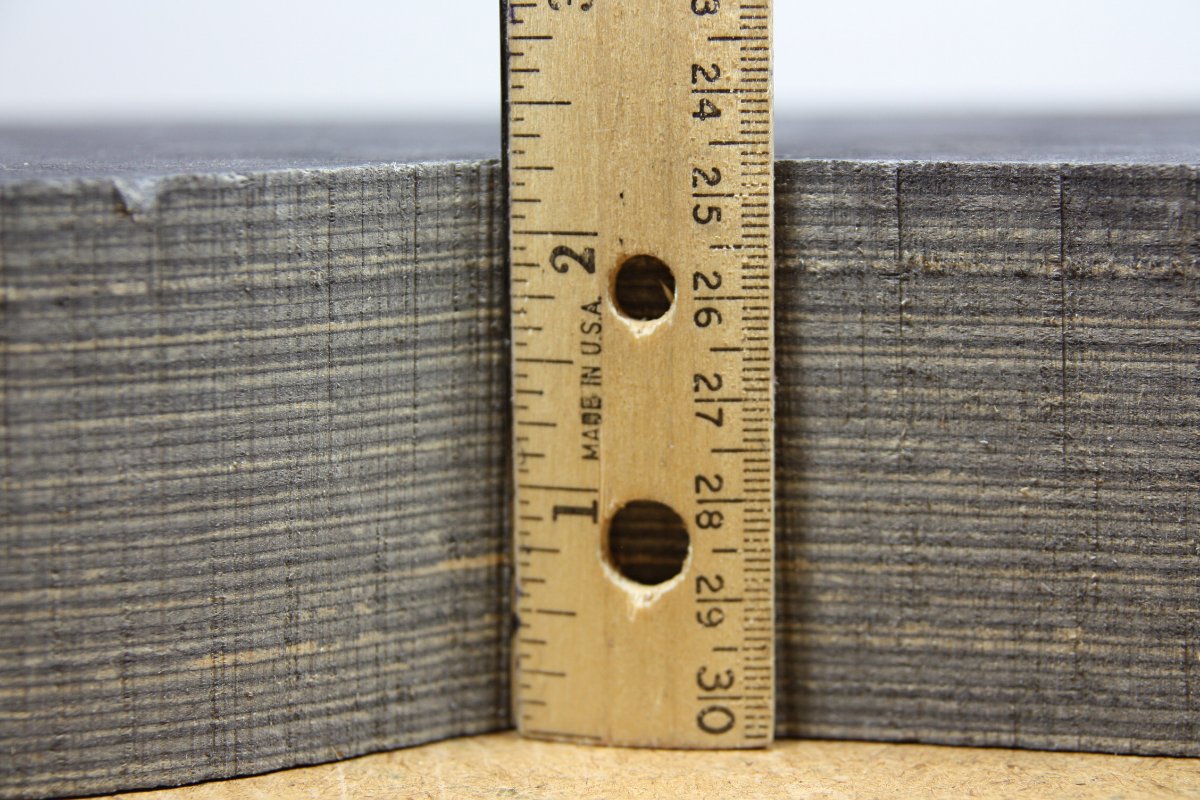

The reason I am asking is I have a Boyd's laminated gunstock reject that a buddy gave me and am thinking of cutting it up for knife scales, the laminations are about 1mm thick. I was concerned that if the laminations were too thick, it would not look good when scaled down to a knife scale size. How thick are the laminations on your G10 shown?
millern
Posts: 94
Joined: Wed Mar 04, 2009 2:47 am
Re: Rescaling a Camillus MC-1 flight crew knife
Post by millern »
I estimate that the laminations in the g-10 material was about 1/2 the width of the laminations in your gun stock material.
