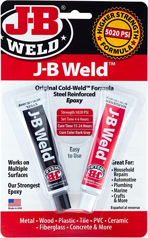

Re: Expoy ??
Nope but I would recommend a trial run on a piece to be epoxied before doing the real thing.
J-B Weld has worked well for me in the past. I would recommend the clear epoxy. This is a gray color.

Re: Expoy ??
Brilliant !!!
I was going to ask advice on this a few days ago and bought some of this brand epoxy last week (still hasnt arrived yet)
I have bought the marine version so hopefully should be ok ??

Re: Expoy ??
You should be good to go. Just remember, a clean surface and easy does it wins the race. Please report back once the project is finished.
