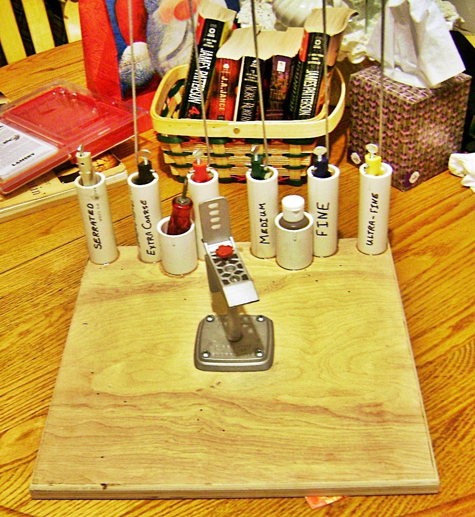

This is my set-up.

::tu:: I use this Lansky, I find it just great .I don't care for scary sharp just sharp enough to slice paper with my 301 Buck and my Case Trapper lock. ftd

jerryd6818 wrote: Mon Dec 30, 2019 4:52 pm This is my set-up.
Very nice organized set up Jerry - I like what you did there. My setup is basically a stationary drill press table with the Lansky C-clamp mount but the whole area is disorganized and gets messy with oil - I like yours a whole lot better ! ::tu::

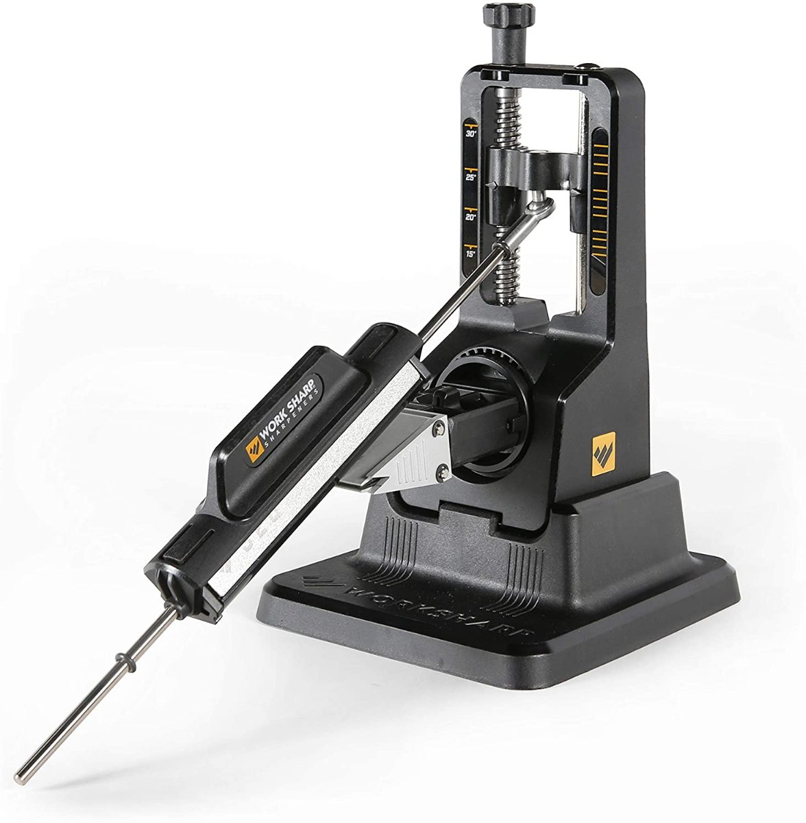

I've been using a Gatco for several years. Looks very similar to the Lansky. I just purchased one of these from Amazon. Anxious for it to arrive and see how well it works.

I am interested in hearing your report on how this sharpener works. Especially on large blades and small blades which can be a problem for the Lansky.

Mark in PA wrote: Sun Jan 31, 2021 9:41 pm I've been using a Gatco for several years. Looks very similar to the Lansky. I just purchased one of these from Amazon. Anxious for it to arrive and see how well it works.
https://www.amazon.com/Work-Sharp-Preci ... den&sr=1-1
Make sure that you give us a full report when you have used it, looks good and has some good reviews. But always like reviews on AAPK much better, they are always more accurate. But i do like the look of your purchase, well done. ::tu:: ::nod:: ::handshake::
