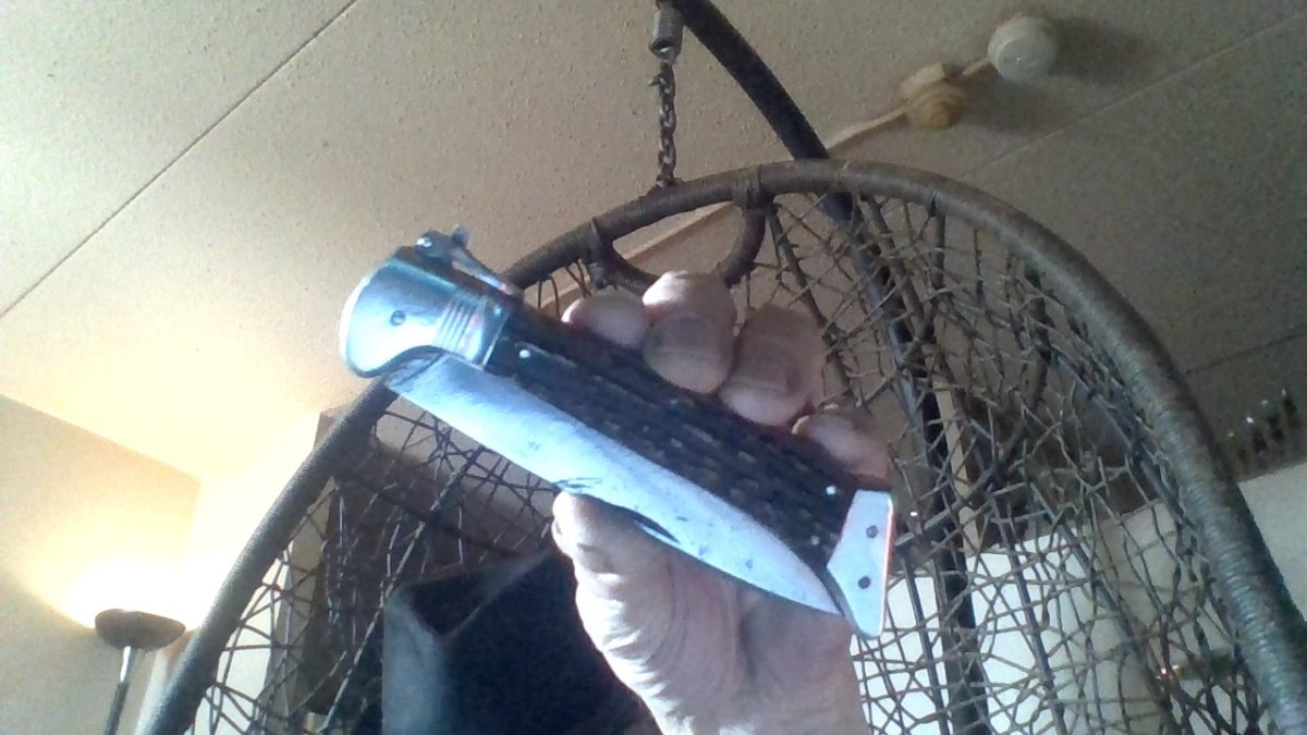

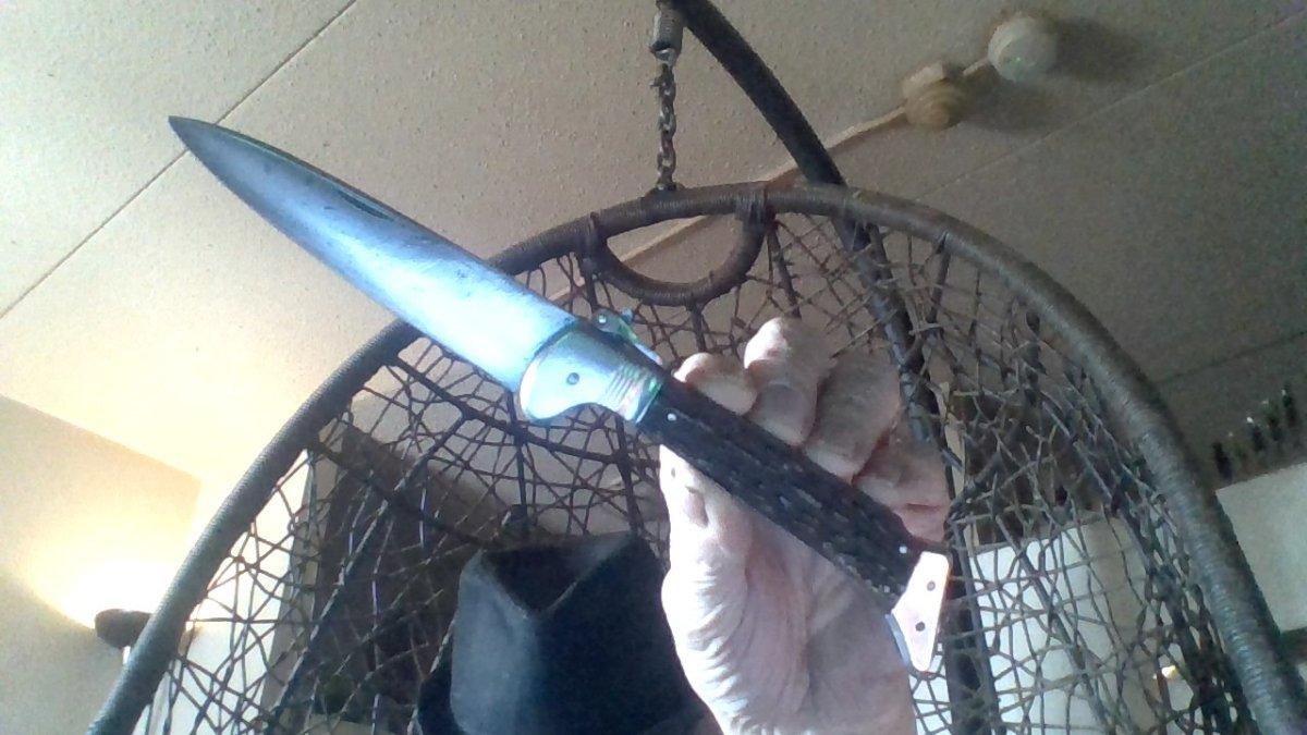

Hey guys! I started to look for a similar topic but then noticed there'd be 76 pages to scour so I just started this one. I recently received an old vintage J.A. Henckels large hunting trapper that I will post after I get some answers to these questions, but I don't want to show it until I make any changes that are suggested, or not. I'd like to know if there's a way to remove some or any of the pitting on the blade, and even if there is should I remove it? The knife will never be for resale so collector value really isn't an issue, I just like my knives as new and shiny looking as possible, I'm a horrible sucker for shiny. Also, the stag covers appear "dusty" or "milky", is there a way to spruce them up? Thanks fellas!

Thanks Mark. I can't say for sure just how unique or rare this knife is, unfortunately the seller didn't offer any time period. I paid-up considerably for it in the deep-end of the Bay and it's the only one like it I've seen. I should apologize for even posting my post, cuz as soon as I did I remembered that a search on the subject would yield results, and it has. I think I'll just show it now and should I make any changes I can always post the new pictures. Thanks again for your insight.
The things I described are difficult to make out from my pictures, but they're definitely there. A double-click on the picture when closed shows it better than the when open picture.

Re: Advise and opinions needed!
That's a pretty rare old Henckels knife.
I don't suggest trying to remove any pitting.
And don't put mineral oil on the stag! It softens it and discolors it. Use paste wax or neutral shoe polish and a soft brush instead.

WOW Mark, that one is a beauty! From your pictures, I don't see a lot of pitting, but to remove or not is a very personal decision. I don't usually mess with it unless its really bad, because once you get started, you have to remove a lot of metal before it starts to look better. If you have a cotton buffing wheel, that may be all it takes to get rid of the cloudy/dull look of the stag. If you want it to shine more, like Bill said, use a bit of paste wax and then buff. Is there any trace of a tang stamp? Nice find!

Thanks for your advise Herb! You're actually correct, the pitting really isn't too bad, it's my need for perfection that made me even state there's some pitting. Unfortunately no, zero markings whatsoever. Any information I've posted is strictly from what little I could get from the description, until Bill confirmed it's a "pretty rare old Henckels" and what the seller posted it could have been just about anything. It sure feels good in-hand though!
