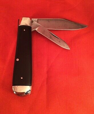

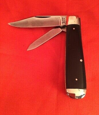

I am still learning by far and am no expert, but something just don’t seem right to me. The scales do not look like typical Ka-bar handles to me, I am not familiar with this style either. The bolsters appear polished, but the scale material is scratched. The stamp seems a bit off too. The blades appear to be ground also and not Ka-bar style. If I am wrong, please tell me!

Looks proper to me, but the seller is in the messed with knife capital of the world. KA-BAR did make slick black scales, yes the bolsters have been buffed.
The seller's date is incorrect, knife was only made for a couple years with that tang stamp and construction. The KA-BAR over Olean, NY mark began in 1943 but if knife were wartime it would have iron bolsters. The mark ended in 1947-48 so this knife could only have been made late 1945-47 or 48. Along with this blade mark came a drastic drop in quality, blade grinds fewer, knives just don't look as good. Now the modern iteration of KA-BAR has used the KA-BAR over Olean NY stamping over again on some of their club knives so there are things to watch for with this mark.

Gunsil wrote: ↑Wed Jan 11, 2023 2:31 pm Looks proper to me, but the seller is in the messed with knife capital of the world. KA-BAR did make slick black scales, yes the bolsters have been buffed.
Thank you for the detailed response. There were a few things that popped out at me, nut I just could not place them. Thank you for the clarification, this auction will go to the junk pile for me.
