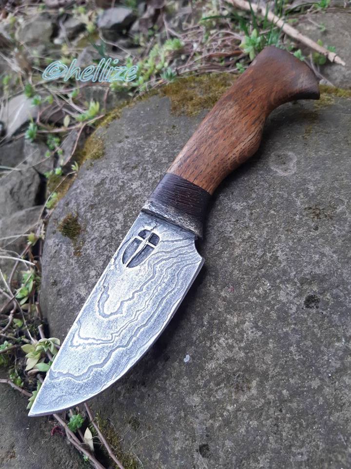

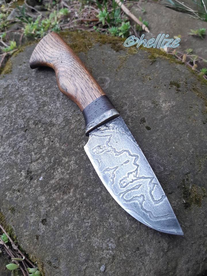

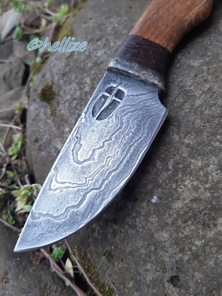

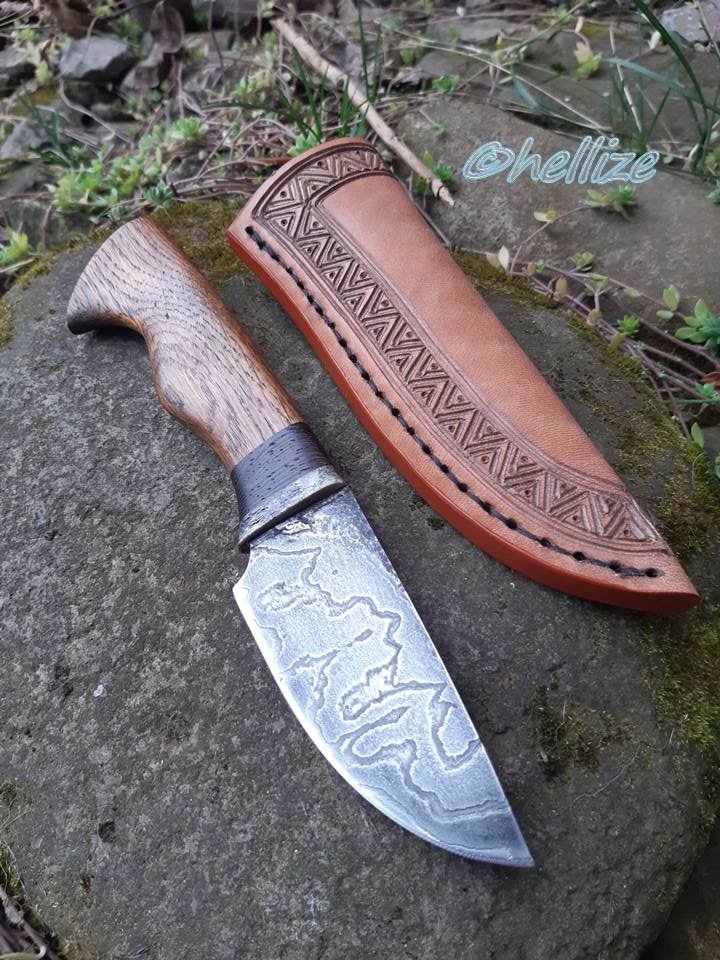

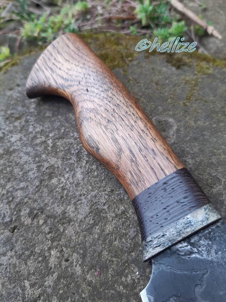

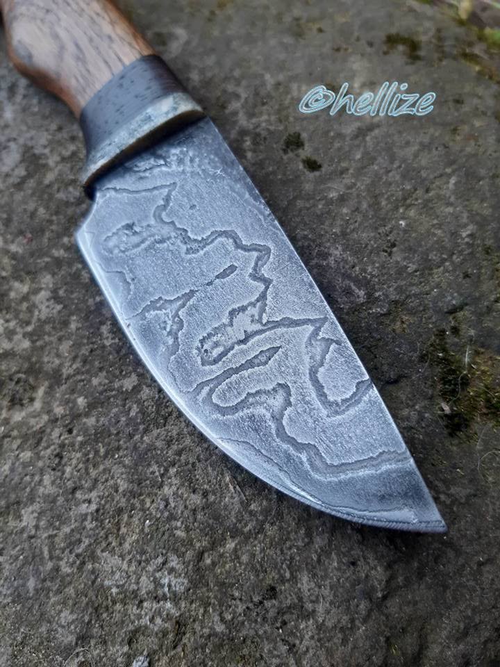

Gretings,
It is 20.5 cm / 8 inch long, the blade is 9 cm/ 3.5 inch long, 3.6 cm / 1.4 inch wide and 4 mm / 0.16 inch thick.

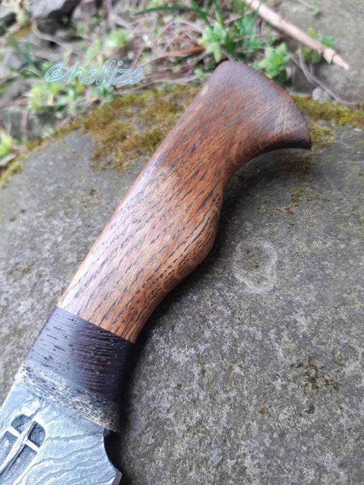

I hand forged it from 5160, 1.2516 and L6 with around 50 layers. The handle is made of deer antler, wenge and oak.

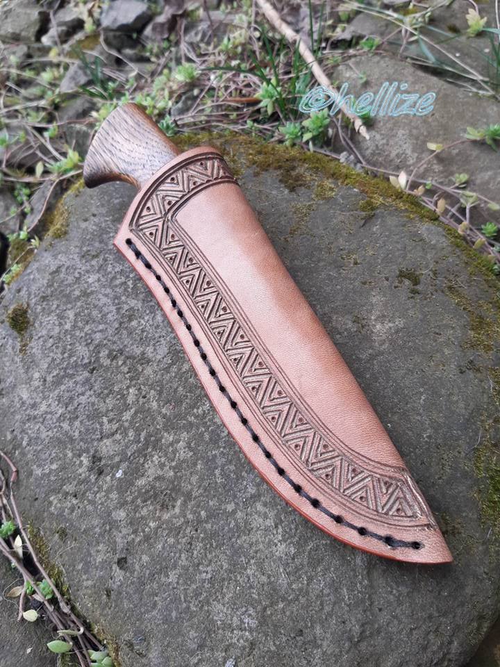

The sheath is made of 4 mm/ 0.16 inch thick, sturdy cowhide.

Beautiful work, I love the oak handles

Neighbor, which steel is on the cutting edge? Do the three steels have roughly the same hardening regime?

I've never had much luck working with oak in knife handles.

Eustace wrote: Sun Jan 15, 2023 3:44 pm
hellize wrote: Sun Jan 15, 2023 2:40 pm
5160 are the wide layers, this one gives the bulk of the material and is also relatively the weakest of the 3 steels.
It is heat treated according to 5160.

glennbad wrote: Sun Jan 15, 2023 4:18 pm I've never had much luck working with oak in knife handles.
That's a beauty!
Glad you like it! :)
Yeah, I know what you mean. It splinters rather easily, if you carve it in the wrong direction. But with patience, it is workable and it does compensate all your efforts with a nice grain structure.

Oledadsknives wrote: Sun Jan 15, 2023 11:23 pm I like it hellize! That is a very manly knife. If a man is tough enough to use this knife, a little splinter shouldn’t phase him anyway if he gets one!!
Jimbo
But you misunderstood me brother. It could have splintered in the time I was carving it's handle. Now that it is finished, it will not!
No one is in danger of getting a splinter.
