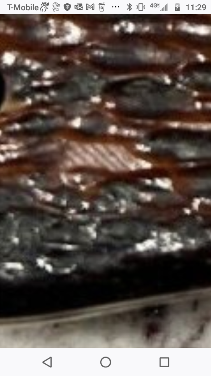

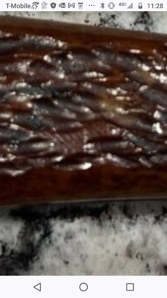

This one has superficial scratches for some reason.......tang stamp??? tang/scales has poor fit???
Posts: 18926
Re: Hawkbill
::hmm:: It kinda looks like 70's-80's dyed bone, and these saw marks concern me . . .

Knife looks okay to me. Rogers bone examples are harder to find.

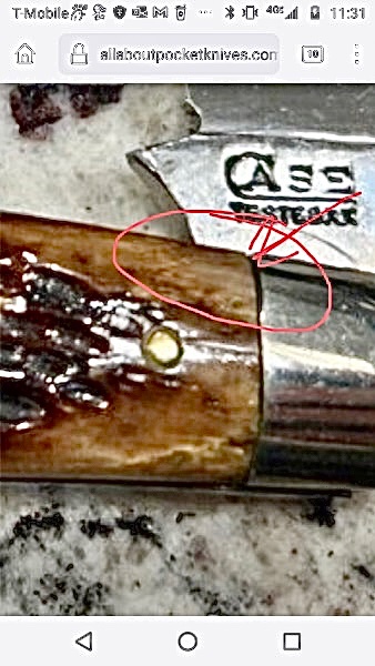

Looks okay to me, based on the pictures. Rogers bone, stamp looks okay, no evidence of tang shaving or cold stamping that I can see. Looks like it has some hafting “sucking out” on the bolster. Picture looks like it may be right, but without having the knife in hand can’t be sure it aligns with shallow areas in the bone where it meets the bolster.
“Sucking out” where nickel silver bolster (NS is softer than bone) is removed during hafting should correspond to thinner bone area.

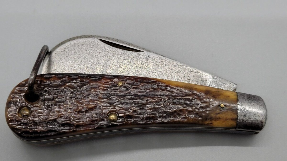

ea42
Posts: 3136
Location: Wallkill, NY
Re: Hawkbill
Post by ea42 »
Just thought I'd post this pic of a similar hawkbill for those concerned with the bone. Looks very similar and the knife is from the same era:
Eric
