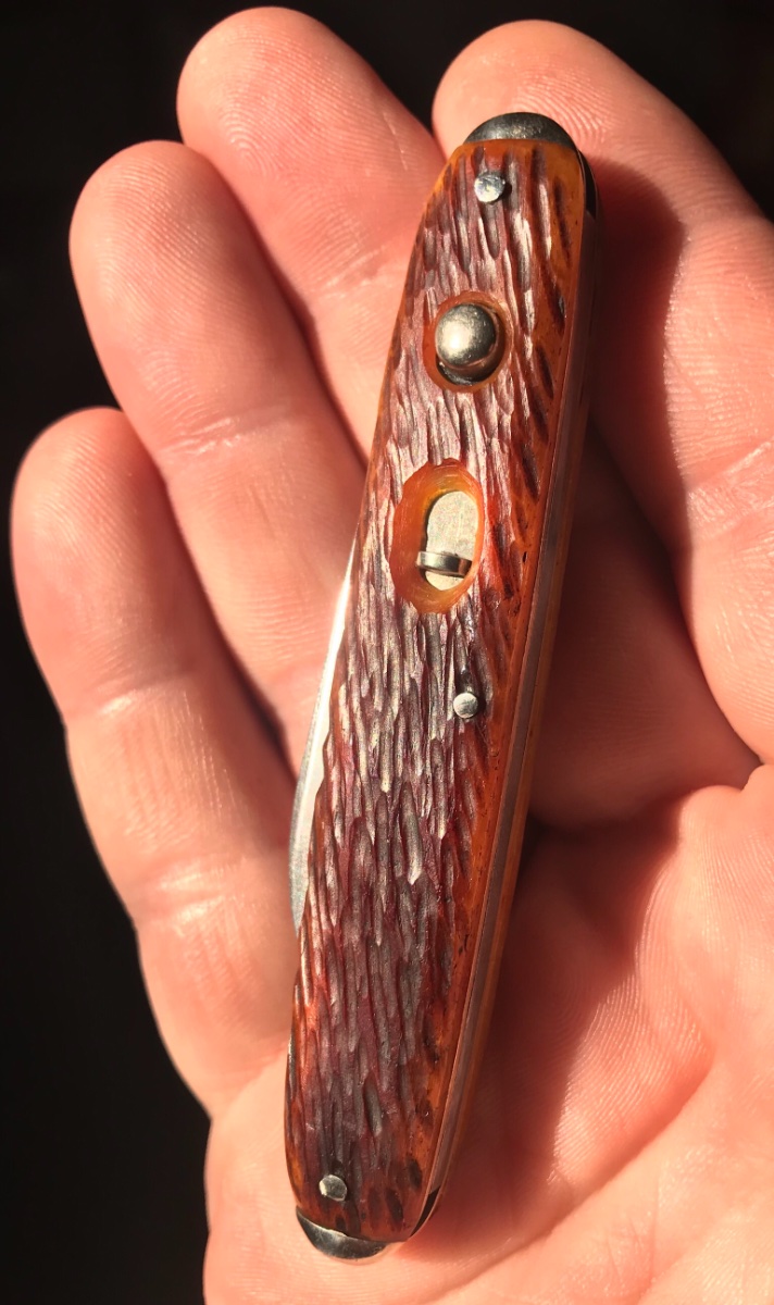

I then just studied some pictures of that type of jigging, and the general angle it was laying. Then I tested my method on the scrap piece of bone until I got the feel of how much pressure and time I wanted to spend for each cut. Then when I felt confident enough:

The jigging turned out amazing.BFORSE wrote: ↑Wed Aug 09, 2023 1:20 pm I then just studied some pictures of that type of jigging, and the general angle it was laying. Then I tested my method on the scrap piece of bone until I got the feel of how much pressure and time I wanted to spend for each cut. Then when I felt confident enough:

Totally agreeedge213 wrote: ↑Wed Aug 09, 2023 2:01 pmThe jigging turned out amazing.BFORSE wrote: ↑Wed Aug 09, 2023 1:20 pm I then just studied some pictures of that type of jigging, and the general angle it was laying. Then I tested my method on the scrap piece of bone until I got the feel of how much pressure and time I wanted to spend for each cut. Then when I felt confident enough:

Yes, that looks awesome.

That's some fine work, you sir are a fine artist, even the chicken coop has that special vibe.
