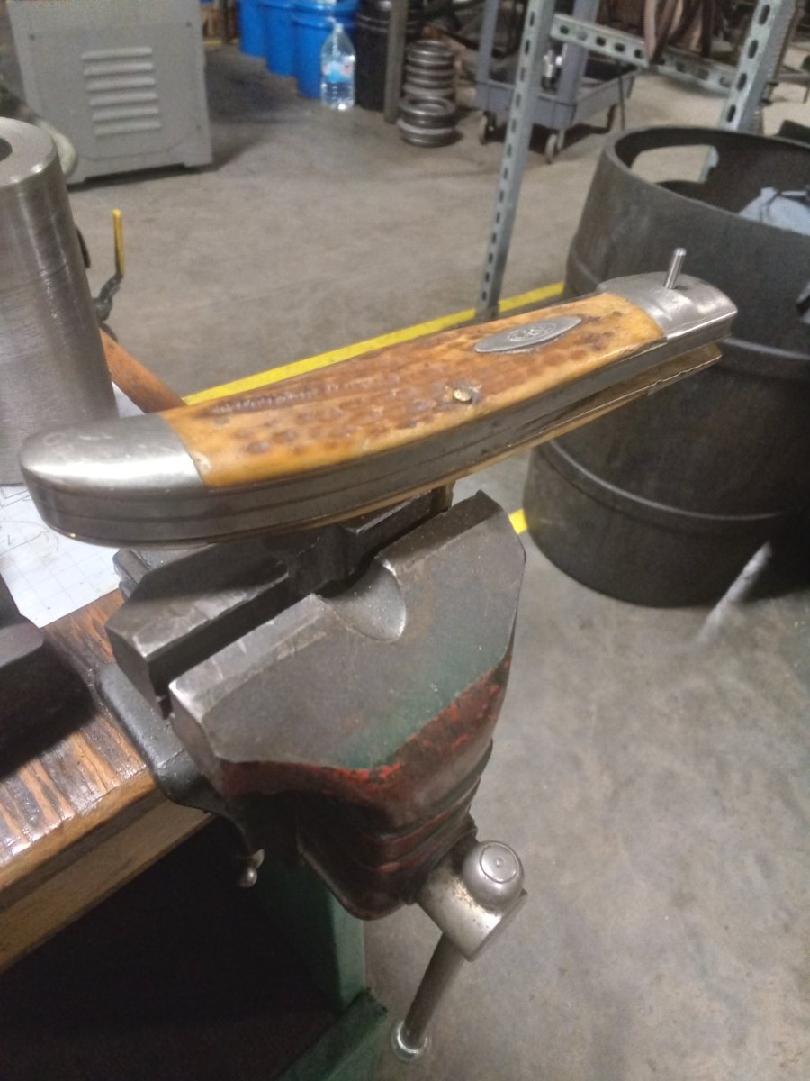

Thank you for all the replies! Using the other blade as a pattern for the hinge end is a good idea. I hadn't considered it would be the same geometry.
I think the first order of business will be to remove the old sheared pin ends and the existing blade, as that will need to be done whichever direction this goes. From there I can practice making a blade and see if an original turns up.

Been busy, but finally getting back around to this project. Had a stroke of luck in that I found my dad had a 2nd 6265 Tha also belonged to my grandpa. It's complete, but has a broken pin, so while it's apart to change the pin, I'm using it's blade as a pattern to reproduce the other missing blade.

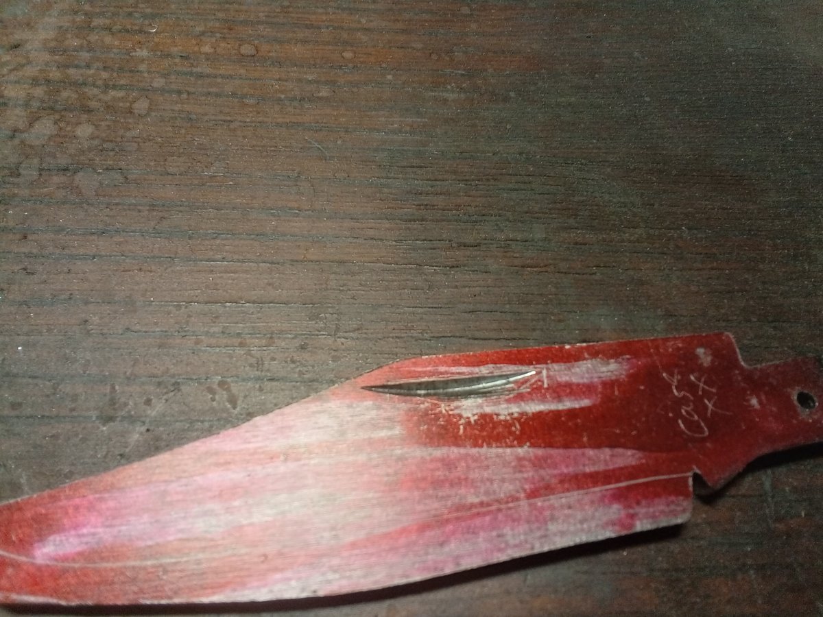

I'm using a leftover bit of O1 flat stock that is a little thicker than needed so it can be ground down. I drilled the pivot hole first to give a central reference between the stock and pattern blade, then traced the outline in dykem and added some to the edge. I next did what I thought would be the trickiest feature, the nail mark, but it turned out to be easy. Held the stock at a 45 on the mill and used a flycutter at about 3 3/4" diameter to sneak into the depth and it gave the needed flat side and crescent. It's a little deeper intentionally so that it will get shallower when I surface grind the extra stock off.
Next I cut it out on the bandsaw and started grinding the different sides to match the pattern, though I'm leaving a little extra where the spring fits, so I can fit it to the knife later.
Next I'll surface grind it to the right th8ckness, and taper the sides. I'm undecided how I'll mark it, but I might stamp the "case xx" script along with my initials or our old family brand. Once that is done and most of the stock is ground to size, I'll heat treat it, do the final fit and assembly, and put an edge on it.
Go easy on me! It's my first folding blade! Lol

Is the kick on the new blade big enough to hold the cutting edge away from the spring? When I make blades I always make the kick very oversize to allow for fitting.
- edge213
- Posts: 8467
Re: Case 6265 Blade Replacement
I didn't notice until you mentioned it, but it sure looks like the blade will hit the spring.OLDE CUTLER wrote: ↑Wed Nov 20, 2024 12:00 pm Is the kick on the new blade big enough to hold the cutting edge away from the spring? When I make blades I always make the kick very oversize to allow for fitting.

Thanks that's a good point. The kick is the same between the two blades, but I added more to the edge to account for sharpenings. I'll make sure that as the edge and point get beveled the edge moves back as well. Better to have too much material than not enough.

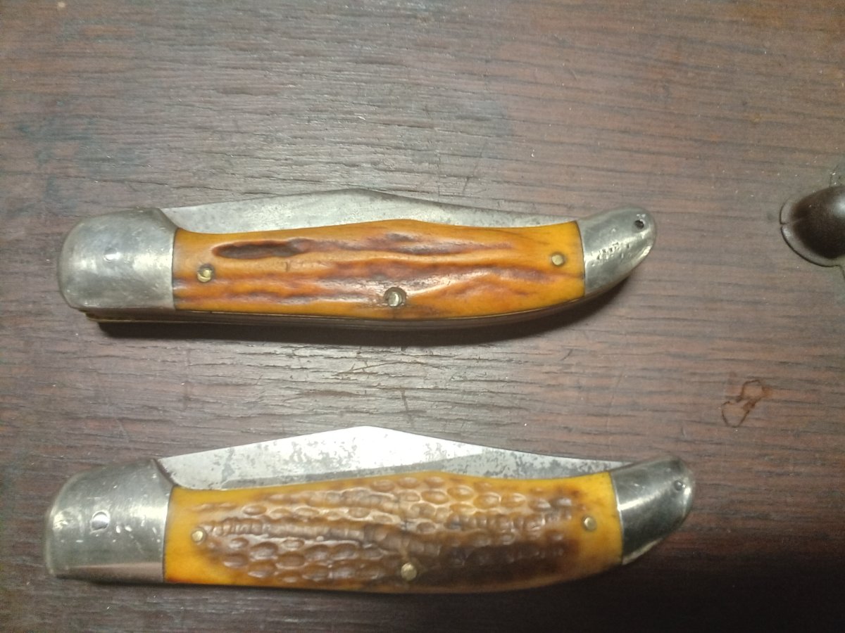

More progress. On the right is the original blade, next is the first replacment which has some issues, beside that is the 2nd replacment, and on the left Is another blade I'm making for a smaller case that is old enough I dont think it has a model.
The fitment of the first replacment seems ok other than I need to grind the bevel back more since I left too much material on the bottom. I'm going to finish it as a spare, but decided to start over for the actual blade I'll use in this knife. Biggest issue with the first blade is that the stamping came out wrong and its already been surface ground to thickness so can't grind down and restamp. The "case xx" stamping was too large, the 's' stamp was damaged and came out weird, and I stamped it too close to the hinge where the 'xx' won't be visible. The 2ndblade stamped much better and I used a smaller font. On the back I used a new stamp that came in the mail today. It's a custom stamp recreating our families old brand.
A friend who makes fixed blade knives is helping me grind the bevel as he has fixtures all read to go. After the bevels are all done, I think I'll be ready to heat treat and do the final assembly. I have some stainless pins to use for the hinges, though I'm still waiting on some brass to make the brass center pin from.

Looks great! Though I wish you would use a custom tang stamp that is clearly different than the original. That would avoid confusion over counterfeiting in years to come.
Also, if you can find some silvered nickel pins they will match the bolsters and are less likely to show afterward. Your stainless pins will show, though they will be stronger than original.
Keep us posted!
Keep us posted!

Yes, stamping the blades Case XX is not the correct thing to do. They should be made with your mark on the pile side.
- Mumbleypeg
- Posts: 15705
- Location: Republic of Texas
Amen! And the apparent ease with which he is able to do it should be an eye-opener to everyone!OLDE CUTLER wrote: ↑Wed Dec 04, 2024 12:39 pm Yes, stamping the blades Case XX is not the correct thing to do.
To the OP, I am assuming (I know, that’s dangerous) you’re not a knife collector, and therefore probably not aware the curse which counterfeits have been to the knife collecting hobby. I know - you’re only doing it for yourself and have no intention of selling the knife. Regardless of your intention, some day like it or not, you will not have control over what happens to the knife. It very likely will outlive you, and pass into the hands of another person. Not your problem? No, but it could become the problem of a collector who becomes the unknowing owner of a counterfeit knife.
The right thing to do is NOT stamp CASE on the replacement blade you’re fabricating, but stamp it with your brand. The date when you made it would also be advisable and helpful to a future owner. JMO. In case you’re curious about the prevalence and meaning of counterfeiting to the knife collecting community, there have been books written on the subject. https://www.abebooks.com/9780966102802/ ... 102800/plp Or simply do an internet search for “counterfeit cutlery”. For some more info see this subforum here, focused on counterfeits viewforum.php?f=17

Finally got everything finished on these. Setting the pins I probably could have done better by making some fixtures and pads, but I was able to make due with pin punches, a rivet doming punch, and a ball peen.
I also stamped "O1" on the new blade to note what it was made from, though I'm sure it'll confuse people thinking the blade was made in 2001. I also didn't thin the blade down as much as the original. It works fine so I'm going to consider it another sign of it not being an original. Between heat treating and annealing, the O1 came out a bit softer than I had hoped at 50 to 52 Rockwell, but I do like the dark and scaled finish it gained as it blends in nicely with the older steel parts around it that have years of rust stain.
In the pictures, the original knife that served as a pattern is on top. It needed a new hinge pin and some polishing. The scales were very dry and "boney", but brightened up nicely when I was oiling the blades. The bottom knife is the one with the new blade. I'm passing the original on to my brother, and I'm keeping the one with the new blade.
