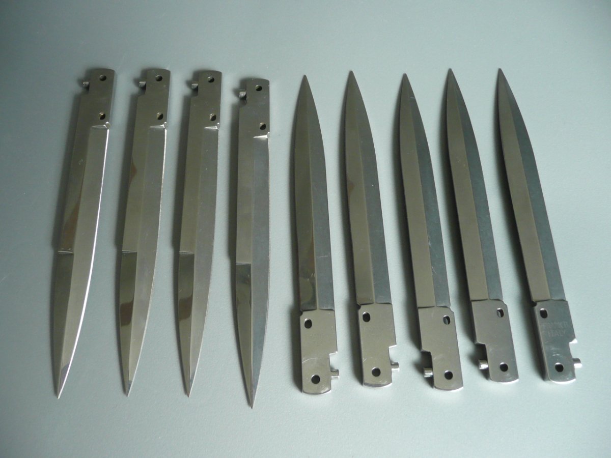

Re: Top bolster rivet
Hmmm, let me see, where did I put those Frank Beltrame blades
I buy Frank Beltrame 11" swivel bolster stilettos to take them apart and use their parts for other knives.
These however are all 2.0's, with the 4mm thick blades, but I wouldn't be surprised if the pivot holes stayed the same from the older version.
Alright, the size of the pivot hole- The pivot holes in the blades are not a standard (SAE) size. It has been my experience that they, or whomever is assembling them knives in the US, use slightly undersized pivot pins 7/64ths of an inch in diameter.
If I were working on a Frank Beltrame stiletto, and I have, I would start with 1/8th" pin stock, and slowly reduce it for a custom fit. All of the pivot holes I've ever encountered on FB stilettos (more than the ones pictured), had holes a fraction under 1/8th". With the exception of one, that had a slightly oversized hole, but it was a perfect 1/8th", so it worked out great for my rebuild since I was using a 1/8th" screw/barrel pivot.
And the closest rod/drill gauge size to the blade pivot holes, without going over, is 33. So if you want to drill a hole, like if you are making custom liners or bolsters, I'd recommend using a size 33 drill bit, and then slowly working your way up by hand until you get a custom 1/8th" fit (wrapping sandpaper around the blunt end of a smaller drill bit and twisting it around in the hole to slowly and gradually make it bigger).
I hope all this helps
You're welcome.
And it just occurred to me that in Italy they probably use metric size pin stock, so I did some measuring, and 3mm is a very close fit to the holes in my blades.
Also, just because I had one around, a 4-40 bolt is also a close fit (but a 3mm bolt is even closer).
