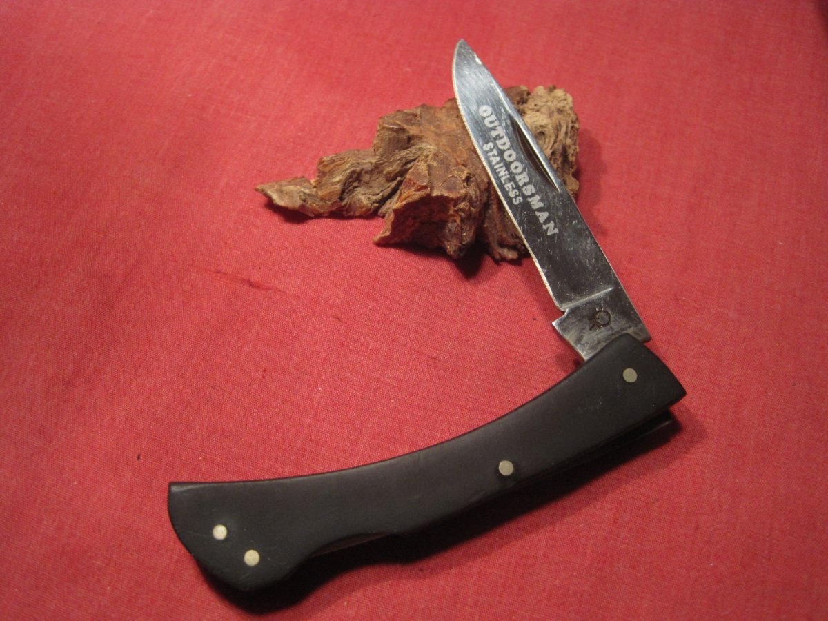

Before / after pictures of knife I gifted this Christmas. Used mineral oil.
Proof is in the pudding
Bob
Bob

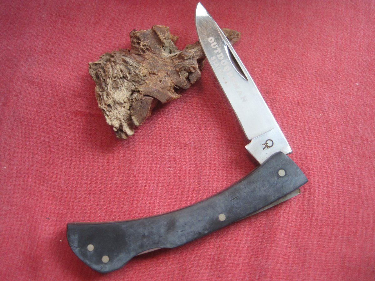

- TripleF
- Posts: 19607
- Location: West Central FL
Re: How do you Restore Plastic scales
Above in OP, you can see my dilema.
I used 3 in 1 and this is the end result. Thanks fellas.

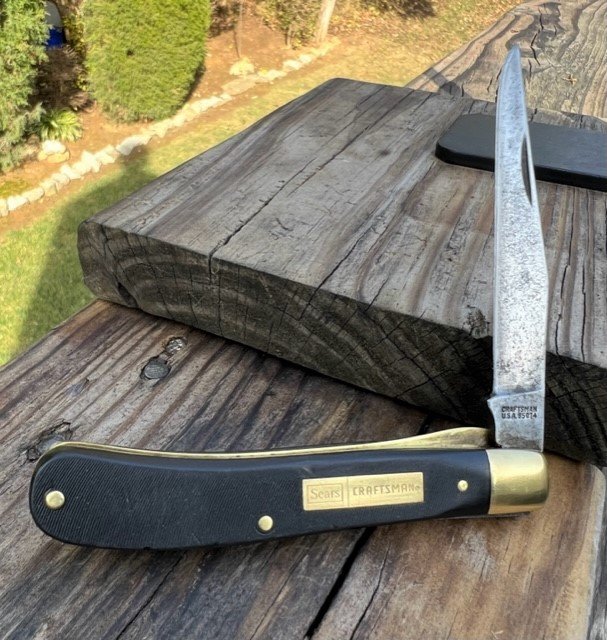

I have had good results using an automotive product called Black Again. It works well on most of the plastic type handles. It will work on Delrin to shine it up if it is not too badly softened by oxidation or sunlight. I got 2 very badly oxidated Delrin handles on a couple Craftsman knives that I thought were hopeless. A friend had told me about a product called Corrosion X, a product that is supposed to "kill rust and corrosion."
I sprayed those two knives with Corrosion X and let them set for a couple of weeks, tossed them on a workbench and forgot about them. I almost couldn't find them when I went back and looked because they looked so much better! It wasn't a perfect restoration job because the color had been altered already by the oxidation but the soft Delrin had hardened and it was definitely a usable handle after that.
I'm hoping to find another knife or two that are that badly oxidized and repeat the process taking pictures to document it so I can post the results for you.
I have used mineral oil on some oxidized knives, but found it was not as effective on heavy oxidation as it was on light discoloration of the handle. I think there are lots of oils that will do the same thing, and most of them much cheaper than a spray can of Corrosion X, which is I recall was about $25 last time I ordered it.
I'm sure there are any number of plastic restoration products used in the Auto industry that would work very well on knife handles also. I have used Armor All, but found the Black Again to be much more effective than Armor All. It seemed the Armor All would dry out quickly.

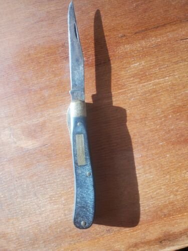

Bluntedgenives
- Posts: 1
- Joined: Sat May 13, 2023 6:21 am
I’ve tried the “separate but equal” technique to try to preserving my celluloid knifes. I have an inexpensive but hard to find Brownie Girl Scout Knife in my Scout collection. It’s handles are crumbling and pitting. I want most of all to save the inscriptions imbedded in the plastic on both sides. Ready to try anything to hold it together- even dumb stuff.
Has anyone tried coating the old material with epoxy, clear resin, super glue, clear varnish, or some other magic substance??
Bet someone out there has tried things to combat this.
Blundedgenives
Blundedgenives

The OP knife in this thread is not celluloid. It’s delrin, with what some call “Delrin haze” which is readily resolved with some light oil (like 3-in-1). That won’t fix your celluloid and in fact may make it worse. Celluloid unfortunately is a “whole nuther beast”. Celluloid undergoes something known as outgassing. Once it starts to go bad, as it sounds like yours has, there is no stopping it or curing it. If it’s not already too far gone and you want to save the rest of the knife you will need to remove the celluloid covers and replace them with something else. Many have tried anything and everything to stop it but the end result is fatal to the knife.Bluntedgenives wrote: ↑Mon Dec 04, 2023 11:21 pm I’ve tried the “separate but equal” technique to try to preserving my celluloid knifes. I have an inexpensive but hard to find Brownie Girl Scout Knife in my Scout collection. It’s handles are crumbling and pitting. I want most of all to save the inscriptions imbedded in the plastic on both sides. Ready to try anything to hold it together- even dumb stuff.
Blundedgenives
There are literally hundreds of posts here on AAPK about celluloid. You can find more about it by doing a keyword search here for “outgassing”. For example viewtopic.php?t=78342
Welcome to AAPK. Sorry to be the bearer of bad news.
