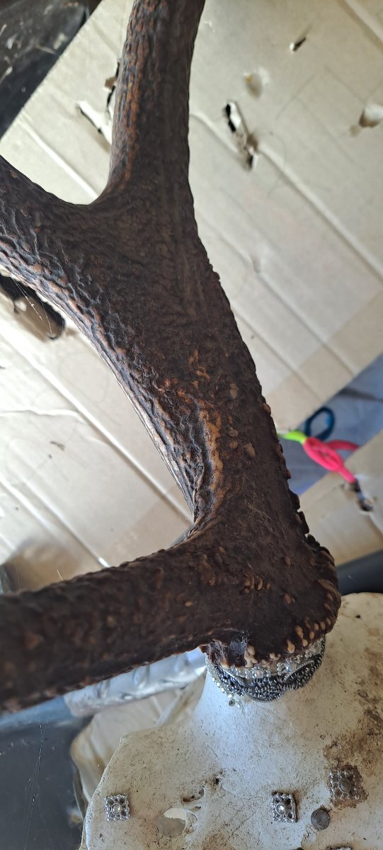

I'm currently working on a trade with a knife maker, a stags worth if antler for a knife. I get the additional kick from it knowing that a few folks will get enjoyment out of the stag long after me as knives.
Ripster
Posts: 5044
Location: Wi.USA
Re: Antler for handle material
Post by Ripster »
Bushfire wrote: Sat Dec 23, 2023 12:21 pm I'm currently working on a trade with a knife maker, a stags worth if antler for a knife. I get the additional kick from it knowing that a few folks will get enjoyment out of the stag long after me as knives.
Nice looking Antler /stag you have there BF . Please show us the knife if you both make the deal happen!

Applying potassium permanganate will artificially darken antler, in fact most commercially available antler will have been artificially dyed. It still looks quite natural when done well.
