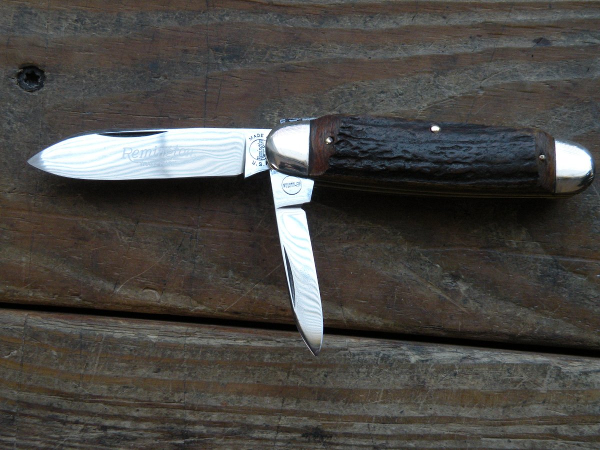

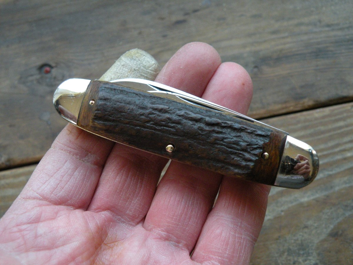

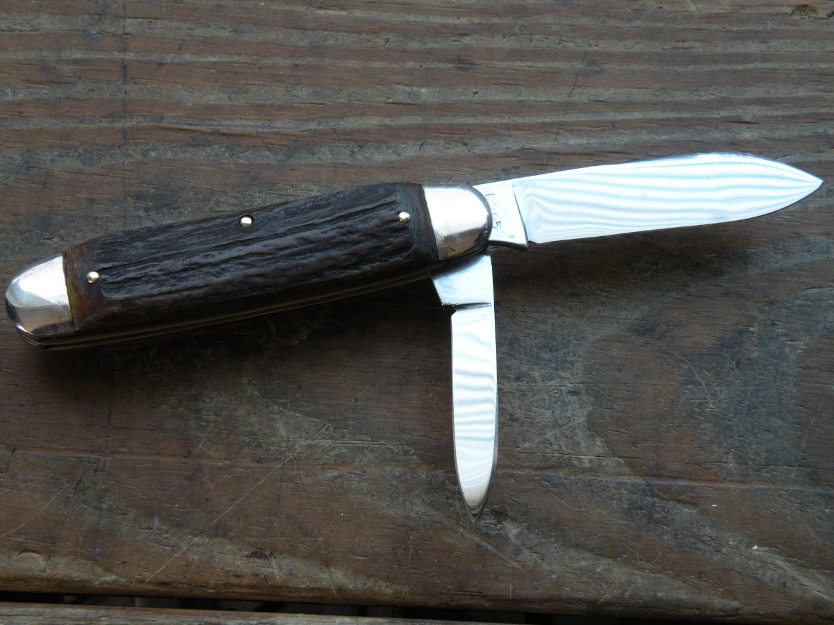

After reading Reverand's earlier post about using elk antler dog chews for knife scales I had to give it a shot, particularly since I've used up a fair part of my sambar stash. This Remmy 365 came to me in a lot of knives that I won in a recent, large, proxybid knife collection auction. The scales had previously been removed and otherwise the knife showed no signs of ever having been used. Stewart and Ritchie's book on Remington knives indicates that the R365 was made from 1920 to 1940 and only with celluloid scales. I think I may have gotten the dye a bit too dark, but am otherwise happy with my first elk hunting adventure. Thanks for the tip Reverand!

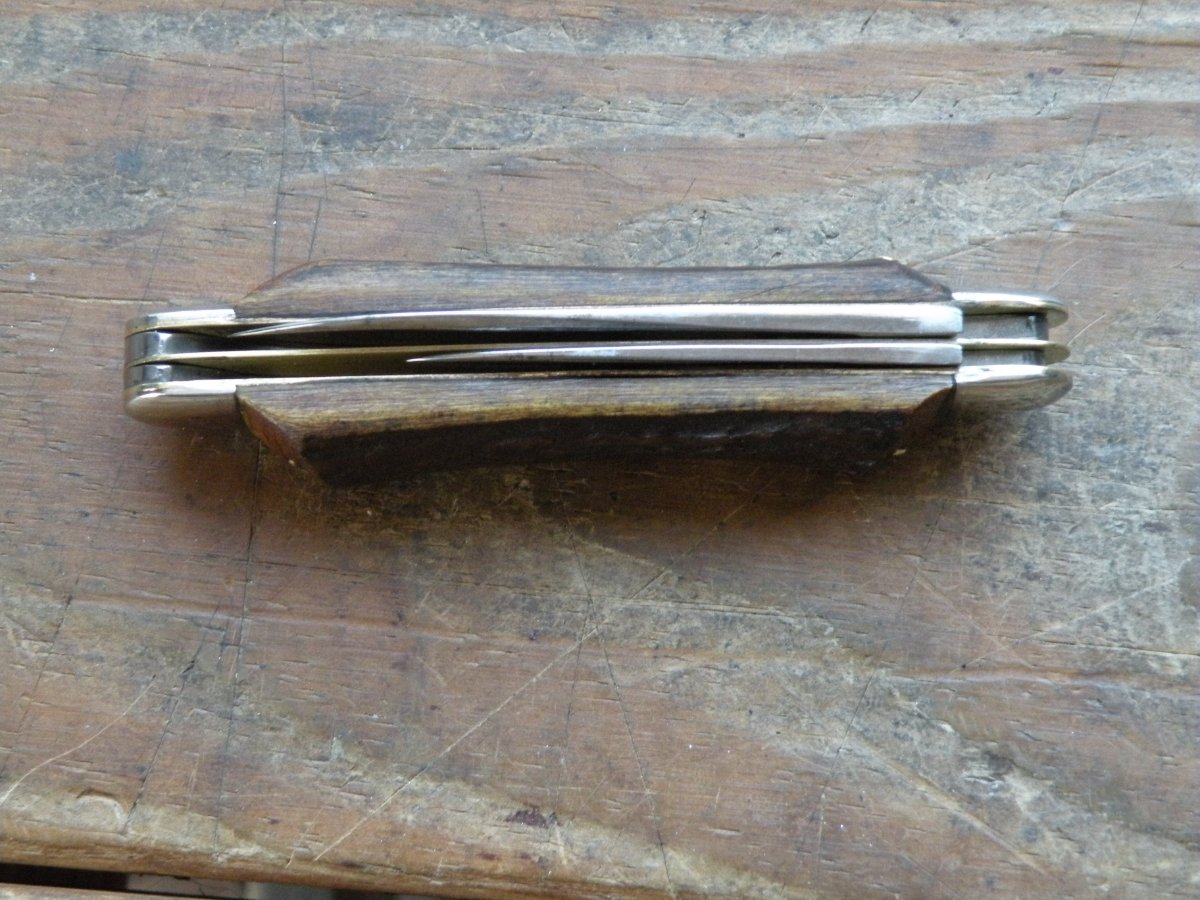

Herb try not dying anything until the scales are on the knife (you may have) Also try thinning the scales a bit more I think you will find better results.
Not trying to tell you how or what to do just giving another angle from a knife guy who also works on them.

I like the dark color. Great job!

herbva wrote: Tue Jan 02, 2024 11:08 pm After reading Reverand's earlier post about using elk antler dog chews for knife scales I had to give it a shot, particularly since I've used up a fair part of my sambar stash. This Remmy 365 came to me in a lot of knives that I won in a recent, large, proxybid knife collection auction. The scales had previously been removed and otherwise the knife showed no signs of ever having been used. Stewart and Ritchie's book on Remington knives indicates that the R365 was made from 1920 to 1940 and only with celluloid scales. I think I may have gotten the dye a bit too dark, but am otherwise happy with my first elk hunting adventure. Thanks for the tip Reverand!
Herb, I think the dark color is very attractive.
I don't much care for the thickness.

I have not tried dying the elk. I typically like the contrast between the dark outer layer and the white inner layer, but yours has me rethinking that!
Elk antler is very close in appearance to Stag in my opinion. I love using it.

I think it looks great, Herb, and the dark color I also find quite attractive.

Magnesium permaginate (spelling?) in solution is a good option to darken elk or bone. Goes on purple and when dry a nice brown, repeat application for darker shade. Stains fingers brown real well too if you don’t take precautions.

BIGHEAD wrote: Wed Jan 03, 2024 2:35 am Herb try not dying anything until the scales are on the knife (you may have) Also try thinning the scales a bit more I think you will find better results.
Thanks for the input BH. I did the dying last, with scales on, after thinning them quite a bit, but I do think I should have taken a bit more off. I'm going to try that, and the potassium permangenate next time. :D

Thought about my post and it may have not been typed the way I intended. What I was saying about thinning and waiting to dye. Is that if the stag is thinner there will be less white on the ends to color as it wont have to be hafted as much therefore making it easier. Is all I was trying to say. Typing stuff down dont always come off as it would in a conversation :shock:

I mix just a small amount (scientific measurements) in a cup with just enough water to stir it around then use my finger to rub it on. Try with a scrap piece first just to see what it does.

I mix potassium permanganate with water until the solution is saturated-you can't get any more to dissolve. You will probably still need multiple applications.
I use a Q-tip. If you use your finger, the finger will be brown for a long time! Latex gloves are handy, because this stuff seems to get everywhere.
You can let the mixture dry out and then re hydrate it as needed.

You could give it a very delicate sanding with a light gauge steel wool to replicate the rubbing effect of a deer to bring out some white. Otherwise beautiful job sir.
