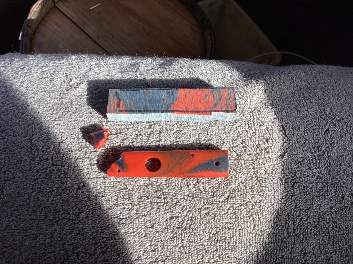

So ya want to repair switchblades?
After hours of work,measuring,drilling,blowing dust out of my hair and other places,I was ready to put it together. This scale was so thick,sanded easier it did not cross my mind it might be prone to cracking. Peening pins is an art I guess. Booooo Hooooooo.

Now that’s funny! Crazy glue went through my head for an instant but I’m sanding another one now. I’ll be more GENTLE this time! I got this handle material in a knife making lot. I don’t know what it is made of,but I’ll be glad when it’s gone. My wife said she liked it so here I am.

Super Glue might turn it into a sticky gooey mess.
Making another piece probably a good idea.

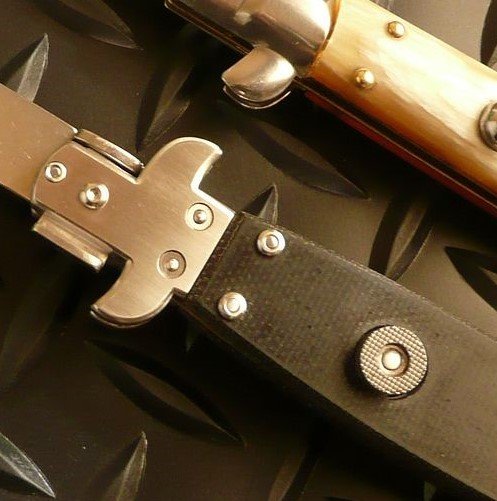

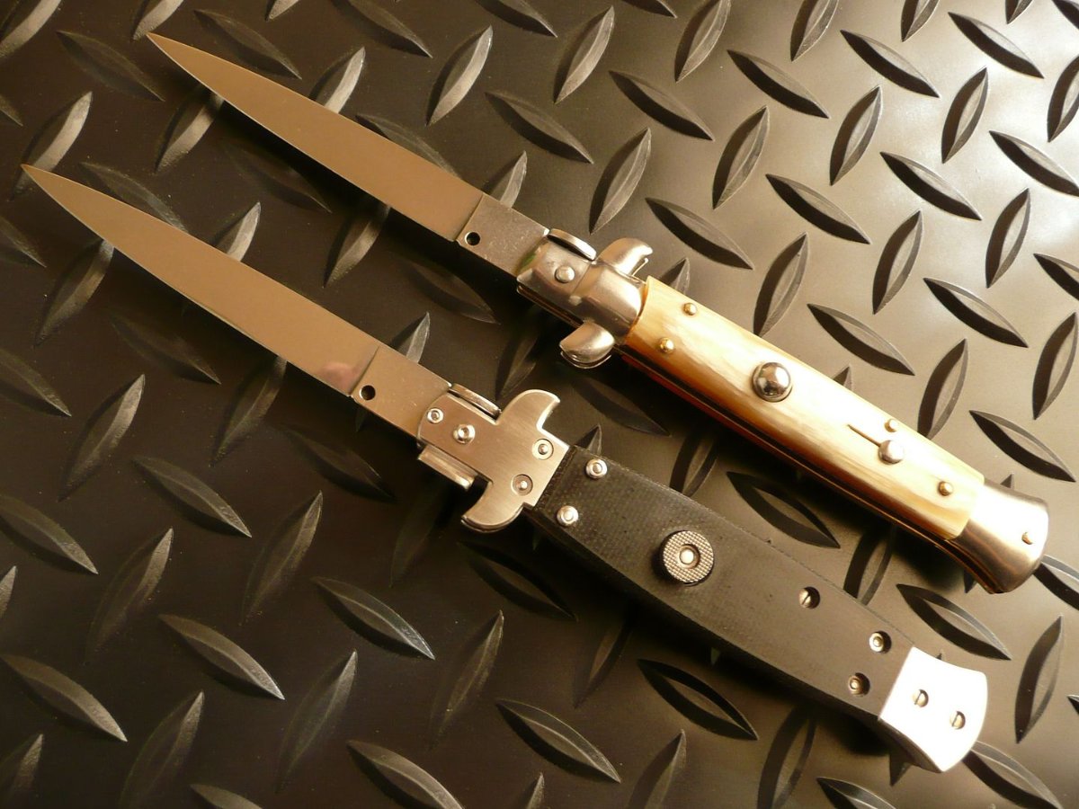

Just one of the reasons I use screws.
The bottom knife in the first picture below was my very first switchblade project. It started out just like the knife above it, a Frank Beltrame 9" swivel bolster "Classic" model. The only original parts in the bottom knife are the blade and spring/lock.
The second pic shows a close-up on the top fasteners for the handle scale. Typically with my builds I run flat-head/V-shaped screws out from the inside surface of the liner, with the heads of the screws countersunk into the liner (requires a special bit). I also typically countersink the nuts to secure the screws in the handle scale and the bolsters, but in this case there wasn't a lot of room around the handle screw holes above the button, so I rounded out (and over) two hex nuts and tightened them down on top of the handle scale, then sanded them smooth.
It's not the "traditional" method, but it saves me from hammering on a knife, and screws allow me to assemble and disassemble a knife as many times as I need, either during fabrication, or to work the bugs out after all the fabrication is done.

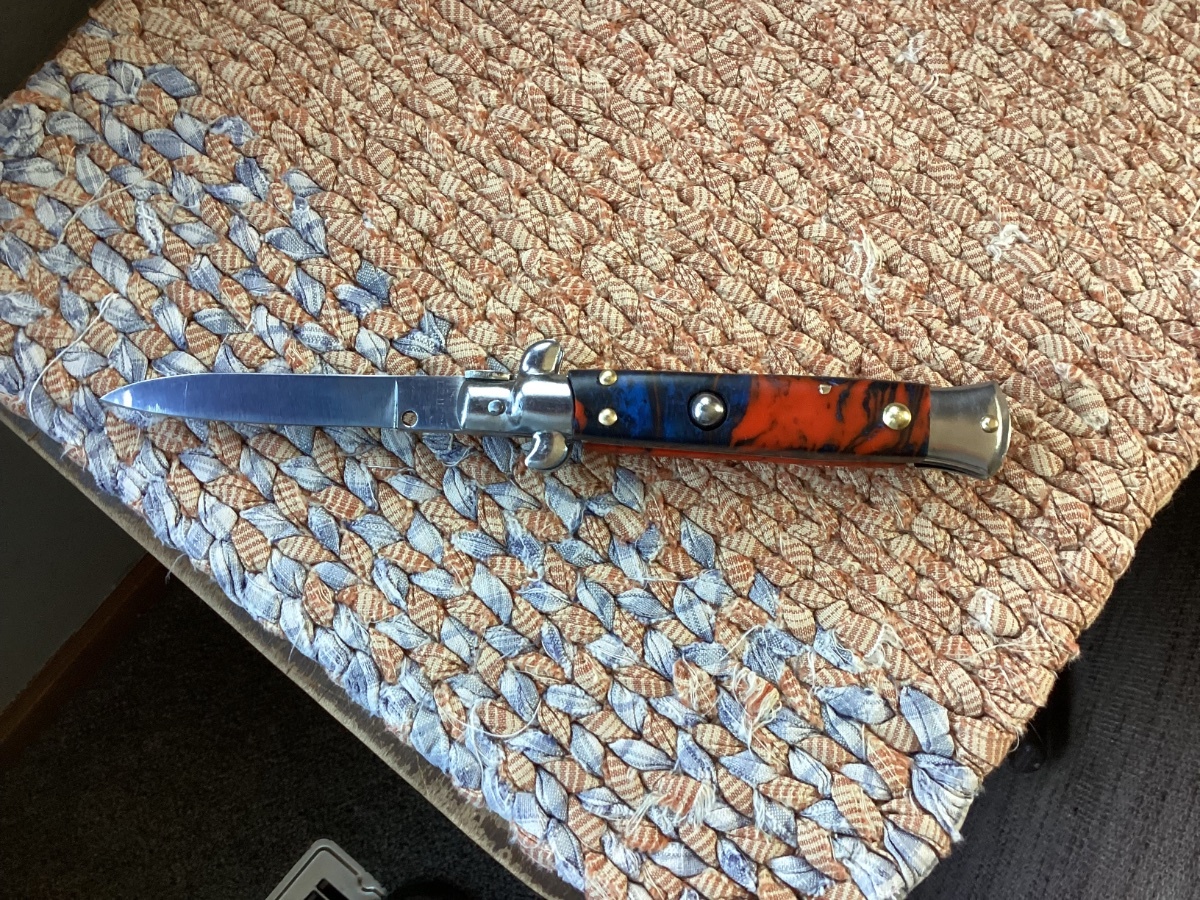

Humor is good. I am still working on this. It’s a bit tight by the swivel bolster. Lucky I peened my pins without checking that. I really wanted to take the pins out and repeen the part I broke before. I’d better take a time out.

With the gray in that scale I might try JB Weld. And of course I have the expert opinion here as I have never once operated on a knife. Ever.

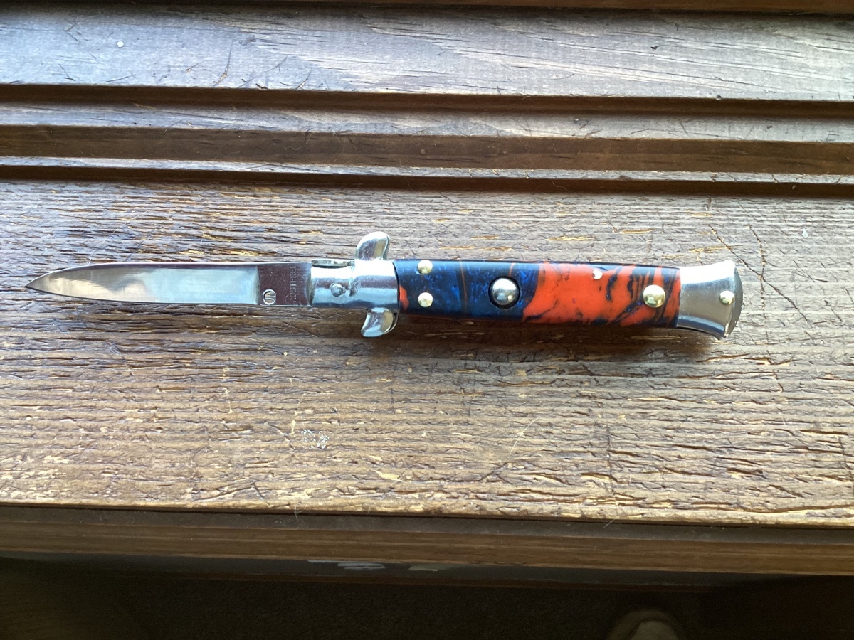

I need to replace one pin with a longer one but it’s for the most part done.( I think) . It had one cracked plastic scale when I got it. Now it’s got some weight and thick scales. And yes! It works great!

Nice job!
I like that scale more than the one that broke, more contrast and variety in the pattern, but that's me. It looks like the surface of another planet.

That's quite a story, Bill, I imagine it took a lot of nerve, no pun intended, to even attempt to work on your own teeth, but with what it costs to visit a dentist nowadays it wouldn't really surprise me to hear more folks at least try a home-fix before shelling out the big bucks.
Your knife came out very well, Smitty, nice job!
I see the big removeable pin that holds the spring in and is right below where the safety usually is, is your knife a copy of the Edge Co. "kit" knives from the 1980's that were sent without the spring installed and the customer installed it upon arrival? That big pin is usually an indication it's one of those.

Yes,I agree. The other side is mostly red. The pin that holds down the kick is a tad too short because I refused to sand more off the scales. I’ve got longer pins on th way and will replace it.

It might be? It had bushings through the scales but I thought,”why”. I replaced them with a 2.8 mm brass pin straight through. It fit perfect. The safety would not work with my thick scales so I tossed it. It’s fine now,no hair trigger or anything like that ..Madmarco wrote: ↑Tue Feb 27, 2024 5:43 pm That's quite a story, Bill, I imagine it took a lot of nerve, no pun intended, to even attempt to work on your own teeth, but with what it costs to visit a dentist nowadays it wouldn't really surprise me to hear more folks at least try a home-fix before shelling out the big bucks.
Your knife came out very well, Smitty, nice job!![]()
