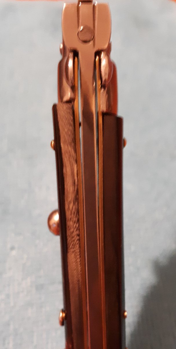

What causes this?
Frank B bayo, fires & locks up fine but its always been like this since I received it. Just wondering if anyone else has had one like it & what caused it?

Re: What causes this?
Are you asking about the uneven bolsters, the poor hafting fit, or the warping of the covers?
the space in between the brass liners is what I'm referring to here. Is it bad, & can (should) it be fixed?
The horn is trying to curl back to its original shape and since the liners are pinned to it it's taking them with it. Kind of a common thing with thick horn handles. They stop at a certain point, probably where they are now. Short of putting on new handles or taking those off and re-sanding them flat (and hoping they stay) there's not much that can be done. Just something that's known to happen. I do sometimes wonder if these guys actually use some horn that's already curling and just bend the liners to it. On many knives the liners stay straight and the horn pulls the pins loose and curls from the liners, but possibly the liners are so thin and the pins so well attached that the liners are easily bent. I really can't say.
Ok I see,that makes sense! I won't sweat it. I just wondered, because out of 3 it's the only one I have that looks like this.
What Eric said is something to think about when buying horn handles.
I have always wanted a horn handled knife. Maybe not so now.
I don't know if I'd consider this a determining factor of a knife you want to have and not get it. As it stands I'm perfectly fine with it, still happy I got it & as I always thought, it"ll be a keeper.
It's not just the horn.
Off-spec parts and poor assembly cause most of this.
Bill, its not like my leverletto for sure. would you think this is able to be fixed? what would you suggest?
If the pin holes don’t align perfectly in the liners and scales,this will happen when the pins are peened tight. Just not put together right. Bill knows.Bill DeShivs wrote: ↑Sat Mar 23, 2024 8:12 pm It's not just the horn.
I'd say send it back to the vendor for a refund. The condition of that knife is unacceptable and should not be tolerated. I can't comprehend how anyone could be "perfectly fine with it". Particularly considering how much they cost.
The loose construction allows the horn to warp.
There is no economically viable repair. A return is in order.
