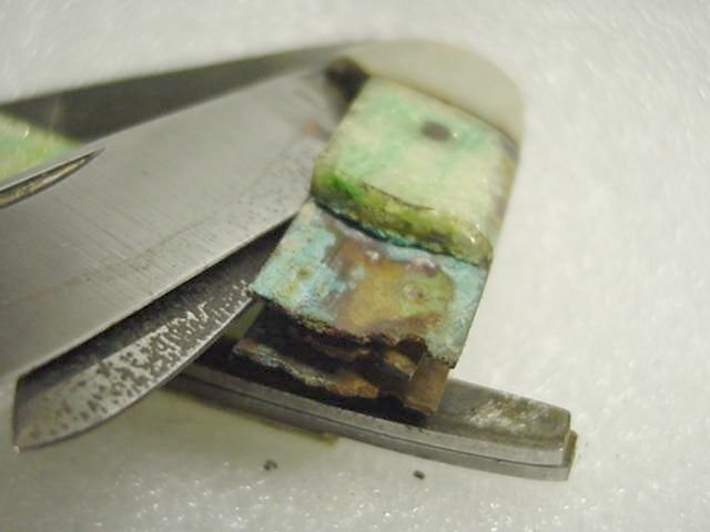

These are pictures of my Fight’n Rooster Waterfall Cannitler, produced between 1984 and 1992. I recently noticed some discoloration on the shield and back bolsters. Then I found pitting on both the pen and sheepsfoot blades. Does this appear to be “outgassing”, and if so, what can be done about it! Will silica gel packs slow or stop the process? Any advice will be greatly appreciated.

Definitely looks like outgassing, and to my knowledge (not an expert by any means) there is no stopping it. Do not store it around other knives and open air is better than in a box it seems like. Best thing to do in my opinion is to remove the covers and get it recovered by one of the knife mechanics on the forum here.

Definitely outgassing.
C-Wade7 is 100% correct.

Yes, that is an early sign of outgassing. Once it begins I know of no method to stop it, short of removing the offending covers. Fight’n Roosters and other German-made knives of the past 30-40 years are notorious for outgassing.
Whether they’re worse than older knives from other makers, I couldn’t say. It’s possible we just notice them more because most are in someone’s collection. Whereas a lot of the older ones just self-destructed and no one noticed, or were “used up” and disposed of by their owners. I’ve read the average lifespan of an EDC pocket knife pre-1960’s was around 3 to 4 years. (How they determined that I have no idea, but I wouldn’t argue with it. At that time they were mostly just simple inexpensive tools.)

I googled "Sublimation of celliuloid" and found a very good article from the JAIC (Journal of the American Institute of Conservation). If you have a minimum of chemistry background it will help but reading the whole thing is self explanatory. The URL is: cool.culturalheritage.org/jaic/articles/jaic30-02-003.html
The section on prevention and collection maintenance is informative. Sadly the conclusion is, the sublimation ,(going from a solid directly to a gas, also called,"outgassing"), cannot be prevented or stopped, only retarded to the degree established by the relative amounts of camphor, nitrates, acids, alcohol, and proprietary chemicals in the original manufacture. Some are more or less stable than others.

Thanks to all who replied. I was afraid of the answer, but not surprised. Any recommendations for AAPK knife mechanics?

Again, thanks to everyone for sharing their knowledge and recommendations. I was able to remove the scales, with one broken pin. Was surprised how bad the liners looked, but after a little work it seems to be “surface damage. Now to decide if I want to tackle an amateur rehandle, or pay someone to do it right. You live and learn. Gonna have to give my two “end of day” Roosters a closer look.

Here's my knife, let yours go too long and it will look like this one

I believe (HOPE)Miller Bro's wrote: ↑Sat May 18, 2024 9:14 pm Here's my knife, let yours go too long and it will look like this one![]()
I caught mine in time to prevent any further damage.
