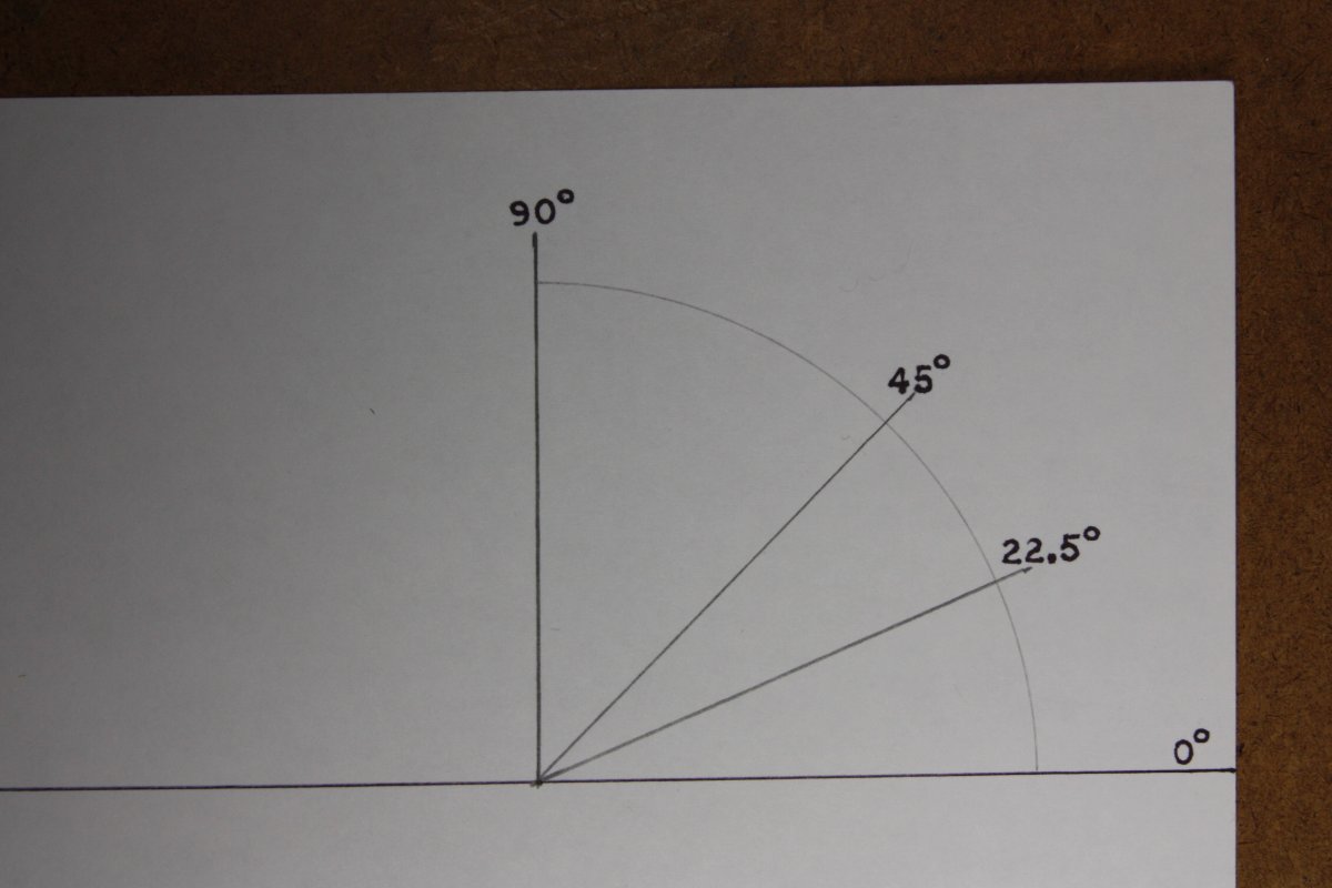

As an aid to getting a consistent angle, I think of it as in the diagram below. The line at bottom is the surface of the sharpening stone. Put the knife with the cutting edge square to the stone, then tilt the blade over to divide this angle in half. That will be 45 degrees. Then take that angle and tilt the blade further to divide that angle in half. That is 22 and 1/2 degrees. That is what I use for all around blades that I sharpen on a stone, and seems to work for me. One can also cut out a diagram like this to make a gauge for any angle desired and use until your eye has become "calibrated".

Very helpful OC.OLDE CUTLER wrote: ↑Sat Feb 01, 2025 2:40 pm As an aid to getting a consistent angle, I think of it as in the diagram below. The line at bottom is the surface of the sharpening stone. Put the knife with the cutting edge square to the stone, then tilt the blade over to divide this angle in half. That will be 45 degrees. Then take that angle and tilt the blade further to divide that angle in half. That is 22 and 1/2 degrees. That is what I use for all around blades that I sharpen on a stone, and seems to work for me. One can also cut out a diagram like this to make a gauge for any angle desired and use until your eye has become "calibrated".
