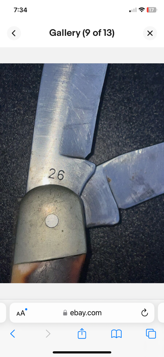

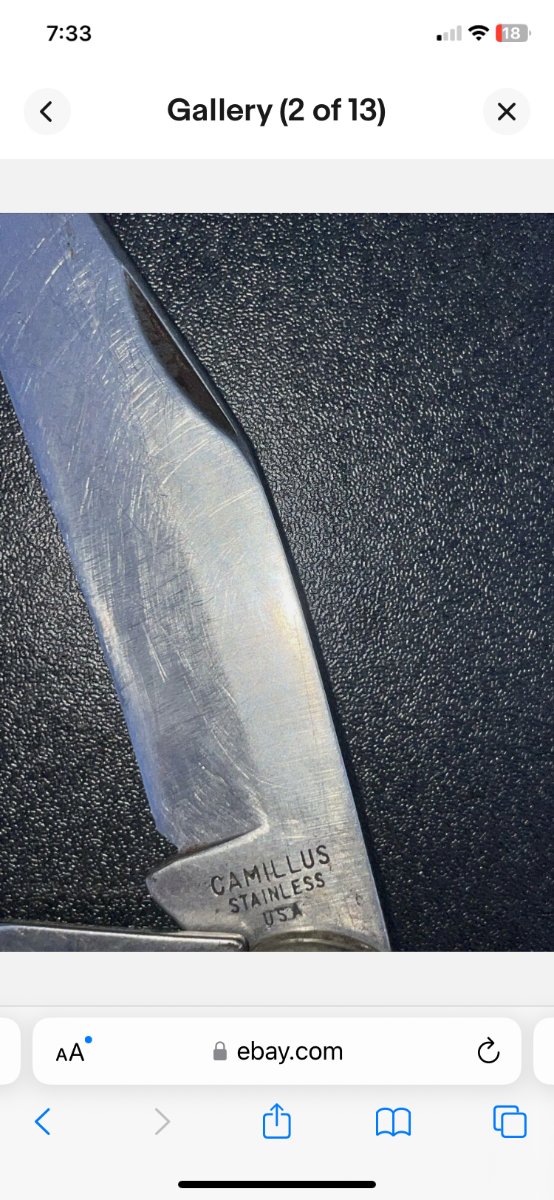

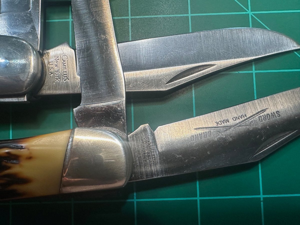

I have a 26 folding hunter, tang stamp on larger blade reads
CAMILLUS
STAINLESS
USA
Stamped on opposite side on smaller blade is 26
3 lines, no sword brand engraving. Can anyone date it?

Without good pictures of the tang stamp we could not give any accurate information. The font, the presence and/or length of a dividing line, all make a huge difference.
Here is a link to a thread dedicated to pictures of Tang Stamps that will help you identify your knife.
https://www.allaboutpocketknives.com/kn ... hp?t=39799
Please post pictures of the whole knife, including that tang stamp. Not only can we then help, but we love to look at pocket knives!!

Dude68
Posts: 9
Joined: Tue Sep 10, 2024 2:01 pm
Re: Tang stamp
Post by Dude68 »
Dude68
Posts: 9
Re: Tang stamp
Post by Dude68 »
I have never seen this stamp before, I am not able to locate it on any of the charts. I
Joey
Posts: 21426
Re: Tang stamp
That tang stamp is common but usually on the old #5 fish knives and knives meant to be used around water. I wonder if the blade has been replaced. But with Camillus there is always a mystery showing up. ::shrug::

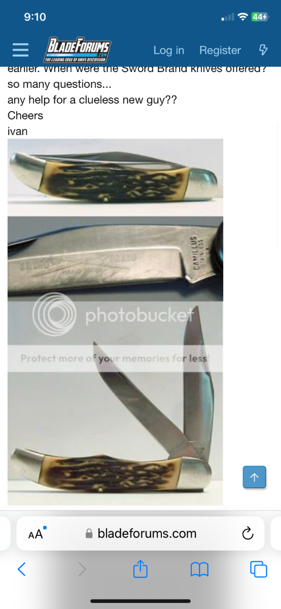

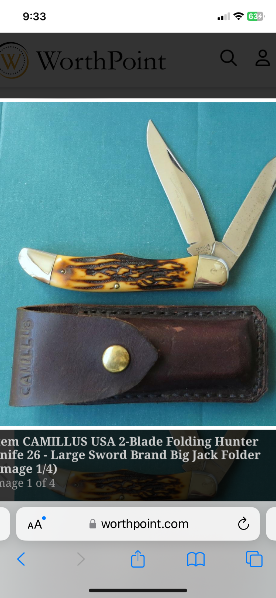

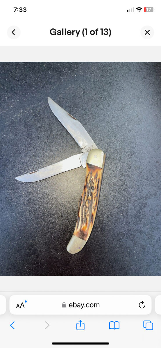

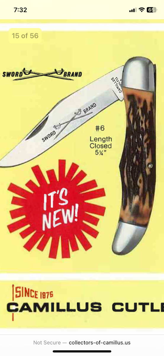

I’ve been researching this online this morning. I have found a couple of #26 folding hunters with the same stamp. I have seen pics of the modrl 26 as a sword brand a few times. Here is a pic of another 26 with the same stamp.
And another

Check out Camillus catalogs on the Camillus collectors r us website . Should find it in the 1970s thru about 2000 year catalogs . There was a whole series of different models with that style of synthetic jigged handles.
Nice folding hunter .

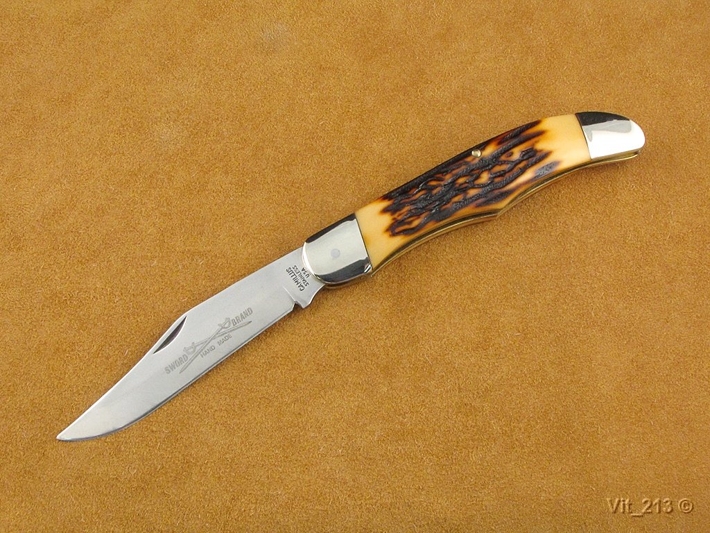

Thanks. I looked at the catalogue and noticed the first appearance of the model 26 big jack is in the 73-4 catalogue as a sword brand knife. I saw a tang stamp matching mine in the 1976 catalogue on a model 6 single blade huntsman. The big jack and huntsman are referred to as folding hunters in later catalogues. This is the first year I noticed this tang stamp. Of note, I counted four different tang stamps in the 76 catalogue. Every catalogue shows this 2 bladed folding hunter or “big jack” as a sword brand knife with sword brand etched in the main blade. Here is a pic of the 76 huntsman

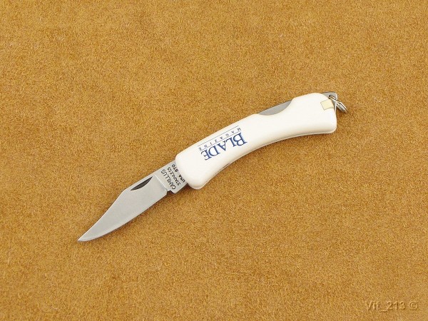

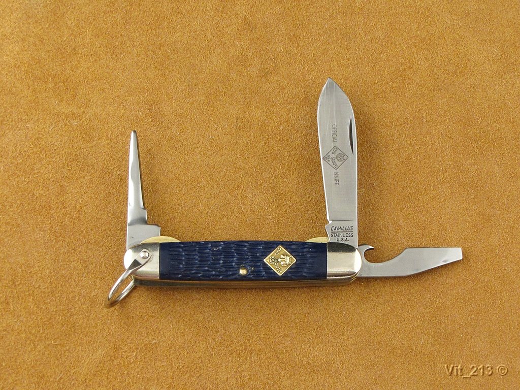

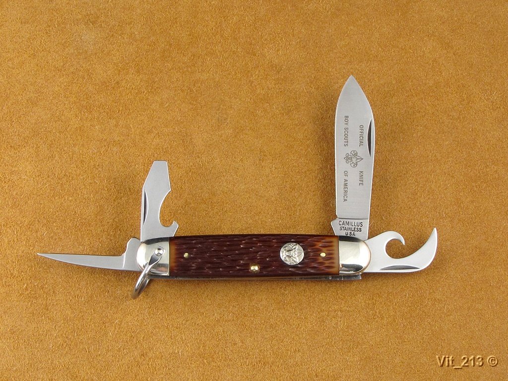

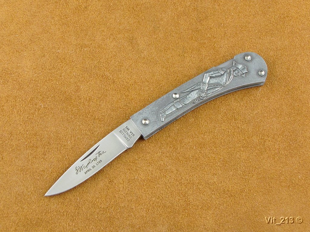

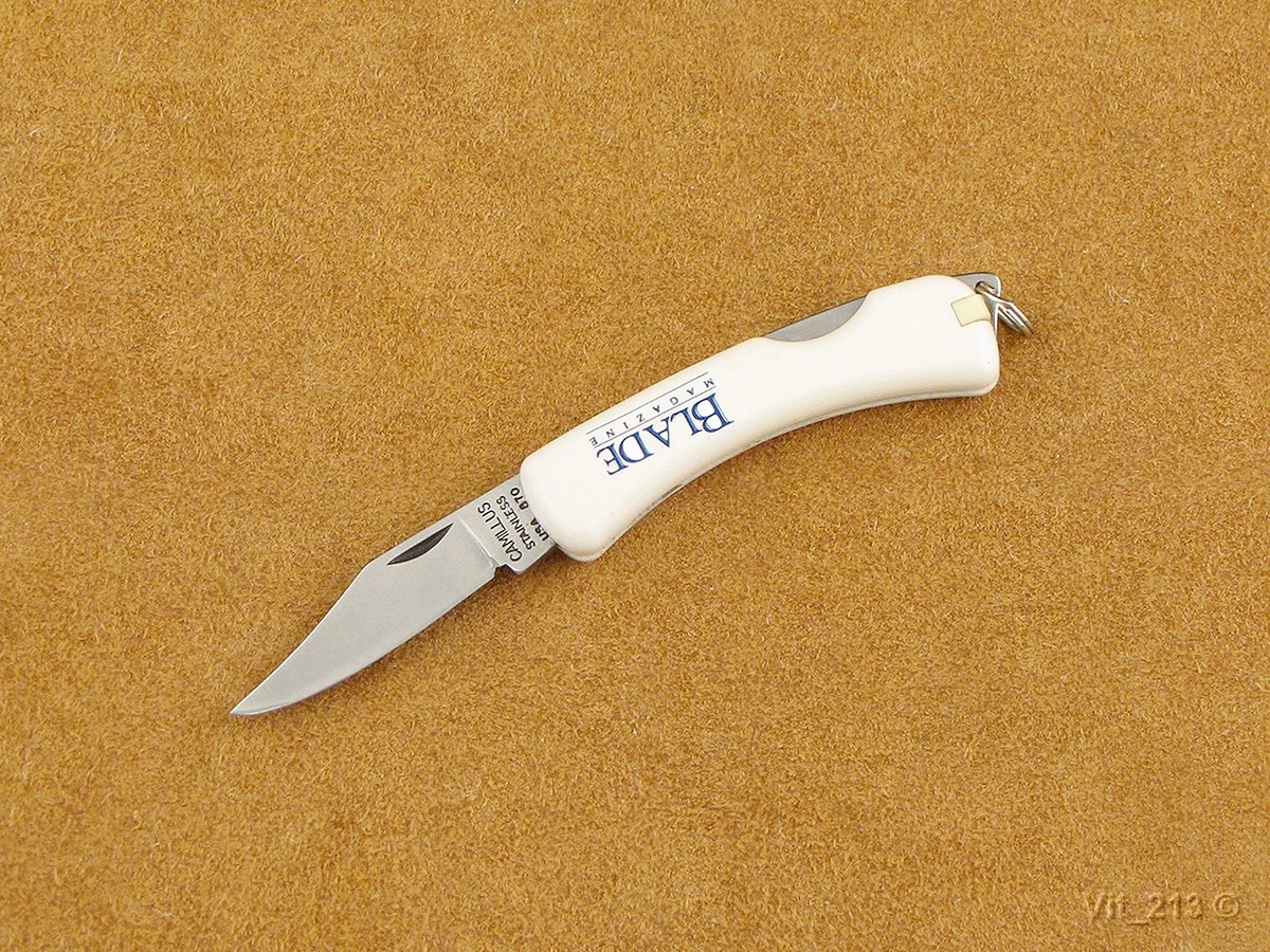

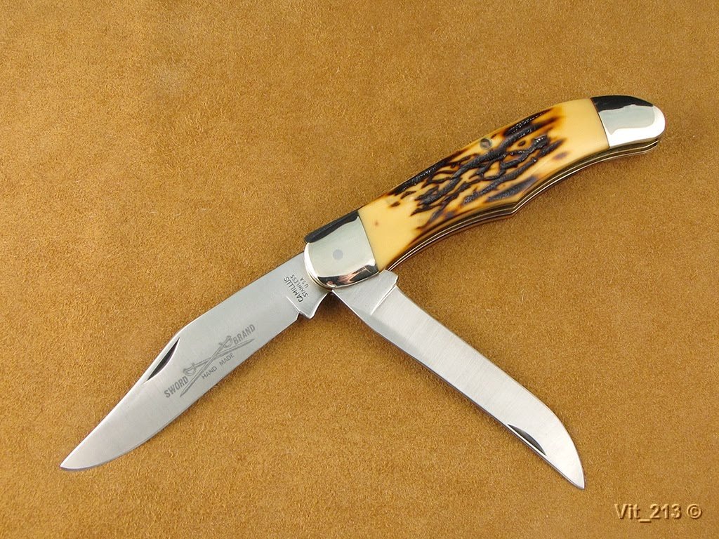

Model #26 was produced from about 1972 (maybe a little earlier) until the plant closed. The first samples were made of carbon steel. Somewhere around 1973-1974, carbon steel was replaced with stainless steel. At that time, Camillus made few knives from stainless steel, and a special tang stamp was introduced for them. During the 70-80s, this tang stamp received several varieties for different models. In 1989, there was a rebranding and the tang stamp became the same for all models (almost).
Below are some examples of knives with "Stainless" tang stamps.

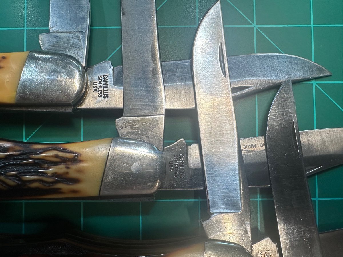

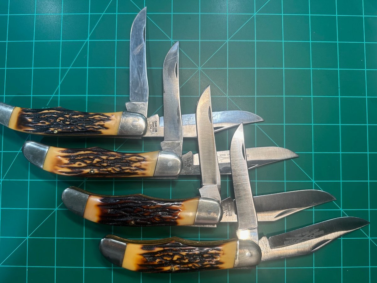

I currently have three #26’s. And a 4th coming in from the bay. 3 of them are the 3-line stainless stamps and the 4th is not. It looks like carbon steel due to the pitina. I’m guessing the 4th is pre-1973/74. The others could be up to 2006 then. I’d take pics but I’m traveling all week. I’ll try to remember to upload pics next weekend.
"cogito ergo armatum sum"
BigAl62
Posts: 30
Joined: Tue May 07, 2024 2:52 pm
Location: Northwest Arkansas
Re: Tang stamp
Post by BigAl62 »
BigAl62 wrote: Mon Feb 10, 2025 1:01 am I currently have three #26’s. And a 4th coming in from the bay. 3 of them are the 3-line stainless stamps and the 4th is not. It looks like carbon steel due to the pitina. I’m guessing the 4th is pre-1973/74. The others could be up to 2006 then. I’d take pics but I’m traveling all week. I’ll try to remember to upload pics next weekend.
I finally remembered to upload the pics. . .
