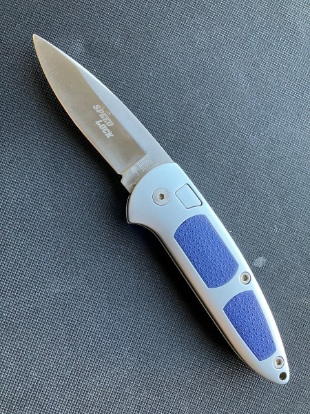

I just got this Boker Solingen speed Lock II in a group of knives. From what I saw on line - seem these were made as auctomatic knives? Just wondering if that is true. This one does not spring open. Also, if it was made as an auto, why is there a nail nick? Any help appreciated.

I remember when these first came out , I bought several at gun shows and yes every one I owned were an automatic switchblade knife .
The laminate scales are horribly known for coming loose .
I don’t remember about the nail nick .

Thanks - yes the scales are pulling away.ScoutKnives wrote: ↑Sat Feb 01, 2025 10:33 pm I remember when these first came out , I bought several at gun shows and yes every one I owned were an automatic switchblade knife .

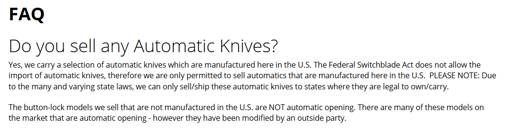

My memory is a little fuzzy, but I seem to recall that there was a time when Boker made two versions of some of their knives, auto versions, and manual versions. Since it has been illegal to import switchblades into the US since 1958, Boker made automatic versions for sale outside the US, and the version they sent to the US had no springs installed, making them manual, and thus requiring the nail-nick.
Whether or not the manuals they sent to the US had cavities drilled out for the springs I can't recall. It's possible that the Boker autos with nail-nicks were converted (spring cavities drilled) after ariving in the US. This would not have been a difficult procedure for a skilled craftsman.
At some point however, Boker started making autos in Denver, USA. So that's how you can now buy Boker switchblades in the US.

FAQ from Boker USA-

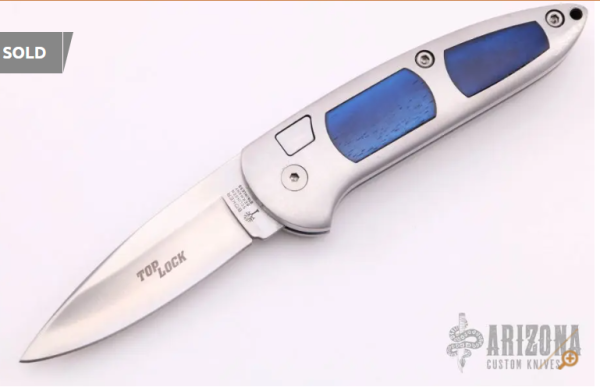

Here is one I own, I think its a slightly different size from the OP knife (maybe explaining the "Speed Lock II"), but all of the "Speed Lock" knives I've seen were auto's the "Top Lock" knives were manual open. This one is definitely an auto and there is no nail nick.

I'm inclined to believe that msteele6 is correct, that the Top Locks are the manual version, and the Speed Locks are the auto version.
What's confusing though is that there are Top Locks with no nail nicks (pics below), and Speed Locks with nail nicks (I found several).
I could understand putting nail nicks on autos for the reason Madmarco gave (in case the spring broke), or, if someone wanted to simply remove the spring and make it a manual. But I don't understand why Boker would choose to not put nail nicks on some manual Top Lock knives. Oh well, it's a mystery to me.
