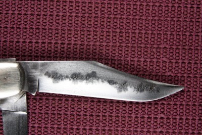

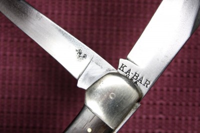

I agree, there is no way to fill rust pits. Only remove metal around them to make them "go away". Is the knife as bad as this KABAR folding hunter that I picked up at a flea market for $1 because the seller thought it was useless junk? I rehandled it with rosewood and it is one of my favorite folding hunters to carry and use. The pits have no effect on performance.

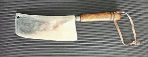

Here is a cleaver that I've been trying to clean up. That blade had more rust and pitting than fleas on a hound dog and all I knew to do was start with a sonic bath, then an eraser and then to the sander with progressively higher grit. I finished with a 7K grit on the Dremel and then some polish. The surface of the blade is still not smooth but that would have required too much metal removed. I then put on a new wood handle. I probably did everything wrong on this one but it's not as if I'm going to be cutting up steaks for dinner tonight with it. That's my story and I'm sticking with it.... :D

dlr110 wrote: Sat May 03, 2025 3:52 pm Here is a cleaver that I've been trying to clean up. That blade had more rust and pitting than fleas on a hound dog and all I knew to do was start with a sonic bath, then an eraser and then to the sander with progressively higher grit. I finished with a 7K grit on the Dremel and then some polish. The surface of the blade is still not smooth but that would have required too much metal removed. I then put on a new wood handle. I probably did everything wrong on this one but it's not as if I'm going to be cutting up steaks for dinner tonight with it. That's my story and I'm sticking with it.... :D
BEFORE
AFTER
Looks pretty nice from here!

Great work.
