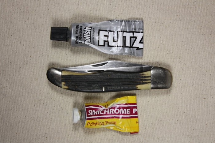

Handle cover is looks dried out also lower bolster was really tarnished Other side is ok. Any ideas on restoring this cover.
OLDE CUTLER
Posts: 5016
Location: South Dakota
Re: 39 Queen
Post by OLDE CUTLER »
Here is what I use on mine. Seems to work good.
stockman
Posts: 3925
Re: 39 Queen
Post by stockman »
Thanks Will try that. Harold
edge213
Posts: 8170
Re: 39 Queen
Post by edge213 »
stockman wrote: Fri Jun 20, 2025 12:53 pm Handle cover is looks dried out also lower bolster was really tarnished Other side is ok. Any ideas on restoring this cover.
Looks like delrin in the picture.
If delrin rub with 3 in 1 oil, let set awhile, wipe off then Ren Wax.
If bone rub with mineral oil, let set awhile, wipe off then Ren Wax.

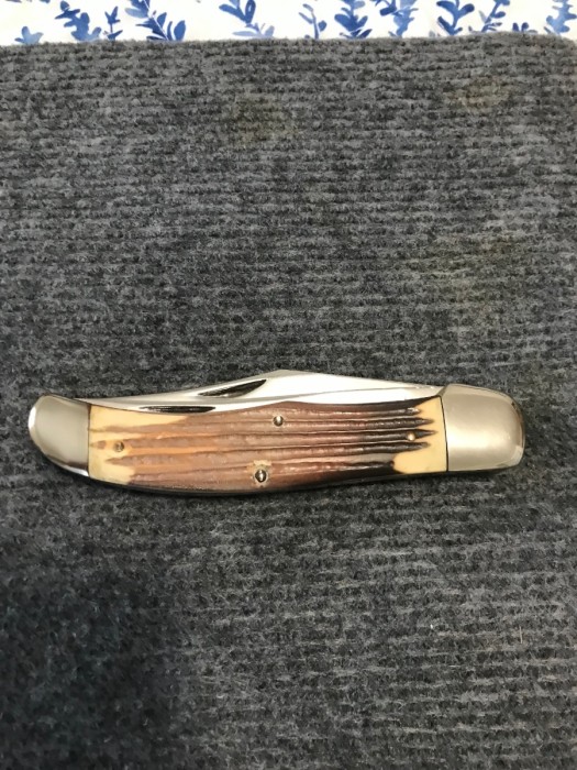

Bought this knife, no tang stamp. It is blade etched. I did not find it in the Queen information section. I’m curious about age.
QTCut5
Posts: 6643
Location: Napo'opo'o, HI
Re: 39 Queen
Post by QTCut5 »
1961-1971 no tang stamp was used
~Q~
stockman
Posts: 3925
Re: 39 Queen
Post by stockman »
Thanks QT, I did find that info that you sent. For some reason I didn’t relate it to my knife. Thought mine was newer than 61-71. Harold
