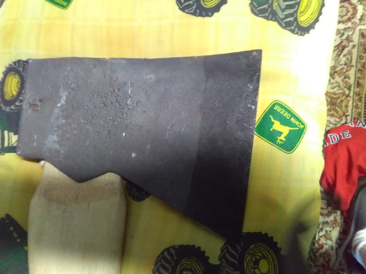

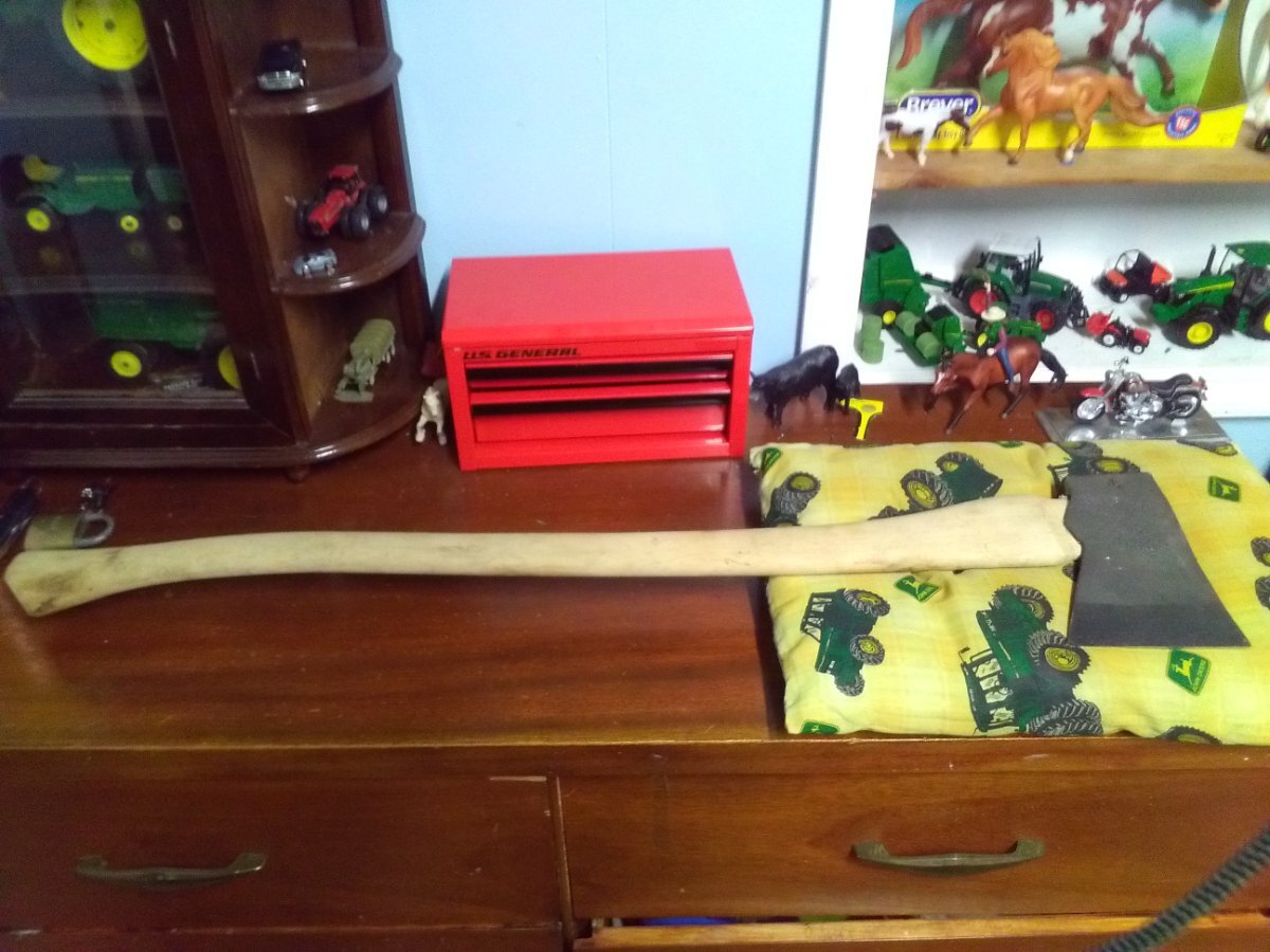

Older 3.5 pound Council with a new handle. Thus sucker has been on the back burner since my teens. I found it as a part of a pretty sizeable pile of axes on a property we leased at the time.
Last month, I took it off the back burner, after the handle sat around a couple years and I had no idea where it went and then I found it cleaning out my shop. It got dunked in Evaporust, which removed a healthy layer of rust off it. I fitted the handle this week.
I followed Council's suggestions to taking the old handle stub out. I drilled a bunch of holes, then hit what was left with a punch (several times). Council apparently used really good wood for the handles and may have glued it in also. Ended up having to put a gasket scraper (the Wilde-made one from Wally World) between handle and head and chisel the old handle out by hitting it with a hammer.
Some strange ptting petterns. Deep, but hopefully not bad enough to weaken the integrity.
The pattern on the mark side is a little strange. I don't know if it was from rain, or perhaps a shotgun?

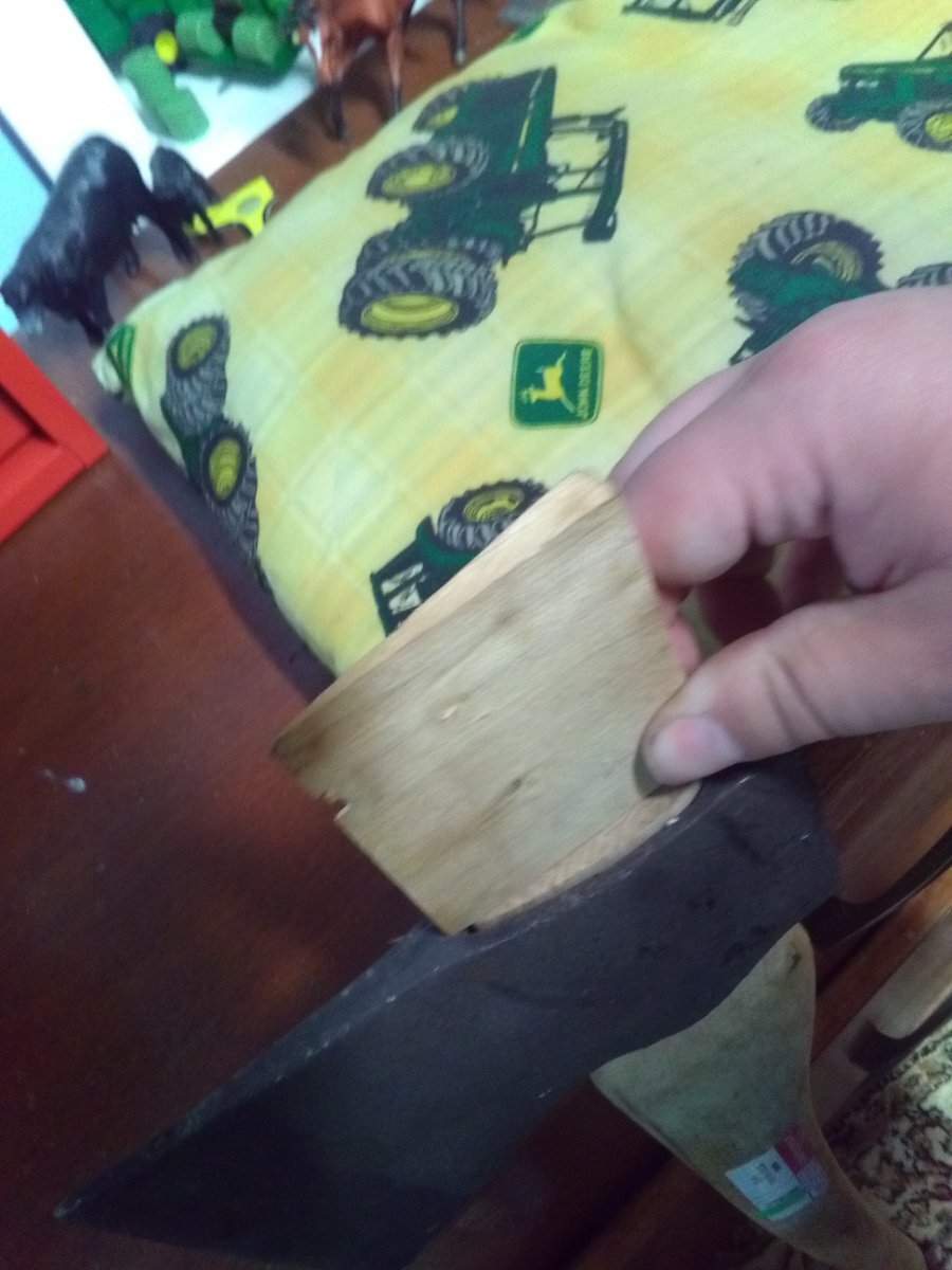

To do:
Install wood wedge (maybe a couple steel ones too). The wedge is longer than the handle if I put it in flat side up like most handles. Bowman Handle apparently shows it being put in like most, so they may have included the wrong wedge here.

Once I'm done, I think I'll have the best felling/fence on tree removal axe I've got. My next-largest axes are basically boy's axe patterns, so 3.5 vs. 2-2.5 lb. coupled with a three-foot long handle should mean it will be much more efficient than hatchets or boy's axes. It will be replacing a 1KG Stihl (Ochsenkopf) in the UTV.
