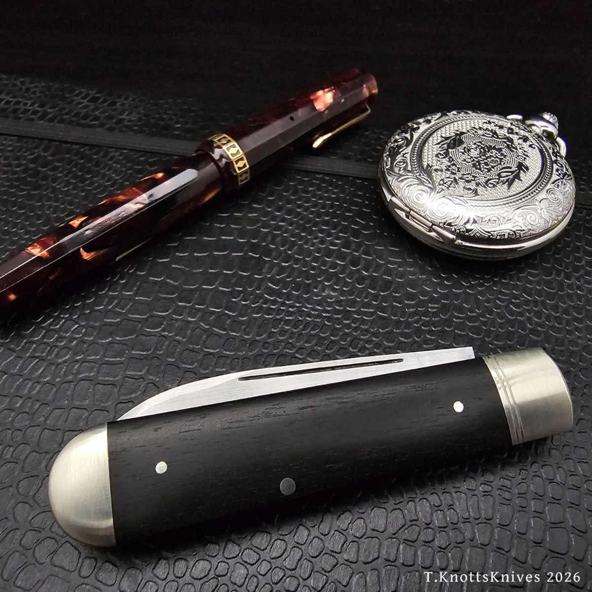

Hello all and thanks for looking.
Finished this one up this week. I really like silver and black together. I decided not to go with a shield here as I thought simple looked so much more classy on this one...what are your thoughts?
Spear Point slip joint in O1 with Ebony covers.
Nickel silver bolsters, pins and coin edged liners
The pull on this is what I consider medium, it has nice walk and talk and can be pinched open (video here: https://youtu.be/djl5eMTPb4Y?si=EKbIOFXn5ueA5PHE), half stop, spring lays flat in all 3 positions.
Tip is centered. Blade hand sanded to 600 grit finish.
OAL: 6"
Closed 3.45"
Cutting Edge: 2.25"
(Questions, comments and feedback welcome.)
OAL: 6"
Closed 3.45"
Cutting Edge: 2.25"

Very classy indeedtknottsknives wrote: ↑Fri Jan 23, 2026 2:33 pm I decided not to go with a shield here as I thought simple looked so much more classy on this one...what are your thoughts?

A really good looking knife, Tim.
Nice large, lined bolster at the pivot.
Love that spear, long pull, equal end, and the Ebony.
Half stop! I have no doubt the mechanics are "Fine".

Thank you. I have to remind myself to not always do the same thing. I had a shield (diamond) for it and it looked really good mocked up but when I took it off, it just looked like it was supposed to be bare.QTCut5 wrote: ↑Fri Jan 23, 2026 3:50 pmVery classy indeedtknottsknives wrote: ↑Fri Jan 23, 2026 2:33 pm I decided not to go with a shield here as I thought simple looked so much more classy on this one...what are your thoughts?Normally, I like a nice shield, but I agree the simple, no-shield look is cleaner and lends this knife a sense of understated elegance. The coined liners provide the perfect amount of embellishment

Thank you Sir, this was the first time using Ebony and I really liked it. It worked a lot like Blackwood but didn't smell as good lol. Besides the barlow, this is my favorite pattern. I usually like it with an easy open and shield but I wanted to change things up a little.

Going over your pictures again I'm wondering if the knife is an equal end.
The lens can distort. Maybe a sleeveboard?

Not quite equal but it's close. The butt end does swell some. Educate me on this...I always thought a sleeveboard had the wider end at the pivot and a swell end jack had the butt end a little wider...but I am not close to an expert on patterns. I kind of make what I like and it usually comes out looking like something LOL

I think your understanding its correct, Tim.tknottsknives wrote: ↑Fri Jan 23, 2026 10:00 pm Educate me on this...I always thought a sleeveboard had the wider end at the pivot and a swell end jack had the butt end a little wider.
