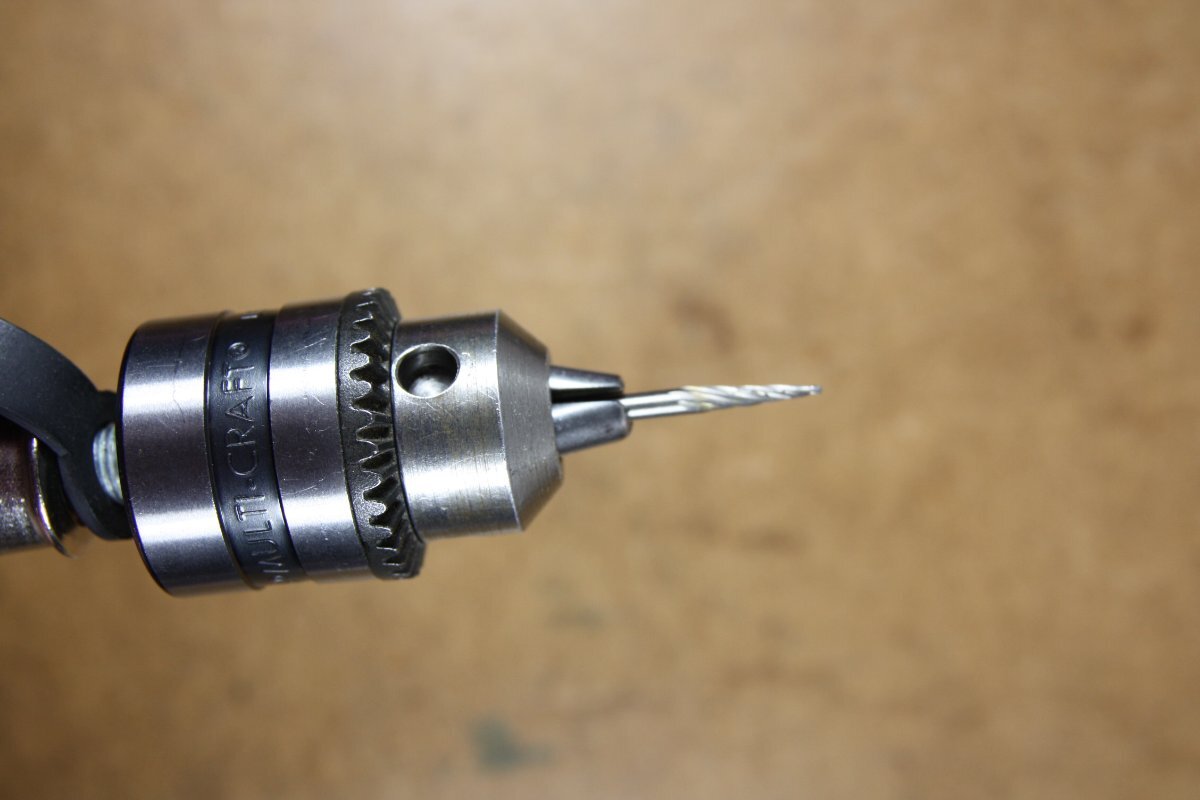

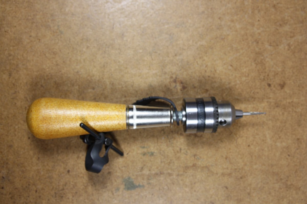

That’s not a lot of cutting . Do you actually power cut the chamfer or do you chuck the bit into a tap handle or similar tool and manually work the chamfer?
Froe
OLDE CUTLER
Posts: 5673
Location: South Dakota
Re: Chamfer questions
Post by OLDE CUTLER »
Froe wrote: Tue Mar 10, 2026 3:01 am
Reverand wrote: Tue Mar 10, 2026 2:06 am I got a set of diamond-coated bits for the Dremel. I use either a cone bit or a ball burr.
For handle/pivot pin, you only need about 10 to 15 thousandth over. I might make the chamfer a bit bigger on the pivot pins.
Thanks for replying Rev.
My tool for this. The bit is a tapered Dremel reamer turned by hand, a file handle with a bolt with the head cut off and a spare drill chuck. If you try to power cut and the bit chatters, you have ruined the knife.
Froe
Posts: 638
Joined: Tue Feb 14, 2017 3:31 am
Location: Independence KY
Post by Froe »
OLDE CUTLER wrote: Tue Mar 10, 2026 11:15 am
Thanks OC. So are you taking the chamfer cut shallow just around 1/64” deep or are you keeping it narrow but deeper? I really like that reamer tool, that’s clever. I think I have the parts for that.
